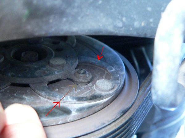

See attachment for a photo from another post that I edited. The red arrows show where I inserted the plastic shims. Note that this is not likely to be a permanent fix. I removed all of my old shims this past weekend, and had to insert new, thicker shims in order to get the gap down around 0.2mm.
My best guess is that the flat metal rings are deforming over time due to pressure from the plate and shims. either that, or the plastic shims are melting/compressing under the heat. (Although the old shims didn't show any signs of this).
