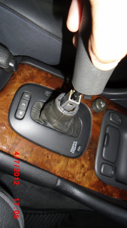

Here are some additional pictures to supplement existing replies. The iPd kit comes with color instructions and a spring. 8)
Pull up with two hands hard! It comes off since there are no screws or bolts.
CIMG1740 (448x800).jpg (220.2 KiB) Viewed 3328 times

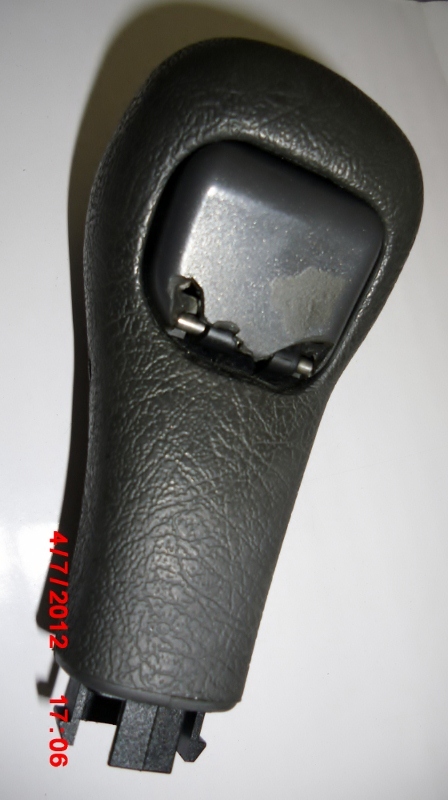

Broken bottom of the shift knob button.
CIMG1741 (448x800).jpg (188.42 KiB) Viewed 3328 times

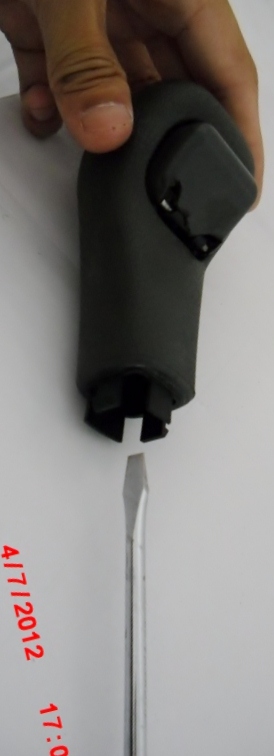

Stick the screwdriver straight in to release.
CIMG1742 (448x800).jpg (102.24 KiB) Viewed 3328 times

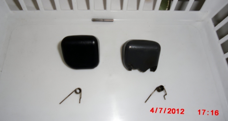

New shift knob button on left, broken on right.
CIMG1748 (800x448).jpg (124.49 KiB) Viewed 3328 times
