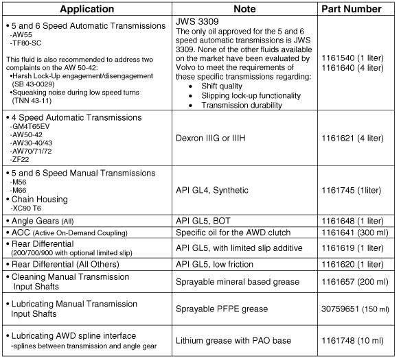

Volvo reccommends JWS 3309 - The Volvo fluid spec chart is attached.
If Mobil 3309 is the factory fill I would avoid it based on the shifting complaints and long term performance as reported by many here.
I would recommed a synthetic over a non synth for shifting, protection and lifespan. I have used them both and the synthetic is far superior.
If you chose Amsoil it does meet JWS 3309 spec - I use it in my personal Volvo and in my customers. No issues - only compliments.

- VolvoFluidSpecs.GIF (34.09 KiB) Viewed 4640 times
