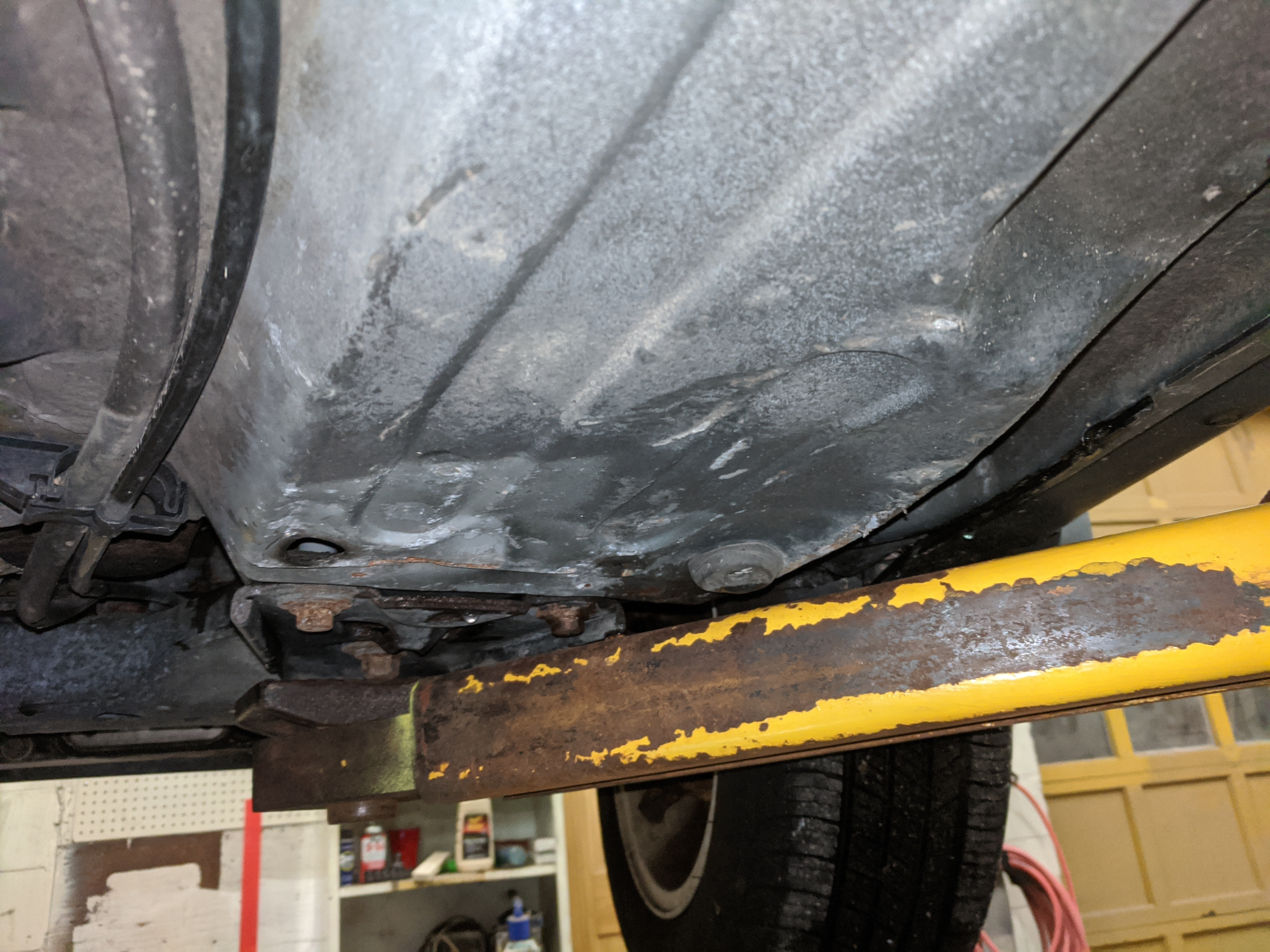

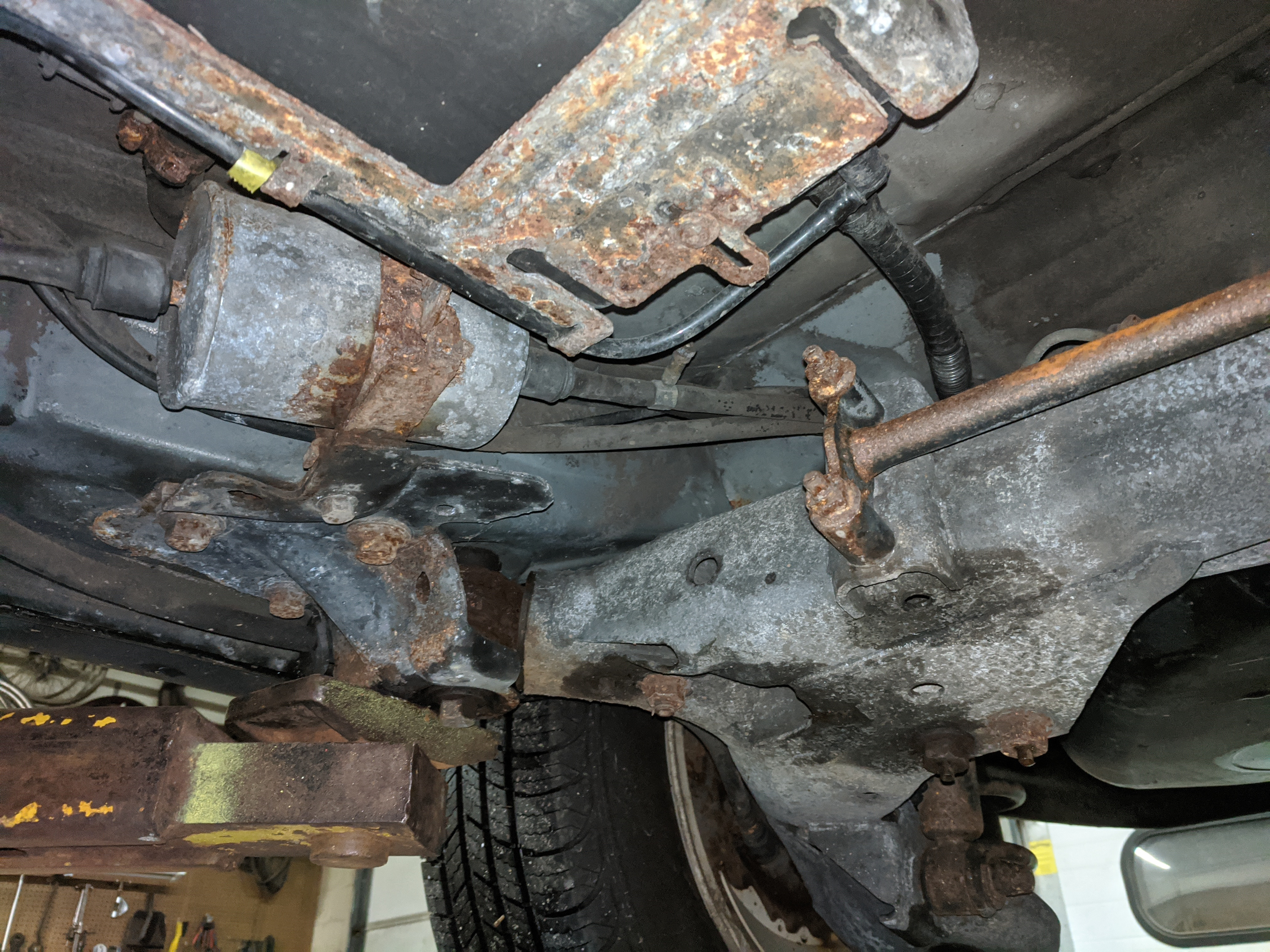

I'd like to follow up on the original poster's question. I plan to replace my front and rear shocks and springs, but I'm using an automotive lift which lifts the car from four points at once. The lift points I use are suspension components (or near them) and may need to be removed during the job. What other points could I use with an automotive lift during this work?
The attached pictures show the points I use. Don't worry, for the front point, I now center the pad on the half-circle raised area farther back from what's shown in the picture.
