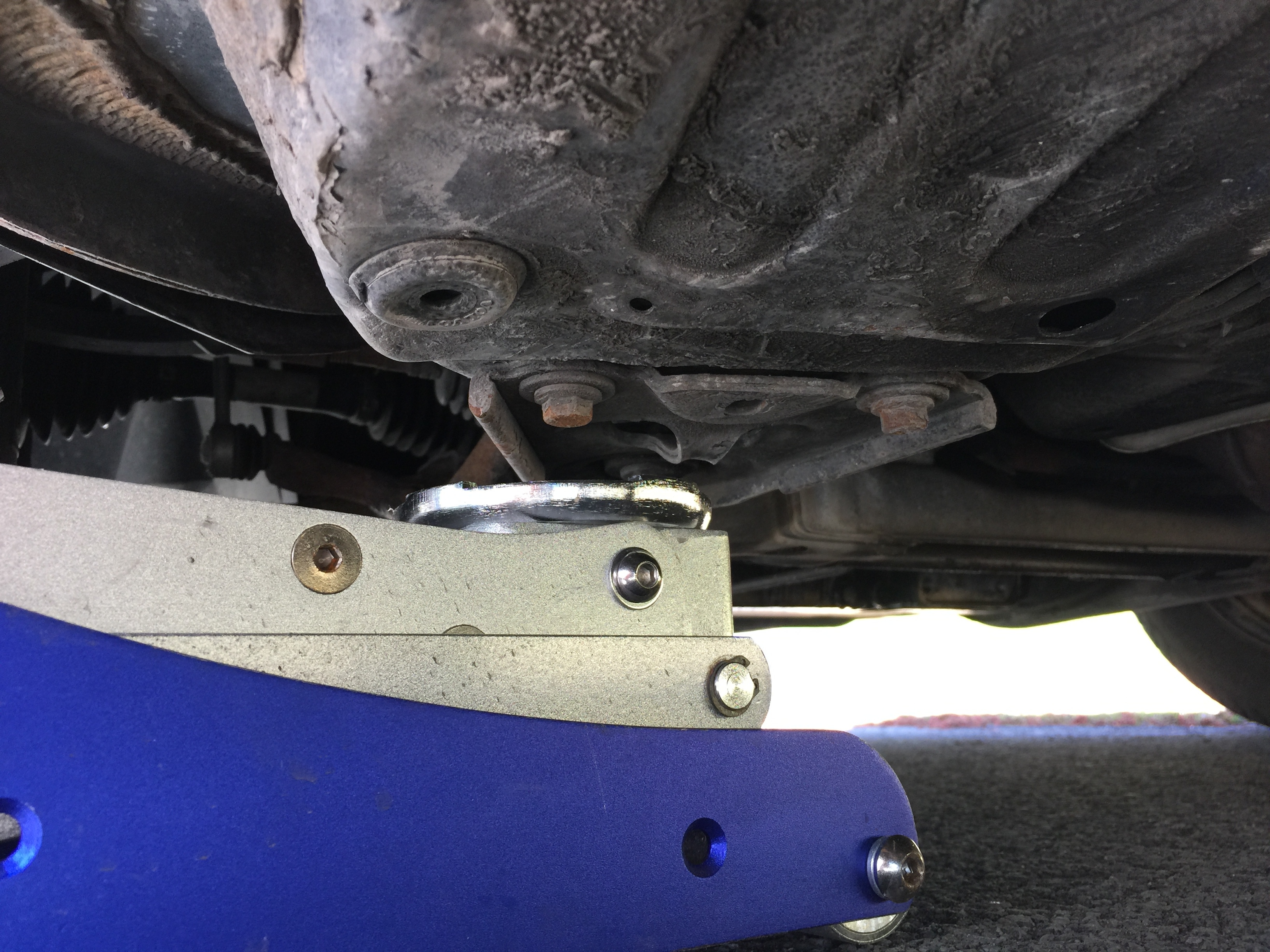

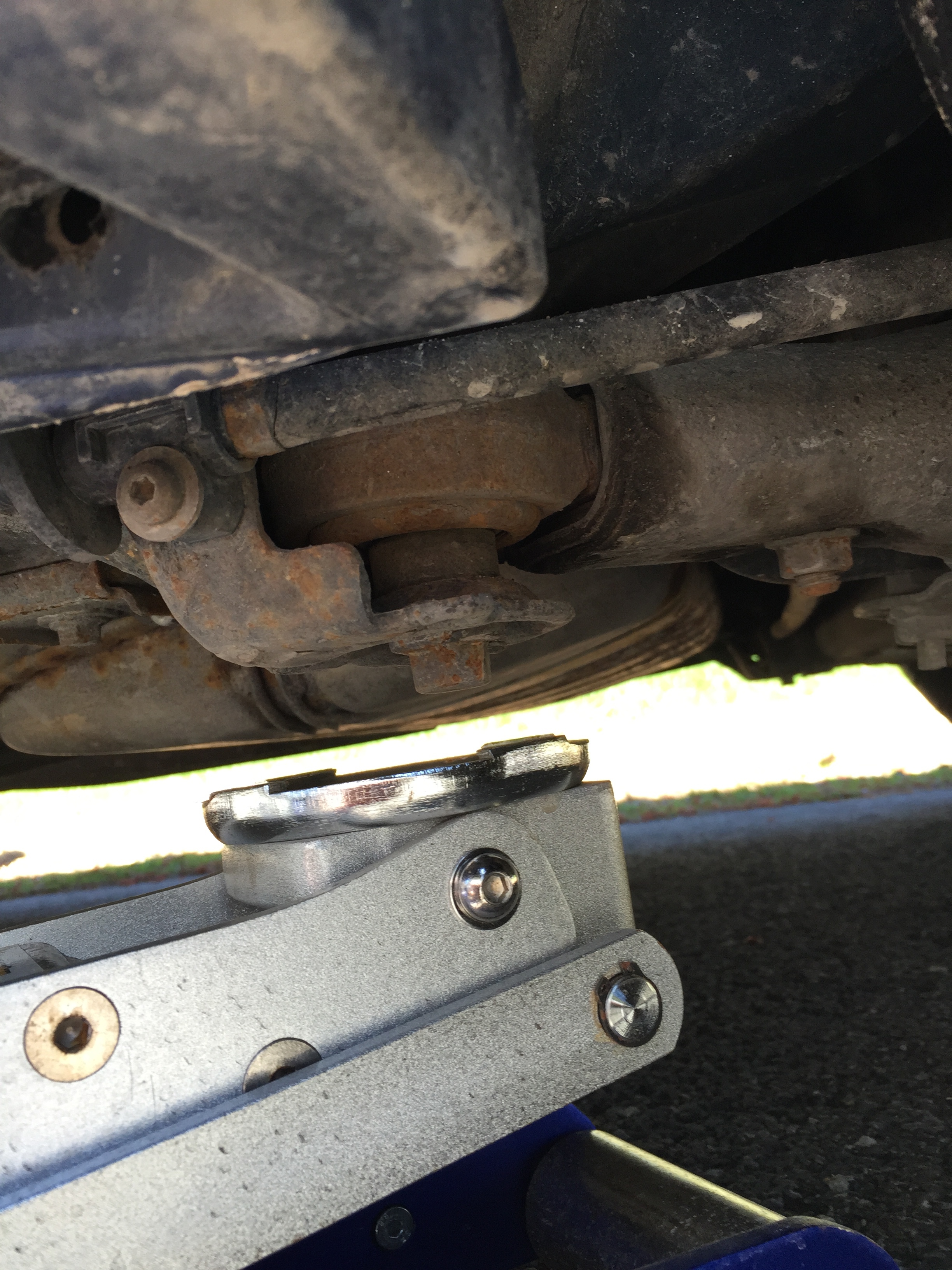

You do lift the whole side with the mid-car jack point on FWD models
AWD models have an additional jackpoint in rear.
Manual is here, with pix
http://new.volvocars.com/ownersdocs/199 ... 70_000.htm

Ill snap a pic of what I do and post. What kind of jack is it?
Scissor?
Bottle?
Floor?
Scissor?
Bottle?
Floor?

I use the same points as shown by abscate when using my trolley jack.
For axle stands was trying to find a decent picture but could only find this from a 1997 850 estate
but i assume they be the same area for the v70? as for my S70 that is where the front axle stands go.
