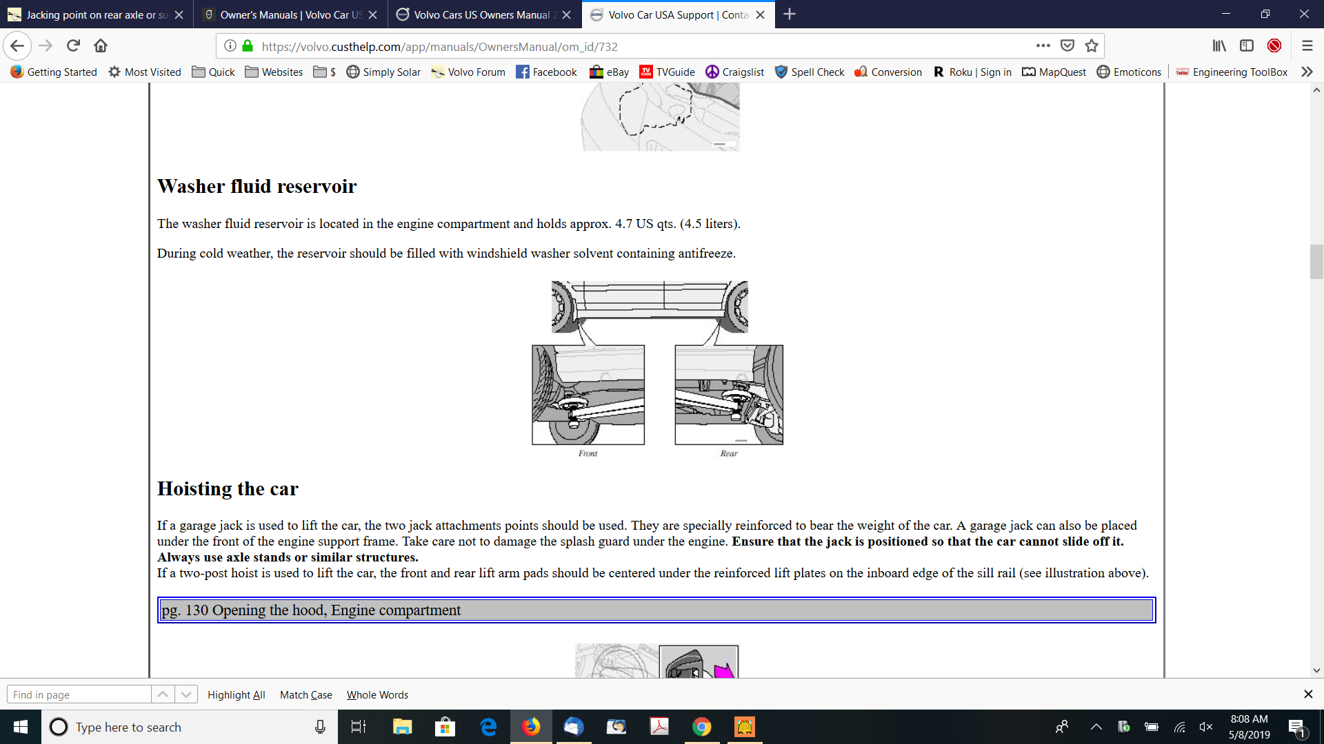

under the left rear of the car. However I am not familiar at all with a specific jacking point on that left rear side as I want to be safe.
Can anyone tell me or send me a photo of a good jacking point for this job?

The best jack point is the jacking point in the manual. Then a jack stand under the beam, because , of course, no one works under a car on a jack, since Darwin has removed those genes from the pool.

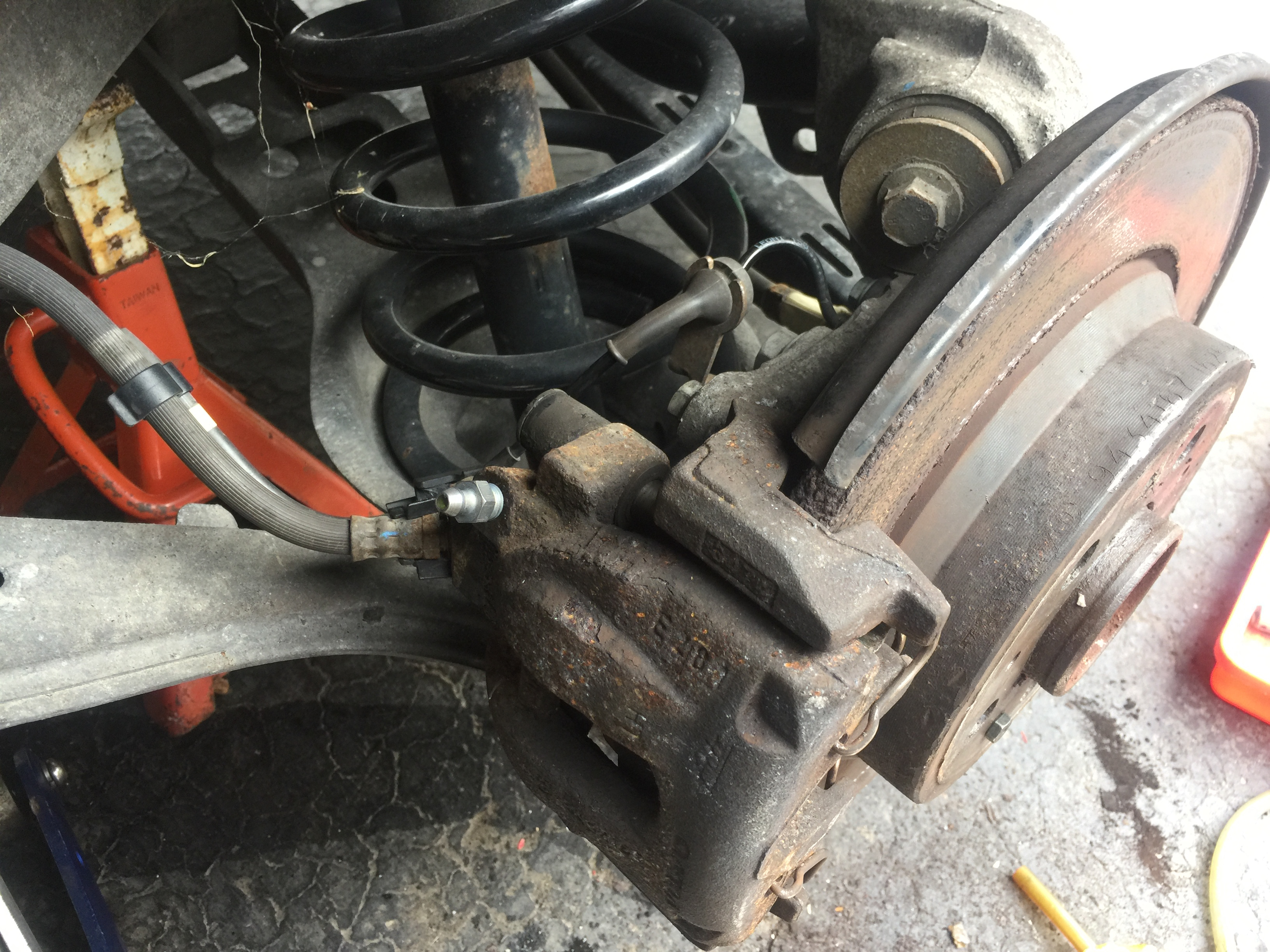

Floor jack?
Right under the spring, jack stand inboard.

For a floor jack. There are four hosting points under the car. Page 129 of your owners manual.
