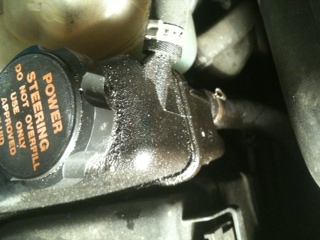

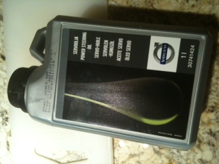

I had the same problem with my 2002 V70, 225k miles.
It was apparent that the reservoir was leaking. I've attached a photo of what that
reservoir looked like. The symptoms were as described: a low moan when turning,
foamy power steering fluid, some minor drips on the garage floor. Mine progressively
got worse over the course of a few weeks, even after topping off the PS fluid.
Replacing the reservoir was simple, it took about 45 minutes. I spent $122 for the
reservoir, fluid (photo attached, as it is the OEM fluid direct from Volvo) and clamps.
It was definitely more expensive at the Volvo dealer, but NAPA didn't have it and I
was getting anxious.
After installation I drove around for a bit and had to bring the fluid level all the way
back up again. I may end up replacing the fluid at some time, but am just happy now
that the moans and squeals have gone away.
