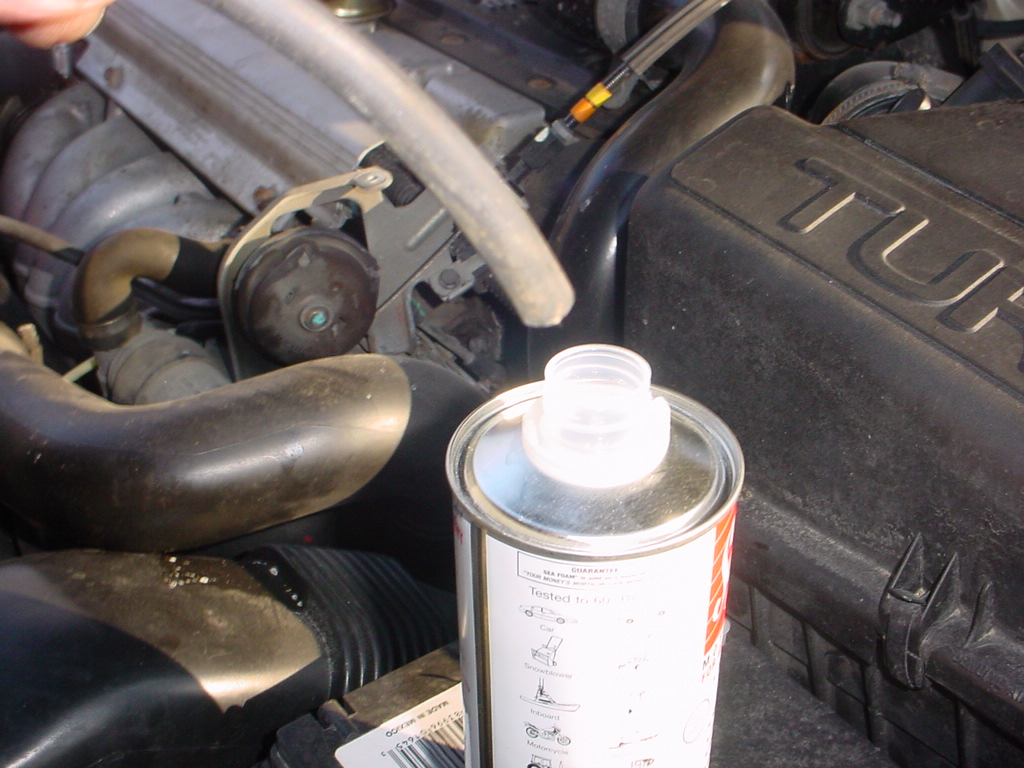

We bought 4 cans of Seafoam, do you recommend following the video instructions? We're not sure where the pvc valve is?

We don't have a PCV valve per se . We have a PCV system.
The appropriate place to add Seafoam to the top end is through the vacuum tree which is ender the throttle cam cover.
Slurp it ( the Seafoam) out of the can so as to not hydraulic lock the engine - that is, as they say in the popular vernacular, bad.

We did the Seafoam treatment today, didnt smoke a whole lot , engine runs stronger however it didnt fix that 5th cylinder.
