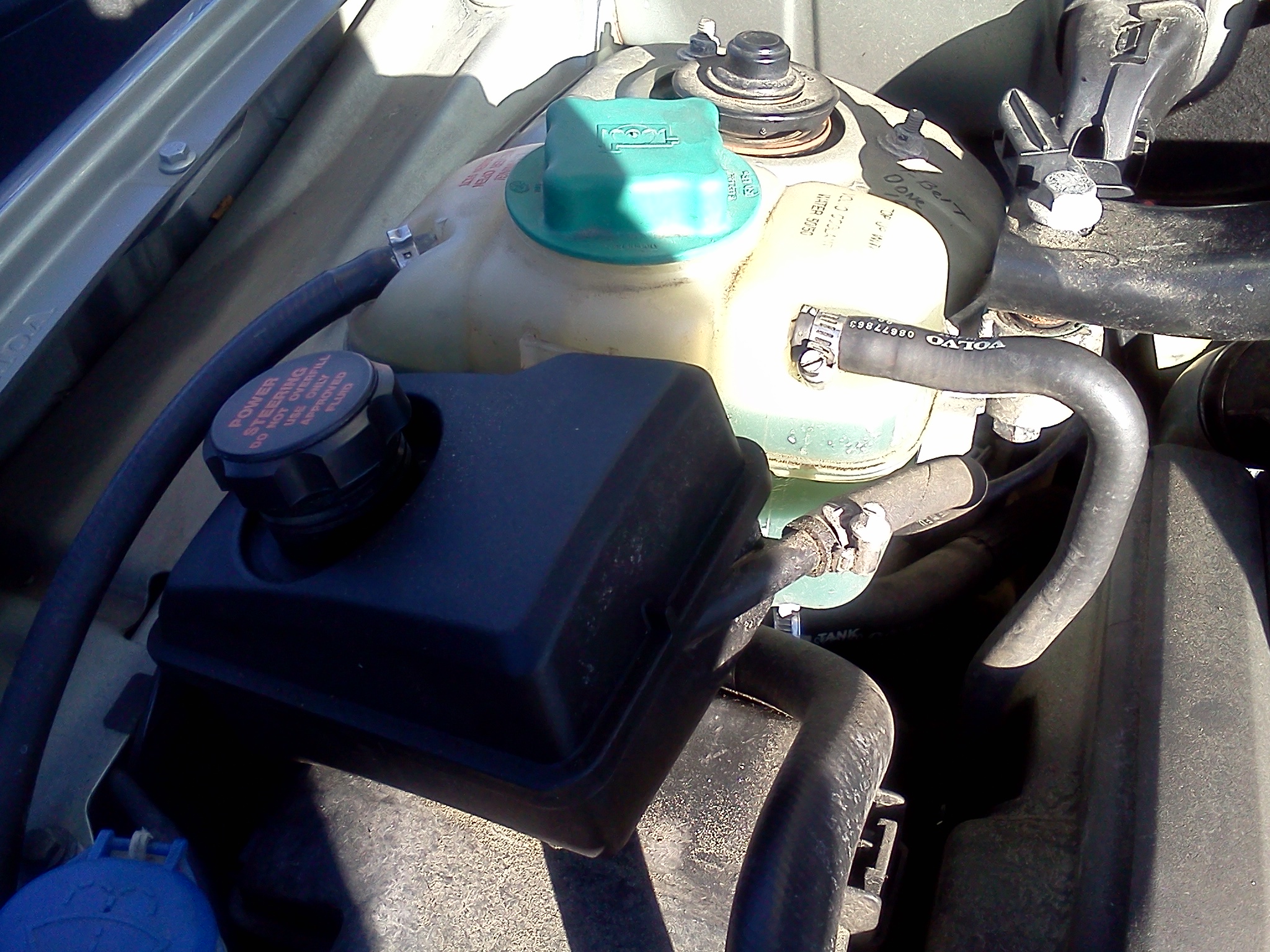

Thats mega weird. Can you post a pic? I'm having the same issue on my S80 T6 since I rebuilt the top end. In my case I reseated the connector and it helped for a while. I have more important stuff on the list right now so I'll just keep checking my level daily.craig1104 wrote:My tank has the extra hose going to the back of the engine compartment. I turned it upside down and didn't see any sensor nor wires.

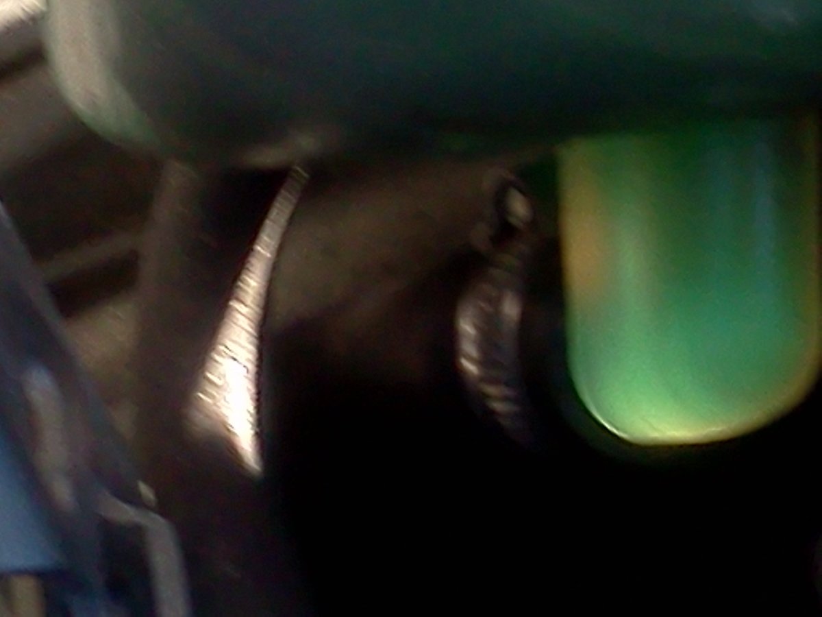

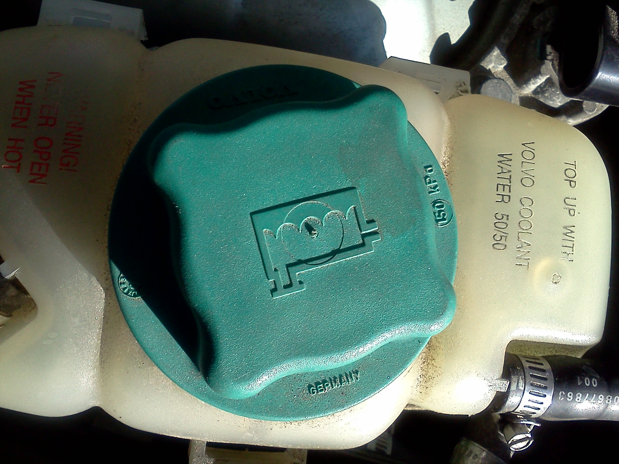

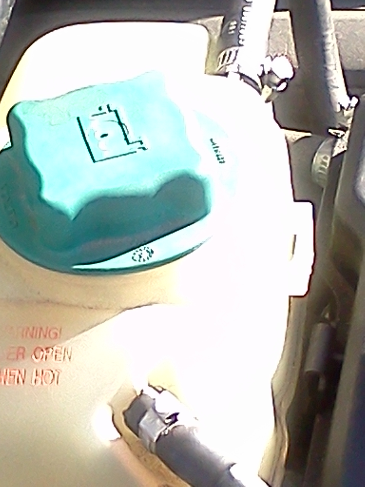

I will post pics tomorrow, but I removed the coolant tank again and notice that there are two hoses going to it on top, one from the right and one from the left. There is a third hose, larger than the other two that comes out from the bottom right rear. I notice that there is a cut out on the bottom of the tank where the sensor should go. I don't see any sensors in the tank.

Just went out and looked at my XC90 (Mine is a T5 Automatic - 5cyl turbo). You will need to remove the tank and look at the bottom. The sensor should be located there. I did notice my sensor had alot of dirt/grime on/around it, so I cleaned it off and used some dialectic grease to help keep moisture out of the contacts.
