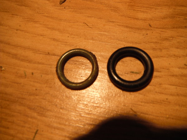

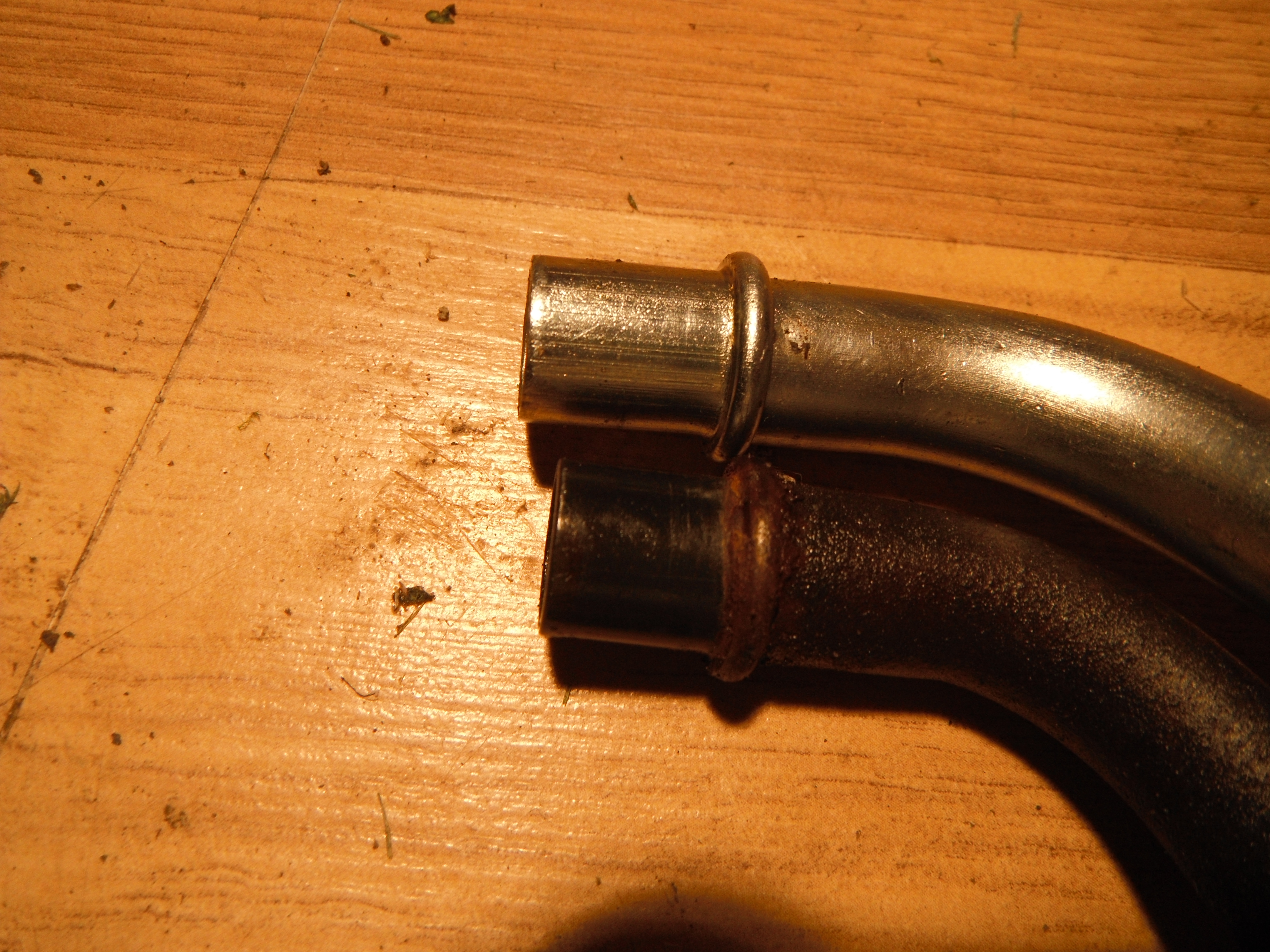

Thank you for all the info! One of the oil cooling lines was leaking on my 1998 V70. I found this thread and decided to do the work myself after I ordered the upper and lower oil cooling lines from Sweedishautoparts.com. All the great info and pics here made me confident enough to start the work when the parts arrived.... I got the lines out without too much trouble. Just messy because of all the oil gushing out even though I emptied the oil from the engine and removed the oil filter before removing the lines and the thermostat. I cleaned up the thermostat and tried to fit the new lines in. The lower one went in no problem, however the upper Iine didn't. First the o-ring that came with the lower line (black o-ring on photo) was too big. Bigger than the original one (green o-ring on photo) and bigger than the one on the upper line (green too). I tried with one of the original green o-ring, but still didn't fit. It appears that the tip of the lower line going into the thermostat is too long. It is longer than the tip of the line I removed (see photo) and longer than the tip of the upper line. I ordered OES parts (more expensive) from Sweedishautoparts.com. I noticed that the two lines came in two different bags. The upper line (which fits in the thermostat) came in a volvo bag with ''Made in France written on it'' (see photo) and the lower line (which doesn't fit) came in a generic looking bag with ''Dorman products, Made in CHina'' written on it (see photo). I contacted Sweedishautoparts.com explaining the problem with photos to help, and they answered ''We ordered that part directly from Volvo. No idea why it will not fit unless there is a difference in a Volvo for the Canadian market.'' Here's my question to people reading this post... are the tips of the lower and upper oil cooling lines different in length on US volvos? My guess is not, but I just want to confirm. I need my car, but right now I can't get it running because the lower line doesn't fit... If Sweedishautoparts.com can't help me, should I just cut the excess length on the tip of the lower line and use one of the original o-rings? Has anybody had that problem?
Also the removal of the old lines was made easier by the fact that the nut holding the lines to the engine wasn't there... It must have fallen...the lines didn't seem to be moving too much. I'm wondering though if the lines started leaking because of this. Once I get a lower line that fits, I'm planning on simply ziptying the lines to the engine or something... would that be ok? or should I order or find an appropriate nut. Any idea of the nut/thread size?
Thank you!

I would not be happy about a part not fitting nor the fact it was made in China , that just seems odd . These guys really should help you out and you shouldn't be trying to do mods to make it fit , if it isn't right they should allow you to return it .
Perhaps you should source the line from a CDN Volvo dealer and see where it was made and if it is correct so it fits . With the differences in the Chinese part I would not be comfortable using it nor would I trust it .

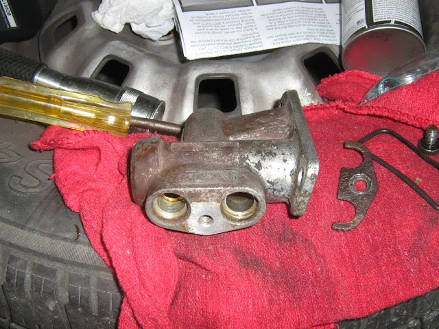

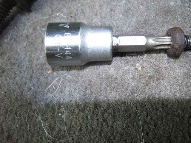

I would try to find a bolt to fit. Is the little flange the bolt goes through missing as well? I'm attaching a picture of the Torx bolt that holds the lines on the thermostat, with a Torx socket in it (T30 I think). This might help find the correct size bolt. If you have a T30 socket, measure the diameter and look for a bolt about the same diameter. Or just remove the thermostat and take it to a parts store and get a bolt to fit. I'm also attaching a picture that shows the flange etc - the Torx bolt is way to the right of this picture. My experience is that removing the thermostat makes it a lot easier to put the lines back on anyway.bcv70 wrote:Also the removal of the old lines was made easier by the fact that the nut holding the lines to the engine wasn't there... It must have fallen...the lines didn't seem to be moving too much. I'm wondering though if the lines started leaking because of this. Once I get a lower line that fits, I'm planning on simply ziptying the lines to the engine or something... would that be ok? or should I order or find an appropriate nut. Any idea of the nut/thread size?
Thank you!
If the lines you bought don't fit, there are some threads on the forum about repairing the old lines. I haven't done it myself, but it doesn't look that difficult.
- oil cooler thermostat nut IMG_2646.JPG (113.73 KiB) Viewed 3209 times
- oil cooler thermostat and parts IMG_2626.JPG (130.12 KiB) Viewed 3209 times
