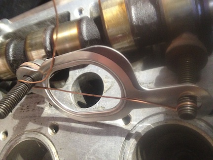

tryingbe wrote: 12 Apr 2017, 12:19 I would suggest VICTOR REINZ MS19361, but Volvo 30777495, 8699467, 86994670 also works. For one thing, the gasket will stay in place when you bolt the exhaust manifold on, that can NOT be said about those stupid individual gaskets.
Cut the red part off before use.
I'm doing a 96 850R and IPD says that gasket won't fit my car. I think it will but I don't want to wait to find out. Probably order one and hang it on the wall. If it saves me from dealing with the worst exhaust manifold gaskets ever designed next time that will be great.
In the meantime I came up with a trick. I stripped some smaller gauge solid copper wire and formed the end around a stud and then backed the stud out so the end of it could be threaded into the circle once the bottom one is through the manifold and gasket thus holding everything together on the other side. I held the top stud in place the same way but instead of wrapping it 360 degrees I only went 180 and left it long enough to tie off somewhere. I did this on all five gaskets and then put the whole works up against the cylinder head threading each stud into the head a few turns. Then I was able to pull on each wire and the soft copper uncurled from the bottom stud and came out whole. then I just tightened them from the center out and had an exhaust manifold installation without fighting those gaskets.

That looks like a handy fix, nice.
The engine block in tryingbe's picture is the same one you have in your 96 R.
