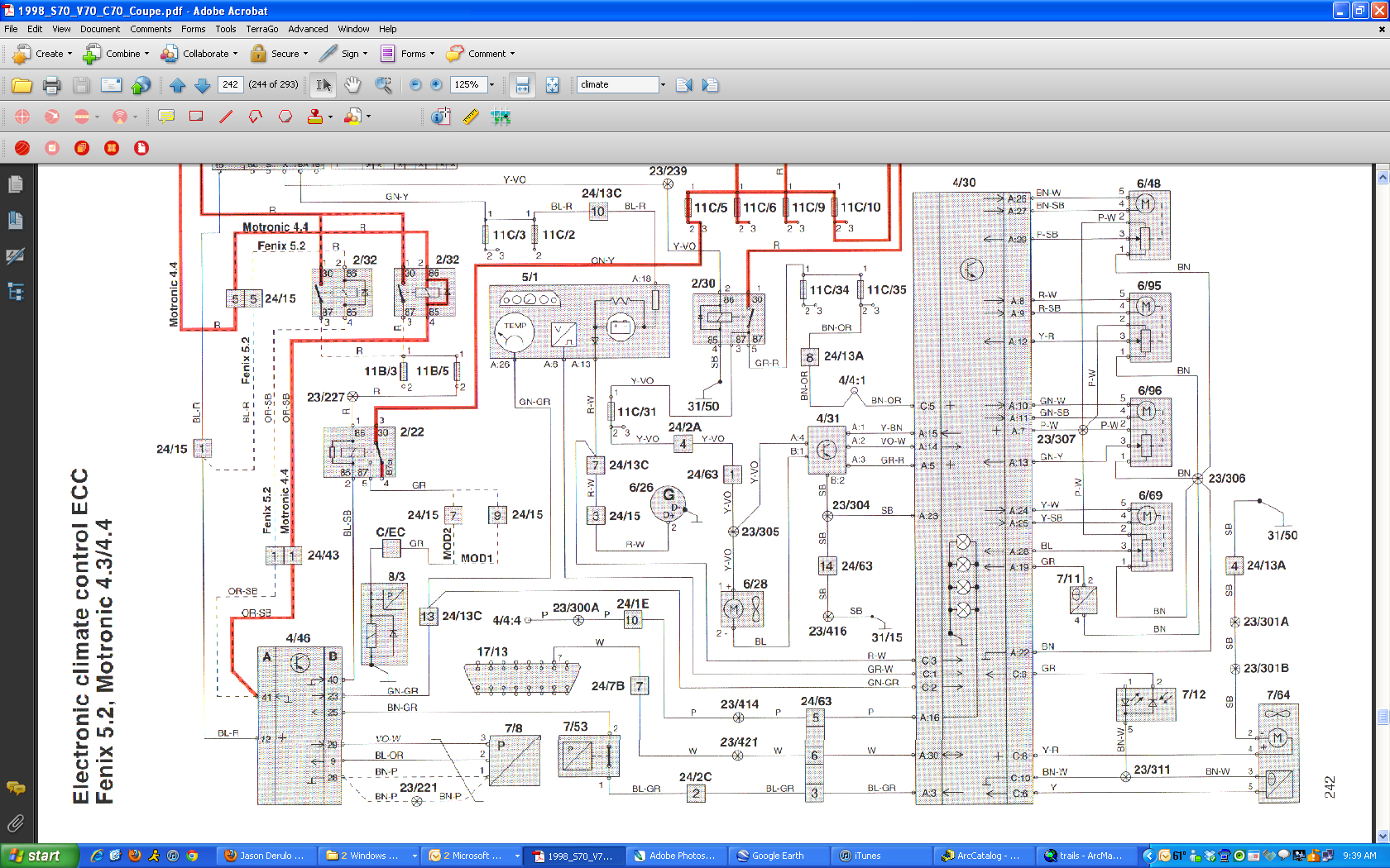

Ok, looking at the diagrams, you're concerned with 4/31 (resistor) and 6/28 (blower)
Yellow-Brown is input signal
Violet-white is the output signal back to the ECC
Green-Red is the "hot" wire
Black is the ground from the resistor back to the climate control.
Not sure why this won't attach as a picture, but:
'98 S70 T5
2016 Chevy Cruze Premier

jblackburn wrote:Electrical issues are such a pain, but at least this way, you were able to try out your components in another car and verify they work rather than just throwing [expensive!] parts at it.
Amen!
Thanks for the diagram. Not sure if I will have time today, but I will study it over and dive back into it if I can get a few minutes to focus on it.
