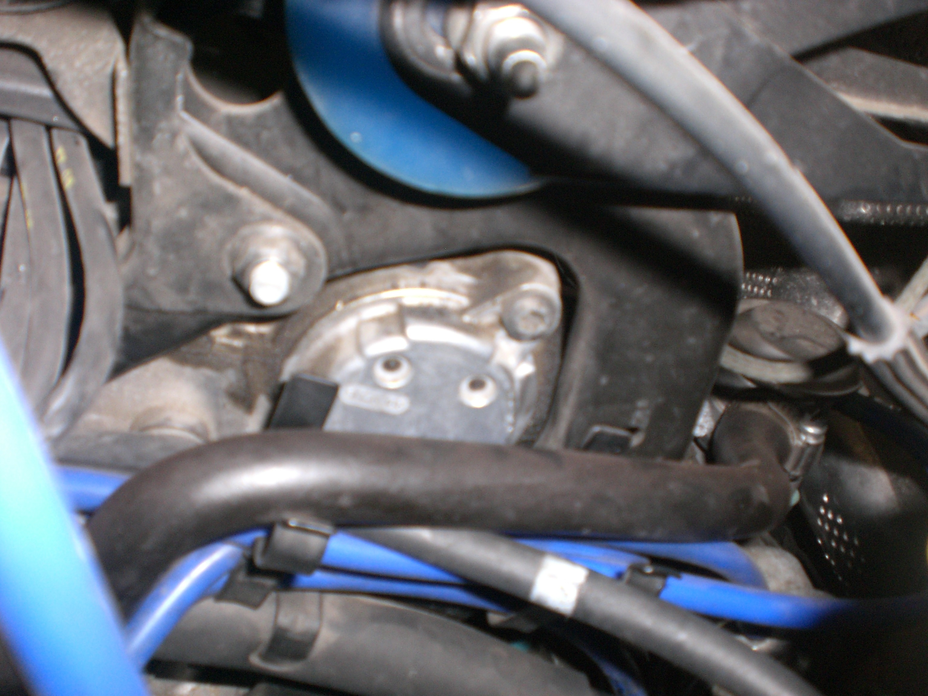

JRL,
Is the rear cam sensor this round aluminum plate in this picture? Directly under the engine mount strut mount? I think this is where you were describing....it looks fairly dry. Some old, pretty dry gunk around it, but not a fresh leak. And the bottom of my turbo and my turbo oil return line were pretty wet, so I think the leak is the turbo oil return line gasket. I put a new topic out on that.....https://www.matthewsvolvosite.com/forums ... =1&t=41451
Cam sensor?
Thanks much for your time and everyone else's as well!
Jim.
_____________________________
1998 V70R Silver 180k

That's it - looks pretty dry to me.
