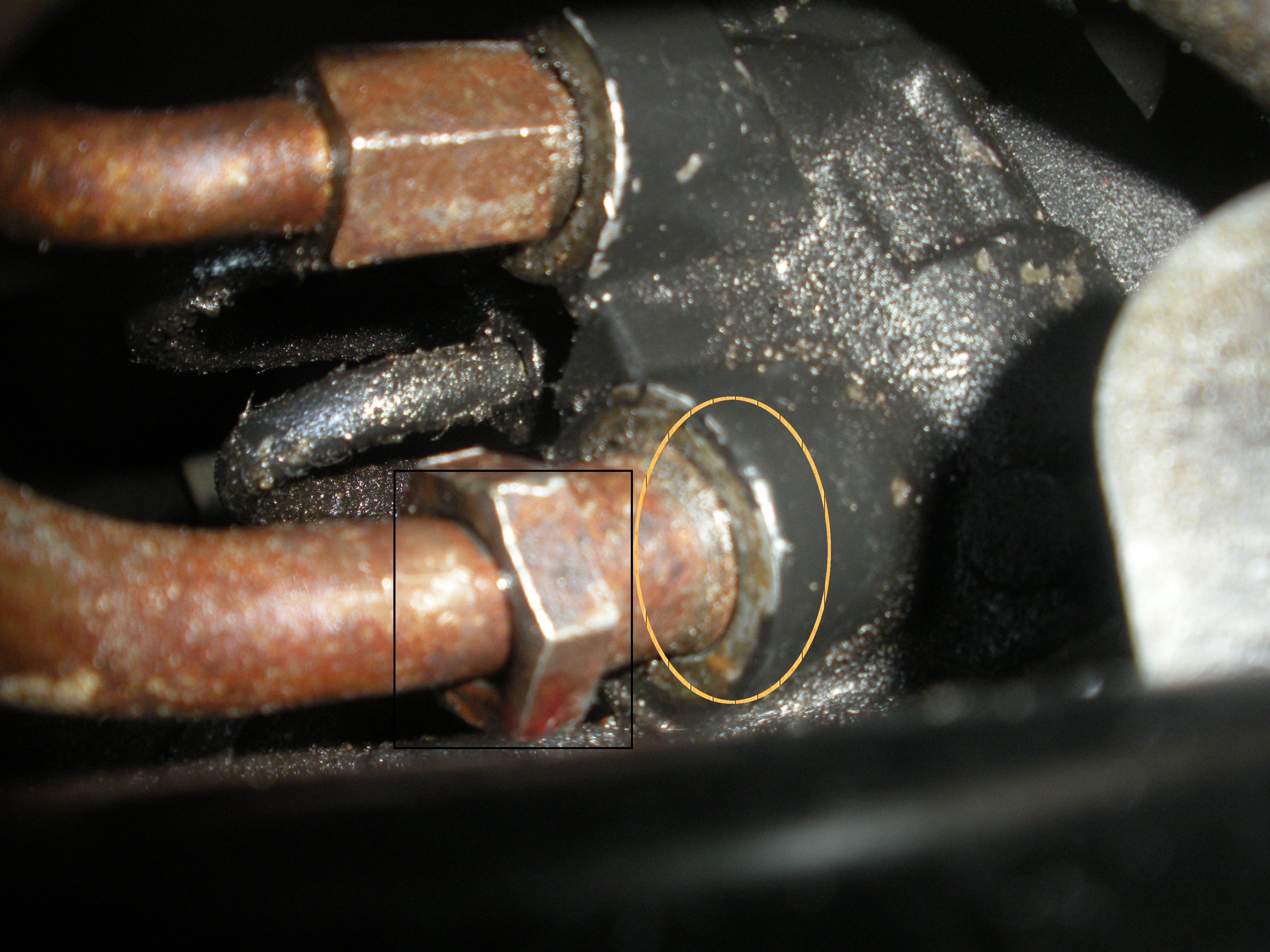

Finally muscled the nut off the power steering return hose. Took a long time since I didn't want to drop the sub frame.
So now my question is the only O-ring in this area of the hose between the end of the hose and the rack (yellow circle)? That's all I see in the diagram that Jeff posted. There is no O ring between the nut and the straight part of the hose that I have to worry about (Black box)? The nut keeps spinning but it doesn't do anything else.
Thanks for all the help.

Flare nuts must be perfectly aligned to even catch the first thread, they always give me a fight.
Move the line around a bit until you can get the nut to catch.
Were you able to slide the nut back to inspect the line itself for a crack or a hole?

Ozark Lee wrote:Flare nuts must be perfectly aligned to even catch the first thread, they always give me a fight.
...Lee
Thanks. Well I haven't got the hose completely off. I've been just trying to pull it out of the rack (still attached to the pump). The nut was just spinning when I was loosening it but haven't tried pushing it back in to tighten.
When I tried to pull the nut back it just slid back a little. Can't really see any damage but then again my angle is only from the bottom just like the pictures show. Do you think I should just take the entire hose off?
So there is no O ring between the nut and the hose right? Just have to worry about the o ring at the end.
