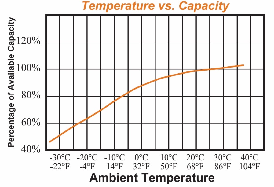

Chart helps.

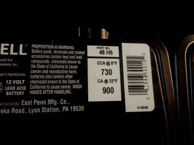

This H6 battery in our 97' 850 says CA @32ºF 900 and CCA @0ºF 730. Is 900 & 730 an Amp value?
Per this chart, in my situation of temps @-20ºF. Would the CA drop to 400 and CCA to 300, respectively (ballpark)? Where will the voltage be -- 9.xxV?

Yes - 900 amps at 32 degrees and 730 amps at 0 degrees. My quick calculation shows 480 amps at -20 degrees. At minus 20 you better have synthetic oil if you want it to start!xHeart wrote: 31 Jan 2019, 09:40 Chart helps.
BTW - wind chill DOES NOT COUNT for oil and batteries, only people
