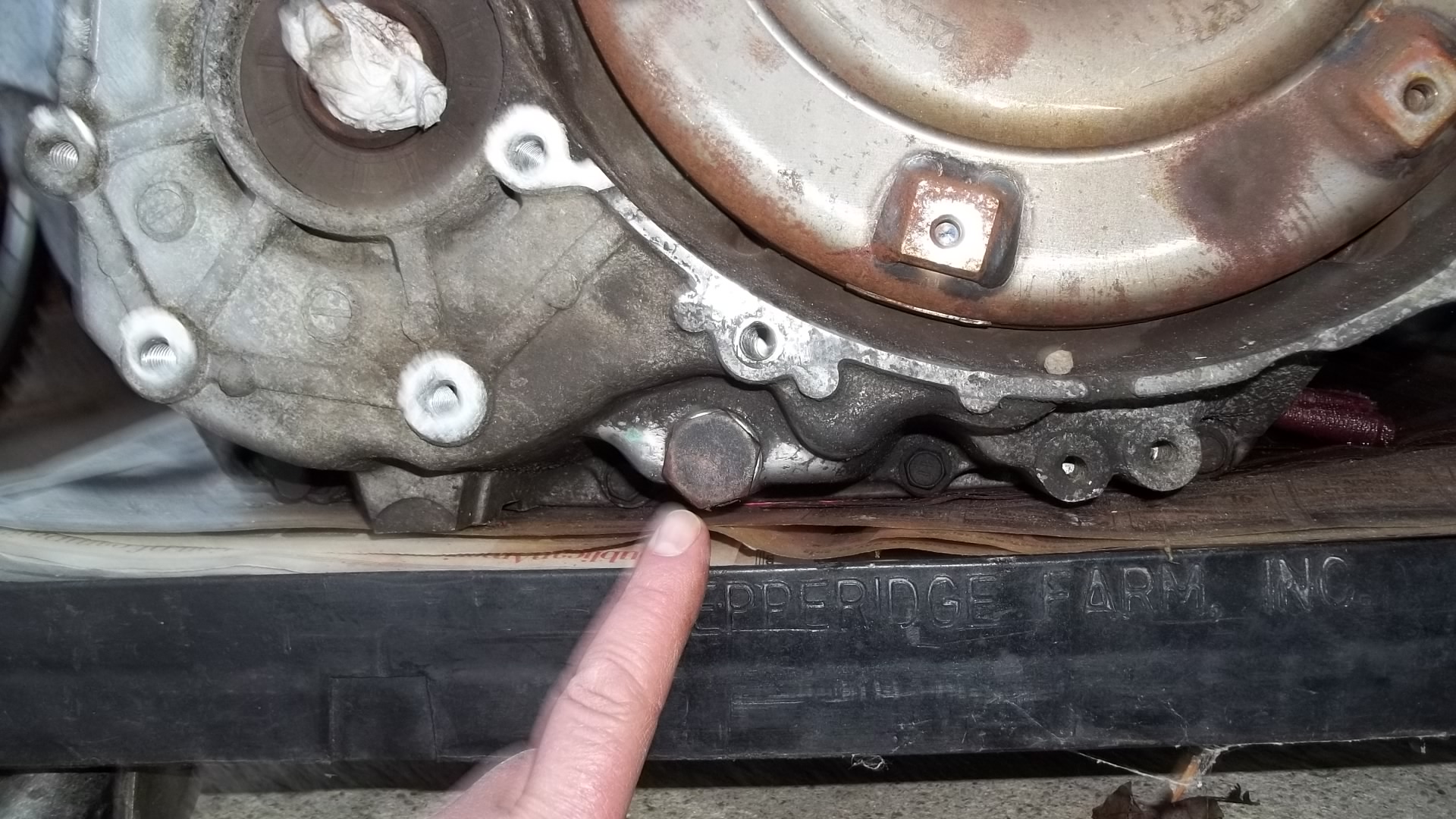

This is a great write up I know its old but if someone could please tell me which bolt is the drain bolt I cant figure it out from the pictures

Maybe this photo will help. Sorry it's kind of fuzzy.
The drain plug is on the right side of the transmission.

bigd2172
Posts: 2
Joined: 20 February 2016
Year and Model: 2002 S40
Location: Las Vegas
Post by bigd2172 »
That picture did it thanks a bunch...
