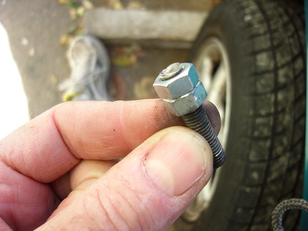

If the threads are clean enough get a couple of nuts on the shank and tighten them together. That gives you a "hex head" on the bolt shank. Then like Lee said, hit it with PB Blaster to soak overnight. It will come out (mine wasn't finger tight, but it did come out, if hard all the way).

JimBee wrote:If the threads are clean enough get a couple of nuts on the shank and tighten them together. That gives you a "hex head" on the bolt shank. Then like Lee said, hit it with PB Blaster to soak overnight. It will come out (mine wasn't finger tight, but it did come out, if hard all the way).
The nut is not agreeing, it would not thread from the top of the shank. I have tried both clockwise and counter. Scratching head!
