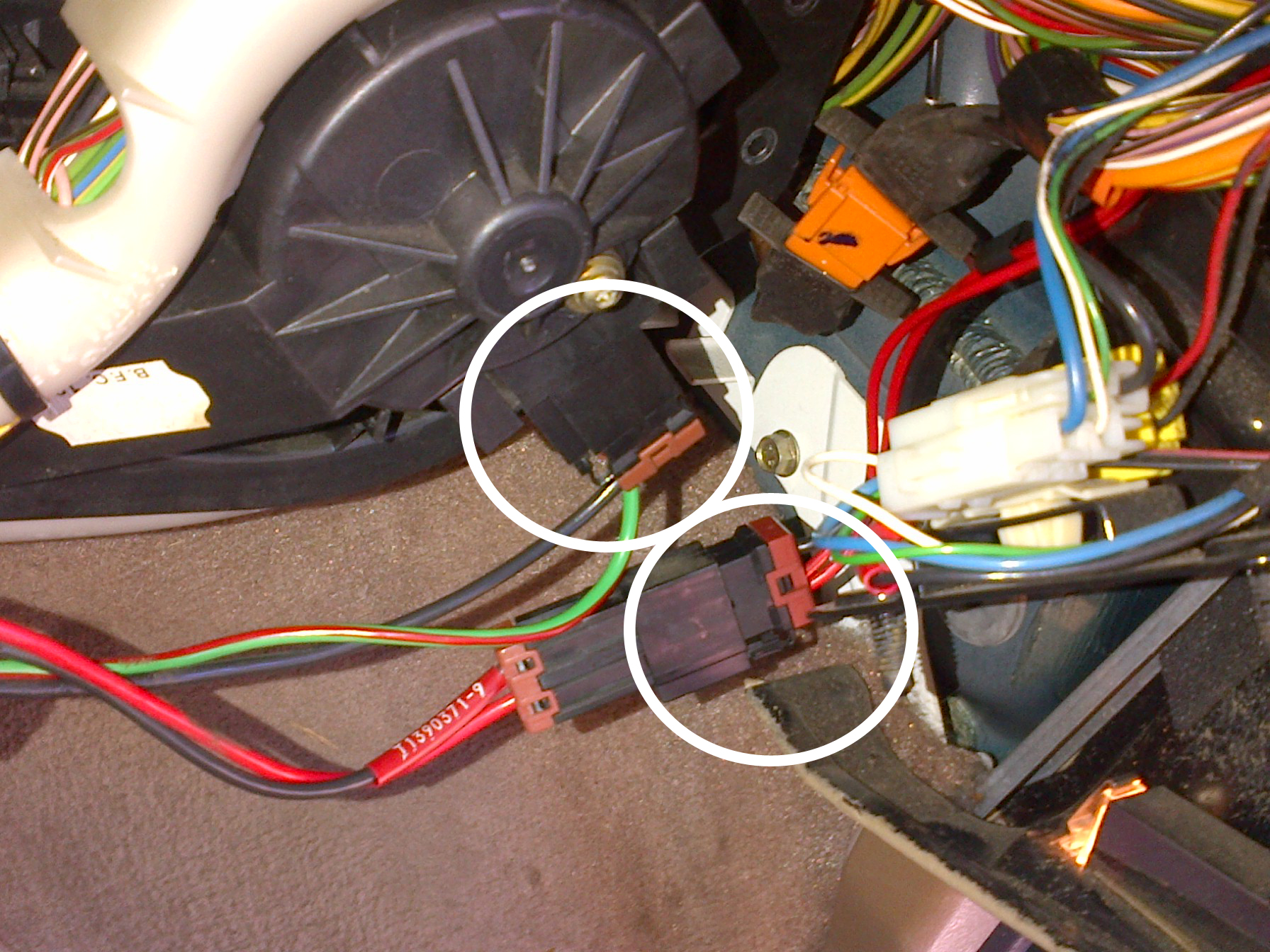

So here is a recap and some pics for the next guy with the same problem. It turns out I did reconnect the wrong wires...
If you look in this picture, you can see the 2 circled connections. The bottom right (reddish) one fits perfectly into the blower motor and the the upper (orange/brownish) fits directly into the bottom left female with the red/black wires. After reading timmyc's comment about the plug, I looked this afternoon and realized if I had connected them right the red/blak wires would have matched up on both the male and female not going to the blower motor. Once I connected it correctly all was good! I was glad my solder job worked...
But for the next guy, here is was Lee was referring to.

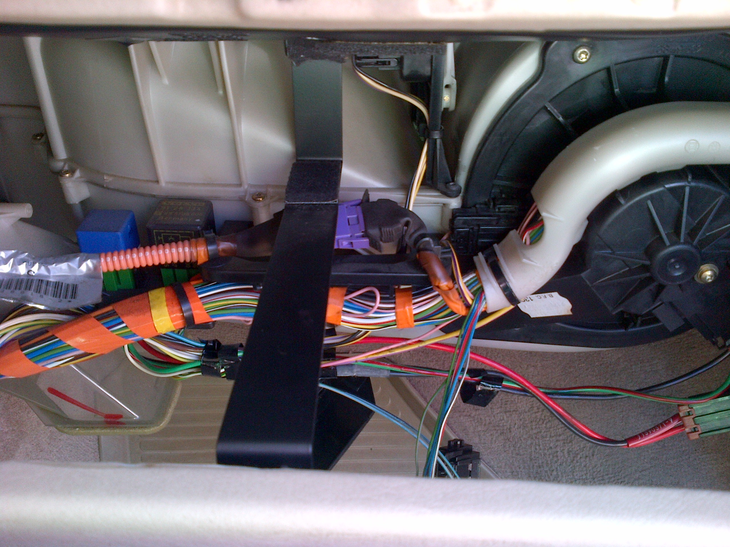

In this picture, you can see the blower motor and to the left you will see a Blue and Black relay, my instinct says, blue is A/C cause it's cold... wrong
Blue is the fan
Black is the A/C relay So hopefully these pics can help the next guy see what Lee is referring to. I have the Manual Climate control (MCC) by the way.
Thanks again for all the help!
