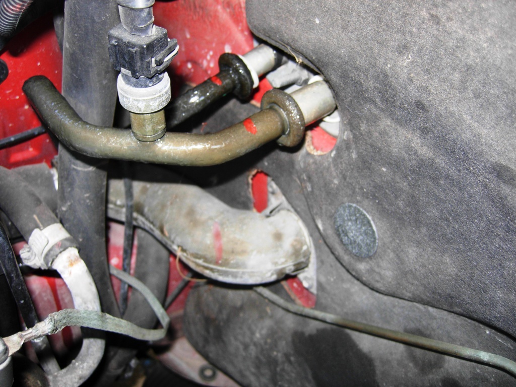

Hi all....i received the Gates K060495 belt and would like to install the belt to bypass the a/c compressor. Just to clarify though:
1.Is the compressor power supply to disconnect the one shown in the picture below?
2.The Gates K060495 belt is not double sided but the diagram below of the belt path without a/c looks like it needs double sided. Am I getting this wrong?
3.Also, will disconnecting the compressor affect anything else other than no a/c for my defrost? It doesn't affect the heating system, correct? I'd like this work around to get me to next spring.
Tnx....
Tnx....

1. No, that's the high side pressure sensor. Disconnecting it will make it cycle endlessly. Look down near the compressor, you should see the clutch control wire leading to it. Disconnect that.

Thanks for the quick reply. Ok, i'll focus on the wires on the compressor. It looked like there was just one wire connector that I could disconnect but I guess one would be enough to kill the circuit. And for the belt, I'm glad to confirm that the picture is the right belt path.

Yes, that's it. The clutch circuit is grounded through the compressor mounting bracket.ksdst1 wrote: It looked like there was just one wire connector that I could disconnect
Disconnect that, and the clutch will not even try to engage.
Incidentally, short that to positive to force the compressor on during filling.
