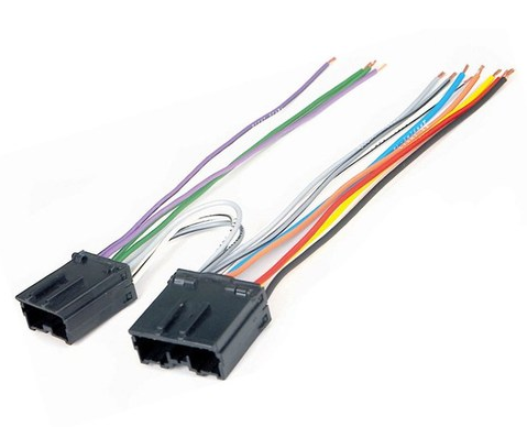

One question though, the dash speakers are no working at all, the connector wiring only provides for 4 speakers, any tips??

Your adapter harness should consist of two plugs with a set of white and gray
jumpers that run from one to the other. Those are the dash connections.
Screen shot 2012-11-08 at 7.13.51 PM.png (129.58 KiB) Viewed 2210 times
The dash speakers are on the second connector with the power hookups.
You remember that thing you did with the speaker connector?
Do it with the power connector, too.

Ill double check it, bit it looks exactly like your pic although theres four pairs of wires from the smaller plug. The OEm radio had an antenna like plug ( smaller) that I believe in the radio says Sub..
Thanks again

Should only be two pairs jumping.
White is Front Left
Gray is Front Right
Small antenna plug is for the diversity tuning
used in the higher end OEM radios. Ignore it.
