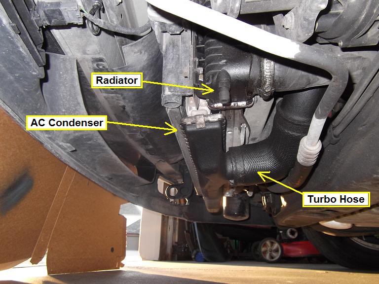

I just took a photo underneath the car.
The hose that goes from the Turbo to the front of the car, does it carry hot air to be cooled by the "cooler"?

Yes, that is the intercooler piping, where it connects to the intercooler.cn90 wrote:I just took a photo underneath the car.
http://bit.ly/U7yJHg
