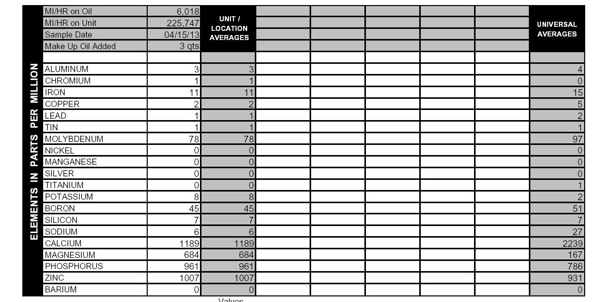

I did send in a sample to Blackstone for testing at about 225,000 and got the report back that a5,500 miles my oil had 57% of it's additives left. Meaning that I could probably change every 10,000. They recommended that I bump the changes to 8,000 and retest. I now change at about 7,500 but have NOT sent another sample in yet. I have two and will likely send one in.
Not sure where I posted the results but they claimed that my motor was burning very clean for it's age and there was very little of anything in the oil other than valve stem seals I think. The report shows what particles were in the oil in parts per millions I think and that different parts are made of different materials. So, if a crank bearing is wearing, it would have that material in the oil.
I'll see if I can find the report and link the photo here... You can always see one on their site if I don't find mine.
