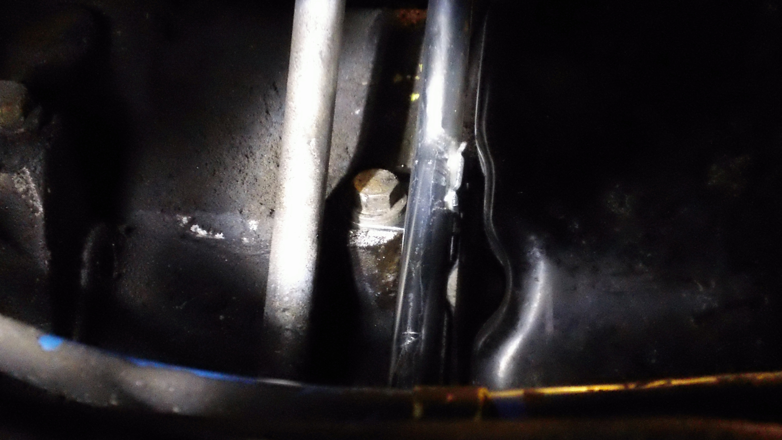

Below is a picture of 12mm bolt on the inlet line bracket. It is accessible from below once the air guide/splash guard under the radiator is off.
Place a wobble on socket, use it with 4" extension on 3/8.
