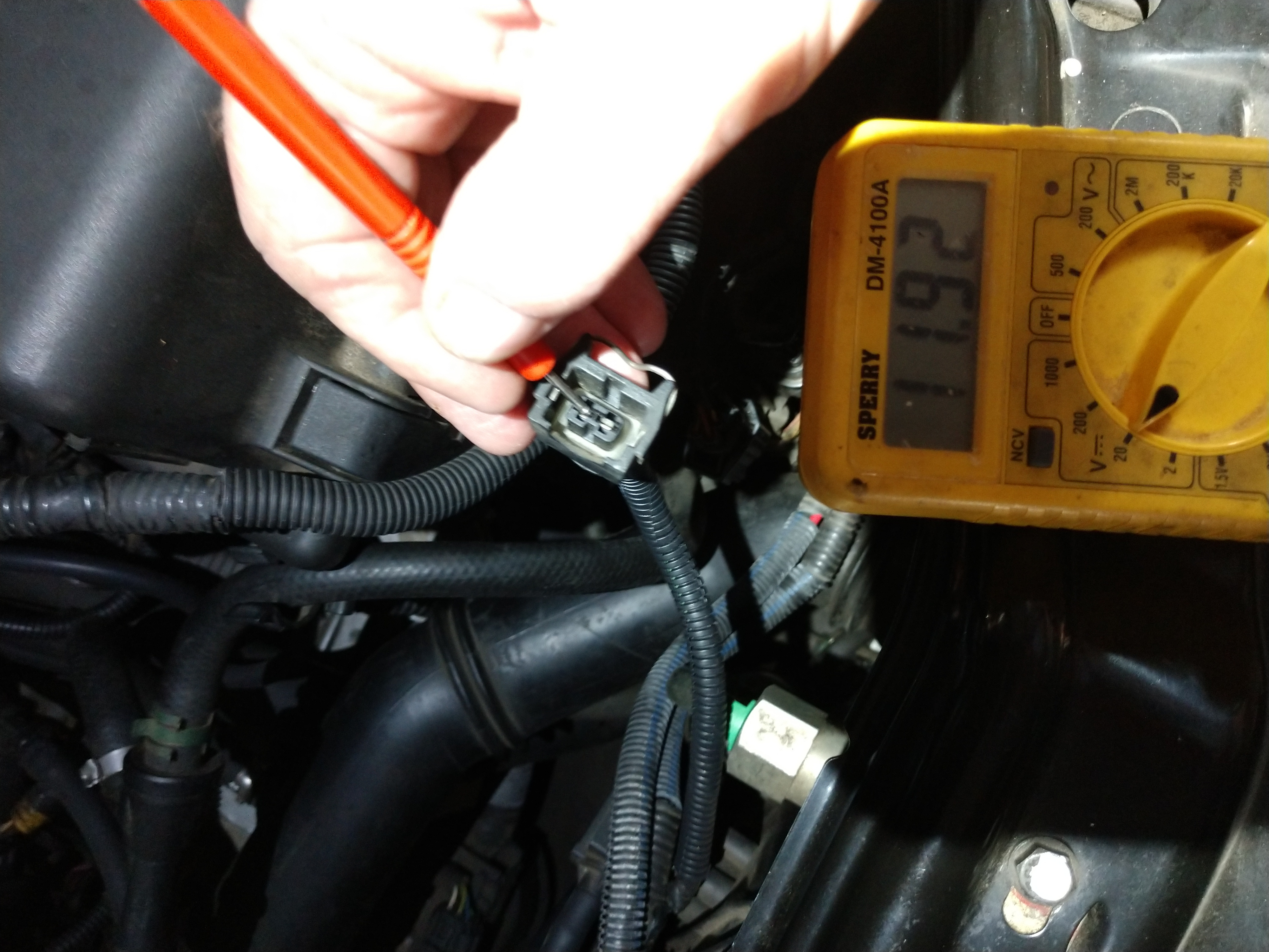

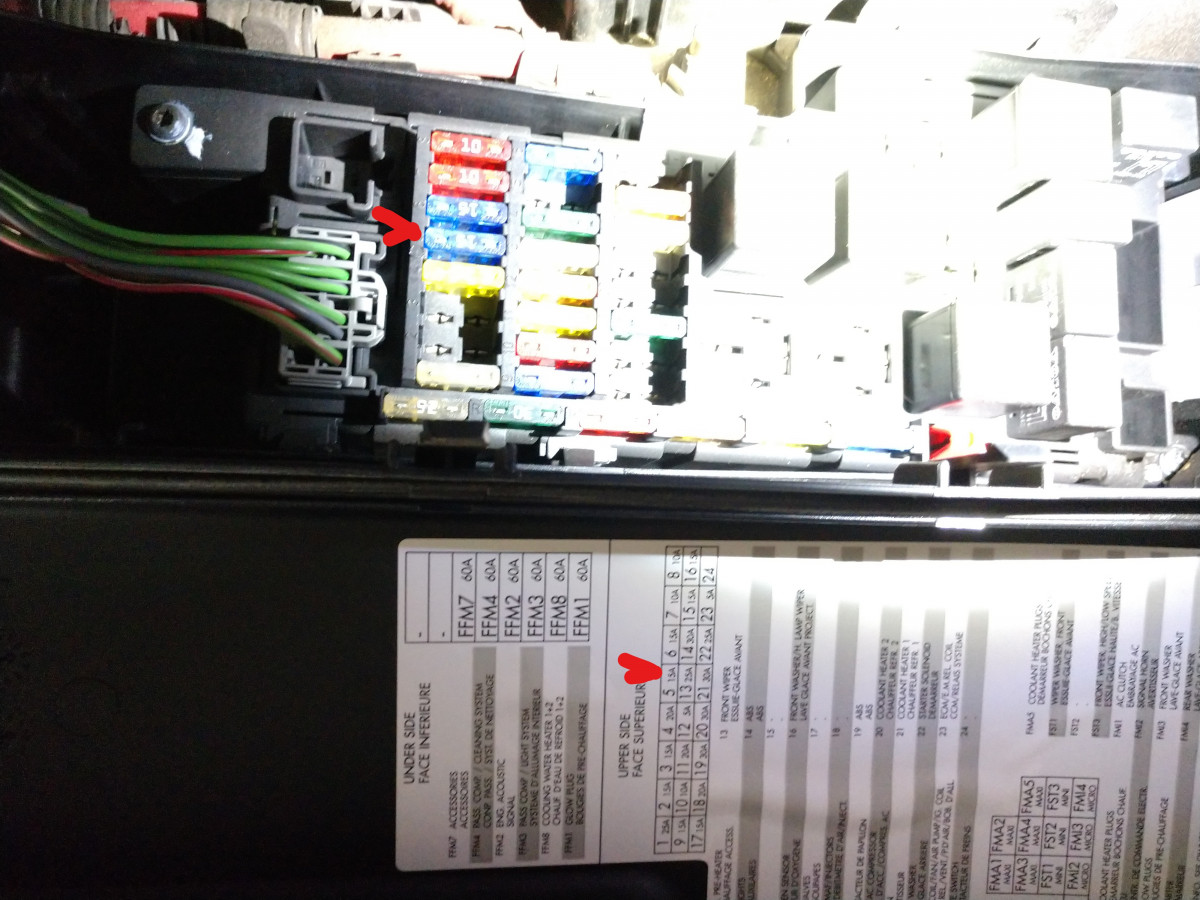

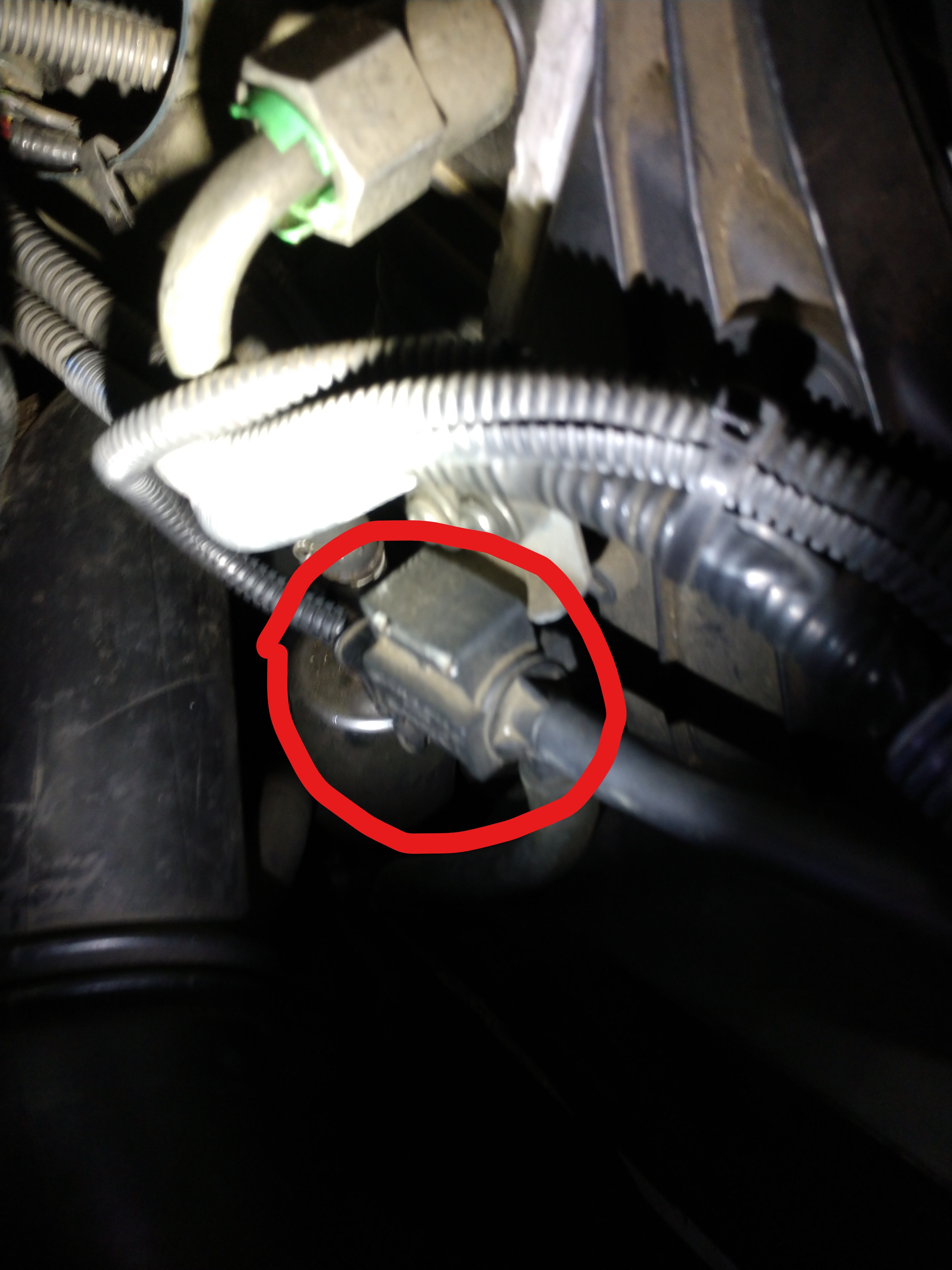

I looked at the wiring diagram for something in common with all these codes and it's the 12V supply to these solenoid valves. Fuse 11B/5 supplies voltage to the camshaft reset valve(solenoid), turbo control valve, EVAP solenoid and EVAP leak diag unit valve. I would check this voltage level. You could unplug the connector to the EVAP valve, which on my car is attached to the radiator fan shroud drivers side and measure the 12V level on pin one. You'll need the ignition in position II I believe. Check fuse 5 in the engine compartment. I suspect the 12V is missing or too low.
Edit: (Disregard, see Edit II) This 12V supply is not switched by the ignition switch so the switch does not need to be in position to II to check the voltage level. Also, because this is not a switched supply it's constantly there and possibly more likely to be shorted to ground when working on the car. Fuse 5 may be blown.
Edit II: Ignition key does need to be in position II to measure 12V at EVAP connector. Added photos.
