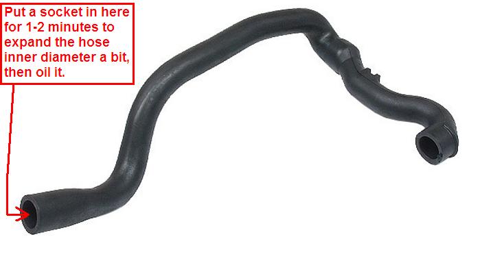

Went to dealer and bought PN 8692217, which is the rubber hose from oil trap to Valve Cover.
This is procedure for my 2005 XC90 2.5T, which is basically the same as in this thread.
NOTE: flash light and mirror is crucial!
1. Use a long pick tool with pointed tip and gently pry the Oetiker clamps just to loosen it. Don't force it too much as you can damage the oil trap nipple.
2. The LOWER part of the broken hose: get a pair of needle-nose pliers, grab the remaining rubber part and yank it upward.
3. Undo the #3 Ignition Coil (8-mm socket). No need to disconnect it from the connector. This gives you access to the Oetiker clamp.
4. Undo the Turbo Cooler Hose near the dipstick area.
5. I re-used the UPPER Oetiker clamp because in this location many people have problems with screw-type clamp (crowed are, ignition coil etc.). During install, I simply crimp it a bit with the pair of cutting pliers I have lying around. Gently clamp it so it does not cut through. In fact, it is very very difficult to cut through anyway.
6. The LOWER part of the new hose: Use a 12-mm long socket to enlarge the hose and let it sit for 5-0 min so the hose is stretched bigger a it. Then place a screw-type clamp on it before installation. I also oiled the inside of the hose a bit so it slides in better.
- Make sure the hose is fully seated on the oil trap before tightening the clamp. TRICK: with the clamp snugly on, use a long flat screwdriver and push down on the clamp only, taking care not to damage the rubber hose. When you do this: the hose is pushed down and the clamp is also pushed down.
- Make sure the clamp is about 1/2" from the lower edge of the hose, then tighten it.

If the only part you replace is PN 8692217 (hose to the top), the trick is inserting a socket to the lower end and let it sit there for 1-2 minutes.
The idea is to expand the inner diameter a bit because you basically insert this lower end of the hose down to the oil trap "blind" (well, with very limited view).
Once the hose is expanded a bit, you add some oil to lubricate it and should be able to get it in without issues...
