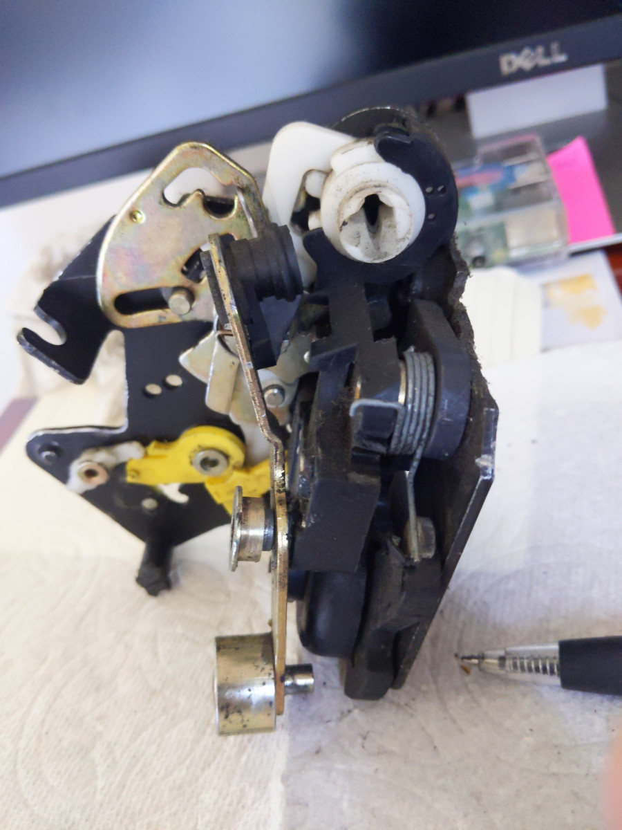

As the previous poster experienced, when I banged the hole with the screwdriver, it just went through. So I removed the door handle. This is what you should see once you remove the handle:

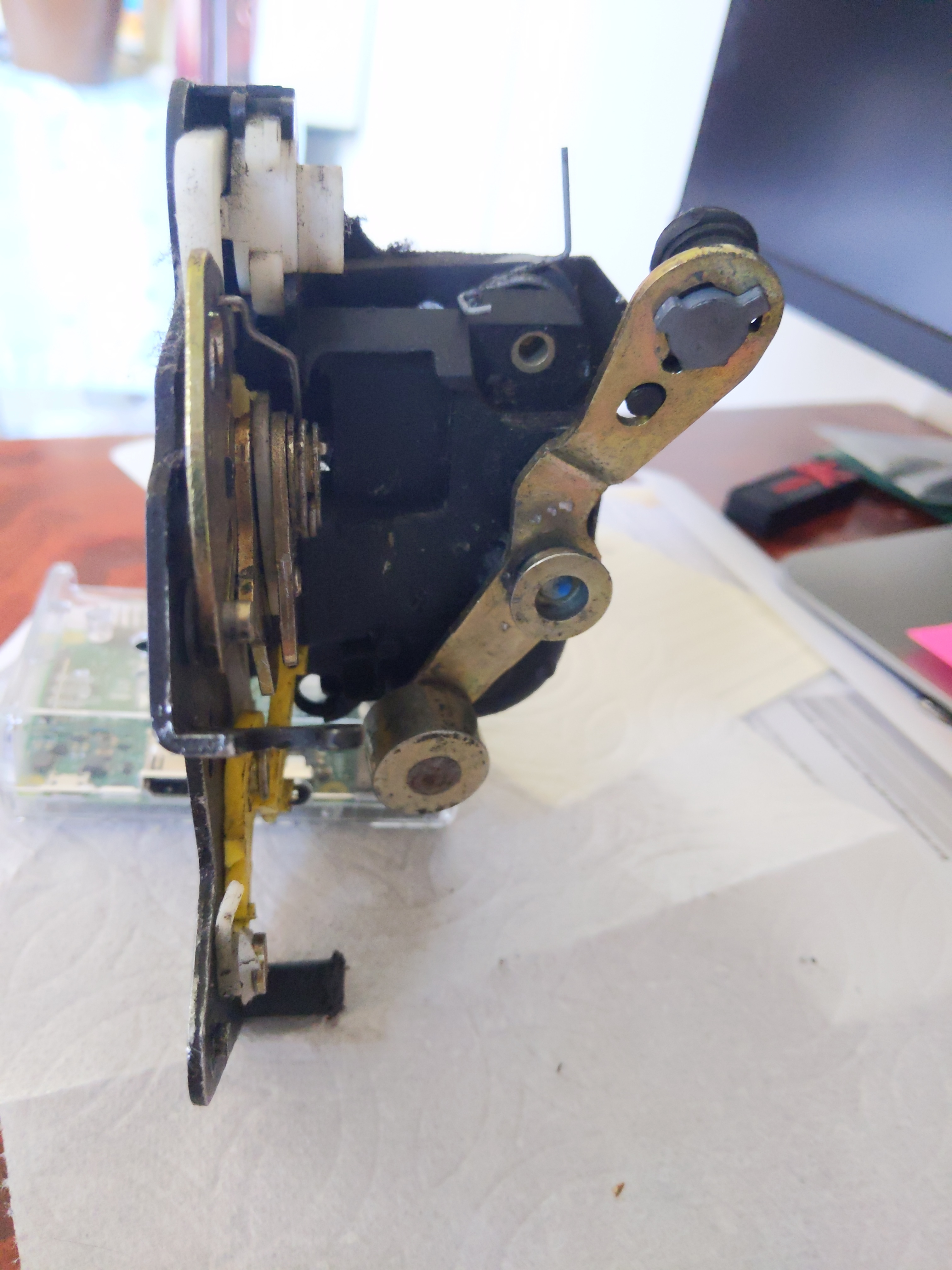

The latch that holds the door shut is this part.

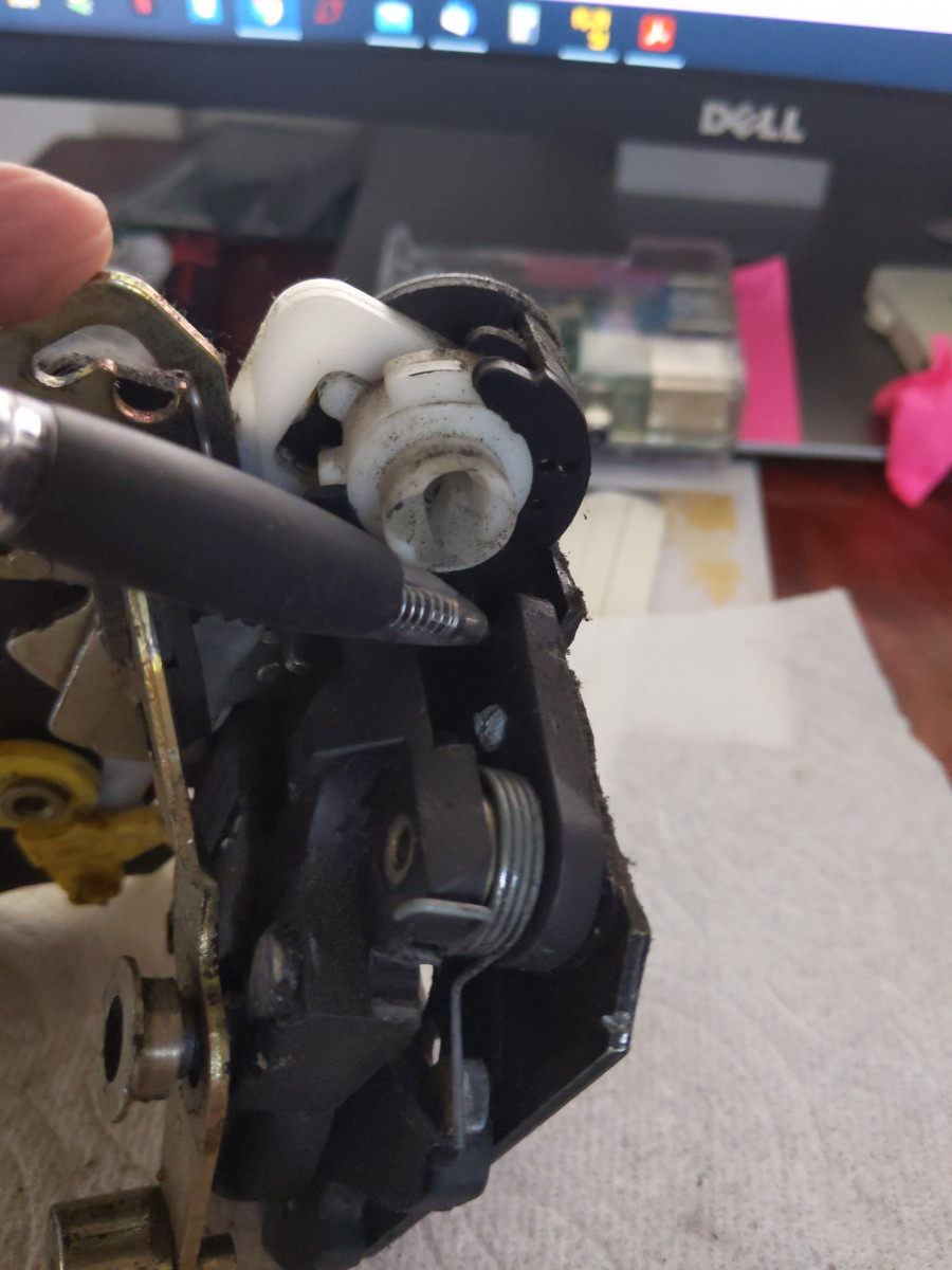

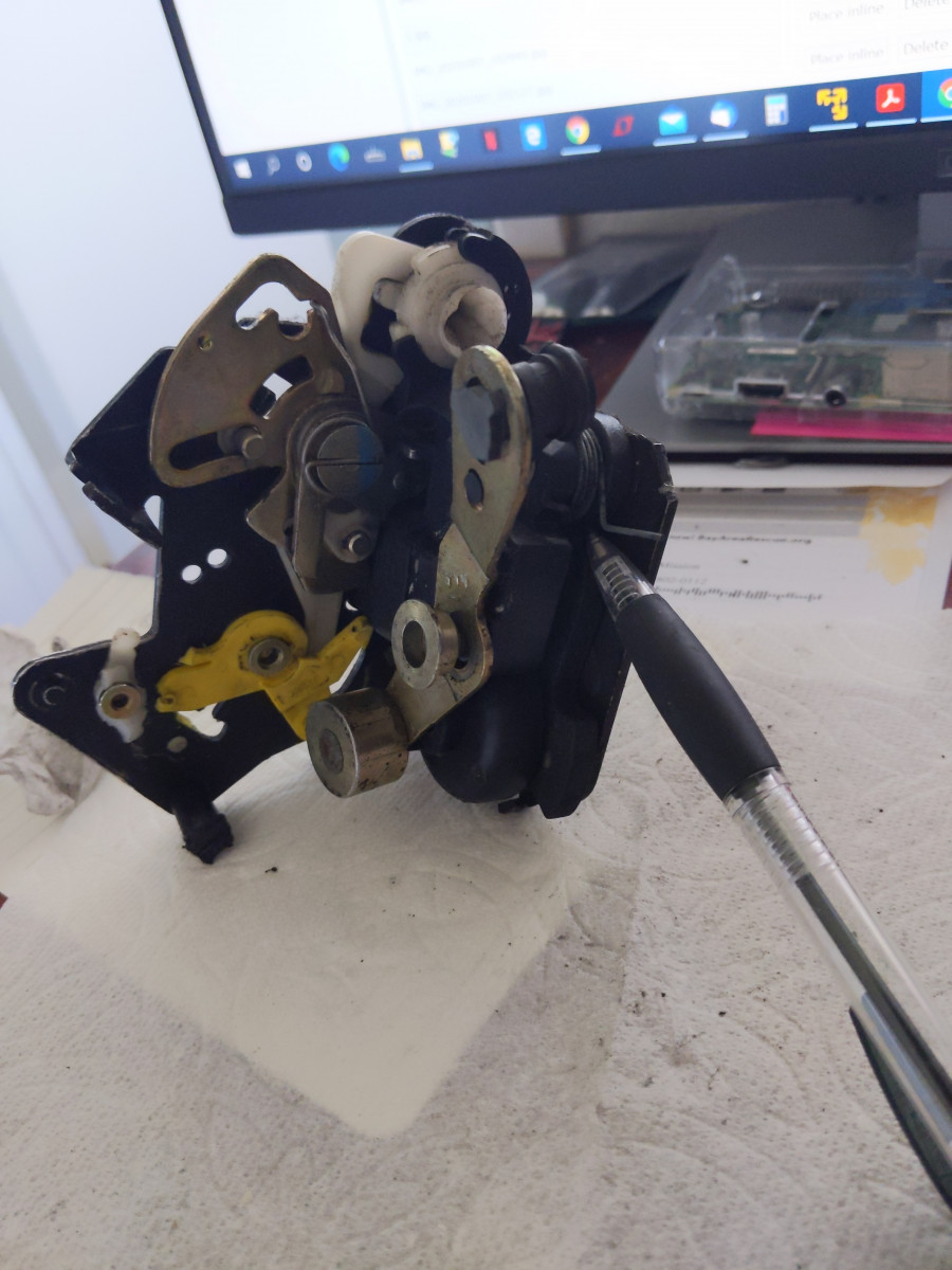

This part locks the latch. You would need to lift it up so that the latch would move. Here I have a pen lifting it up may 1/4 to 1/2 inch only.

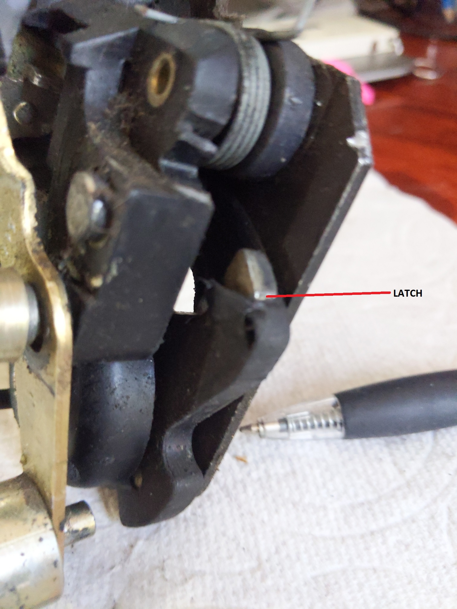

Once you lift this up, the latch would move, just push it in at the start of the red line in the previous pic and the door will open.
