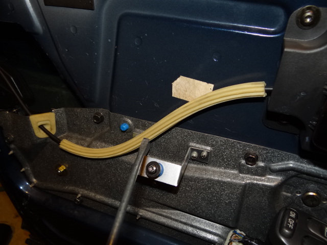

Big screwdriver and rubber mallet. break away as much of the old mechanism as you can. TRY NOT TO BREAK THE WINDOW!...**Disclaimer!!***  Roll up the window if you're nervous about it.

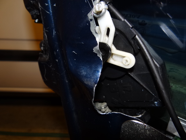

Some cosmetic damage is gonna happen to this soft metal part from all the wrenchin' and hammering you will be doing to break it off. But only you know it's there behind the panel so don't worry about it. just tap it back into place with the rubber mallet. better for you bend it than the Stealership right?

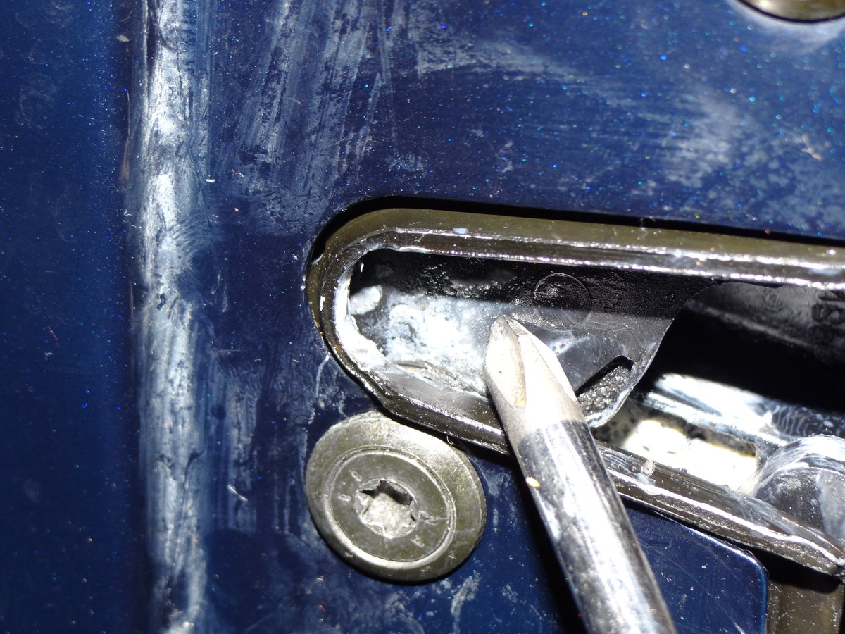

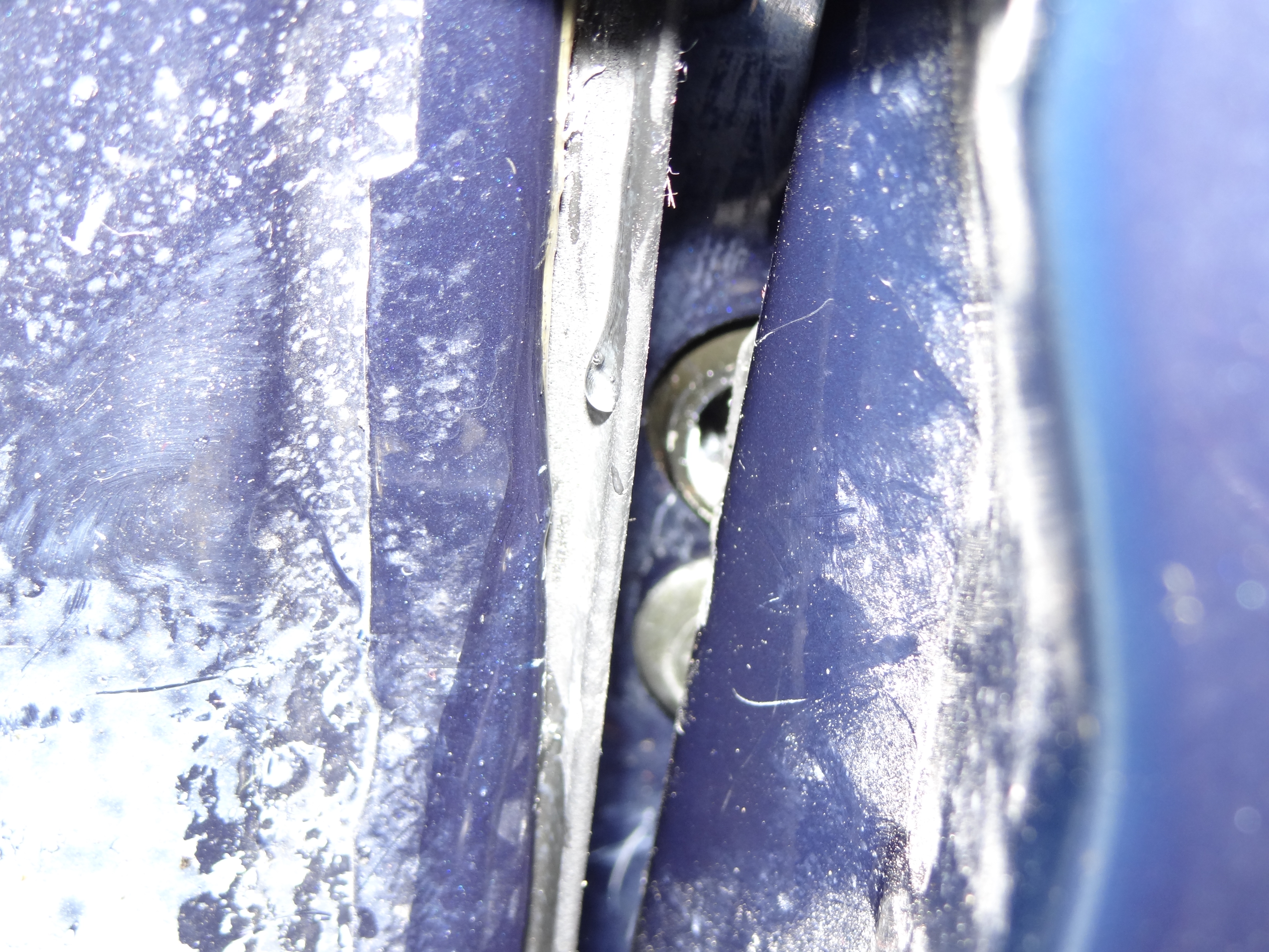

Here you can see the 2 holes in between the doors. the holes are on the rear of the driver's door. this pic is taken from the back seat behind the driver's seat looking into the door seam. ** Notice the lower hole has a torx screw in it but the top hole doesn't. That's because the top hole is not a hole, it's the actual latch. This is the part where you put in the smaller screwdriver on and BANG IT with the rubber mallet. and the door should pop loose!
And here is what the latch and second hole(torx screw) look like with the door open.

and JimBee, if you don't feel comfy taking the panel off with the door stuck, just jump down to my last step and bang out the latch from the back seat. After I did mine I thought of this as something I could've done and saved some time. worth a shot. the mechanism is trash anyway, might ast well knock that latch out and see if it releases.
FYI I read on blog that knocking out that latch IS the way the shop will do it. that's how I knew to look for those holes at the rear of the door.
