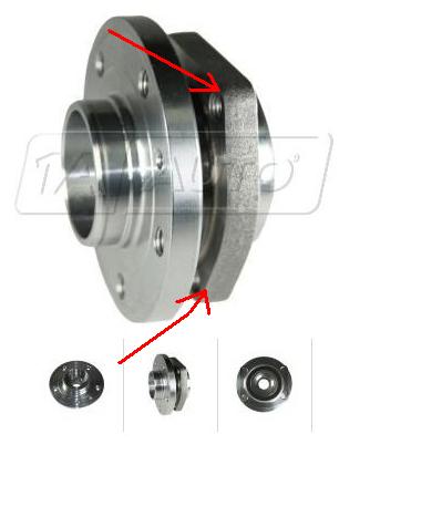

rspi,
Buy a propane torch at hardware store ($12).
For every bolt and nut that is rusted, when you heat, heat the "nut" side (see RED arrows).
So in this case, heat the bearing side, exactly where the Torx bolts go in.
Heat it for a good minute, it will be much easier to remove the Torx bolts.

cn90 and Ozark Lee highlight two critical steps before you begin.
1) clean the torx head surface fully to help the socket seat, turn using pull pressure, do not slip. I stripped one, took me an hour to file away the bent torx edge. 2) it needs counter-hold, after removing axle I hand tighten at strut, and outer tie rod for support
Bolts pass through the knuckle and screw on to hub-bearing assembly, PB Blaster overnight would do the job using 1/2 " breaker bar. The exposed 3-5 threads at each bolt may have deteriorated.
I cleaned the knuckle back to metal before putting new one.
I would align.
