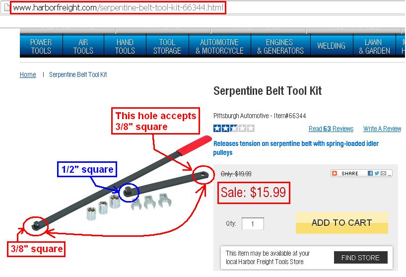

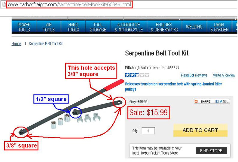

Old post but important to mention a great tool for those with serpentine belt tensioner with Torx 60 hole.
- The typical Torx 60 socket sold locally is 1/2" type. If you want the 3/8" type, you can buy it on line.
- Torx 60 socket + breaker bar will NOT fit due to tight space.
- The serpentine belt tool (Harbor Freight, ebay or other online vendors,) is a life-saver. Trust me, I use this on my 2005 XC90 and it works great. For $16, it is a bargain.
- Since this tool comes with BOTH 3/8" square (the LONG bar) and 1/2" square (the SHORT bar), you have 2 options:
1. Buy the Torx 60 socket, but buy the 3/8" type and simply use it with the LONG bar.
The problem is: local autoparts store only sells the 1/2" type when it comes to Torx 60.
So, for 3/8" type, buy online.
2. Use the 1/2" Torx 60 socket.
Note that the SHORT bar has a 1/2" square end and a hole that accepts 3/8" square.
All you need to do: install the SHORT bar onto the LONG bar and that is it!
I have used this serpentine belt tool on Honda, Toyota, Volvo, BMW, All I can tell you is this tool is worth every penny.
See photo below.
