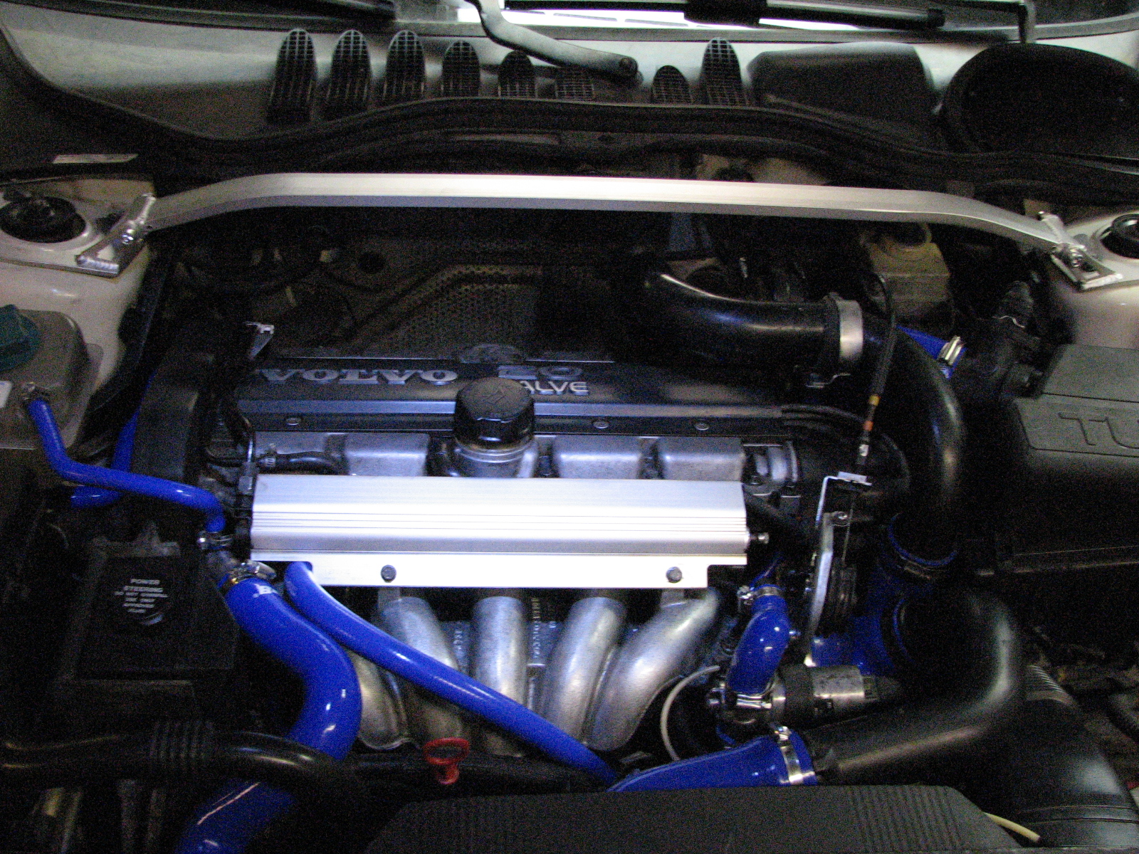

I dropped in the 628 R ECU today.
After driving it shortly last week with the 072, I did notice a difference.
Now, with the 628 unit at around 2,500 rpm while the boost is coming on, it fells like a second wave of boost kicks in for around three seconds or so. I look down and I am at 60 mph.
The fact that I changed to a 3" N/A intake manifold and 3" air intake to turbo seem to have added some quicker throttle response, spool and likely a few horsepower.( IPD says about 10 just for the air tube to turbo.)
I feel a definite difference as a result of these simple bolt ons and drop in. I believe the R ECU added something overall as well.
Now if it will only get warm out. I still have to sort out the power issue to my ECC.

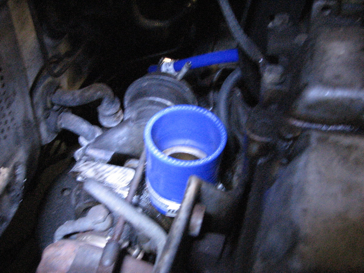

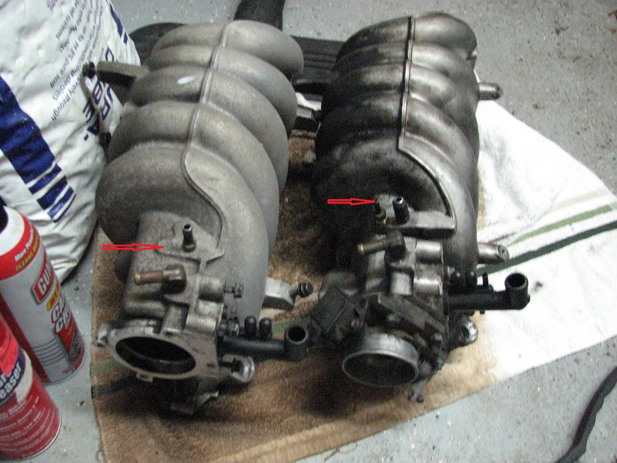

I have a comprehensive list. Part numbers can be researched.
Most everything was bolt on. The only modification needed was a tap into the manifold to take vacuum to the turbo.
I did also tighten the waste gate actuating rod two full turns while I was in the area.
I still have an exhaust manifold from an '04 S60R that I may install over the summer. If so I will likely attack those heater core hoses, and core itself. Maybe even a 19T. We will see, it is getting to be scary acceleration as it is. List of parts I had used:
White injectors.
N/A manifold from '98 S70.
3" N/A throttle body from '94 Sedan. (does not need to be year specific.)
960 N/A throttle plate.
Bosch "628" R ECU from a '96 855 R.
Aftermarket pieces would include:
Snabb 3" silicone throttle body intake tube adapter for turbo.
As a personal addition Snabb 3" aluminum intake tube from the air box to the turbo. W/3" silicone adapter hoses.
FCP sport silicone intercooler hoses.
Also added a Snabb upper IAC hose for good measure. (looks good too)
White injectors.

I already have a NA intake manifold lying around and a 960 throttle/body plate is easily attainable. Seems like a nice addition to my T5 motor/turbo/ecu swap with white injectors. Instead of tapping a third intake manifold hole for the turbo vacuum, why not just use one of the throttle body "tree" options?
So Should I use the throttle body itself from the 960 or just the plate in a 850 TB on a 850NA intake Manifold, also have you done the NA cams mod?
