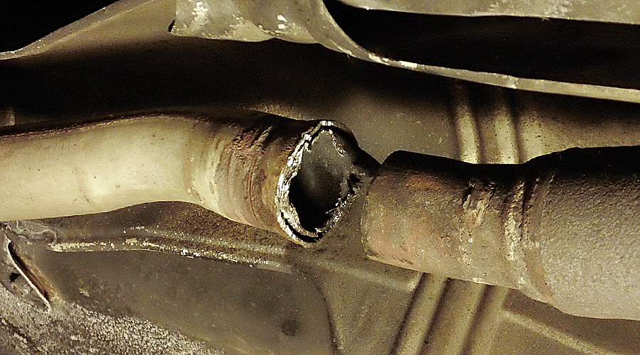

Slow progress. Here are few photos.
The coupler at each is welded. I imagine cutting the welds to remote the coupler?

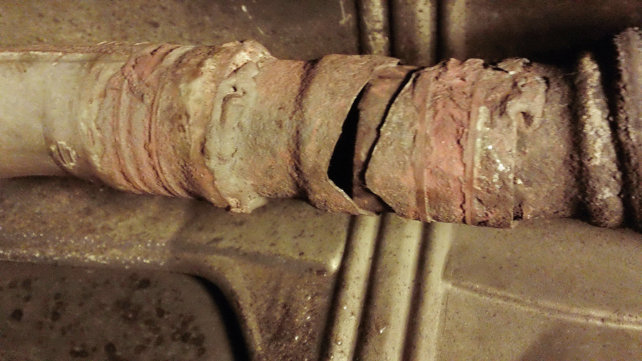

The picture shows a 10mm gap, it is a tear on old coupler. Pushing each ends upward narrows the gap.
I have raise the car further up, clearing anther two inches to work from under.
Assessing if hangers need to come down and off.
The snow storm adds to anxiety.

A frustrated afternoon with a snow dump.
Nonetheless, the coupler inside the exhaust is stubborn. I have separated the exhaust lip from the coupler layer to see if there is a weld getting in the way from sliding out.
Few photos of progress. I will files the exhaust lip before installing new coupler.
Any pointer for removing the coupler?
I don't believe this how the original installed?

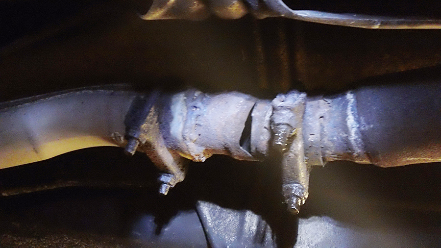

The muffler is making noise again.

My muffler problem has returned 6 month after the chain store's welding.Ozark Lee wrote:I replaced a Bosal on my son's car. The pipes were pristine but the muffler itself had rotted in half and the hanger arms rusted off of the body. The back pipe can be repaired with a chunk of tailpipe, a coupler, and a couple of clamps. [...]
The pipe diameters will vary depending on what kind of muffler you have now. I left the Bosal pipe from the joint between the catalytic converter to the muffler but it was a larger diameter than the stock pipe so I used an adapter coupler.
...Lee
The new Bosal is $25 cheaper than the OEM Starla $223.
I would prefer using clamp connecting it at CAT.
Who would know if Starla is a perfect fit, and my CAT is full length -- not trimmed by the engineers at Midas?

The picture below from february repair shows CAT at right -- would it work?
