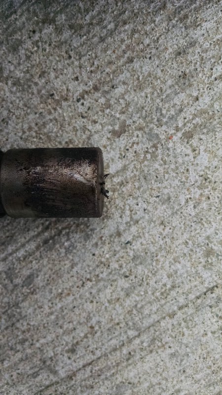

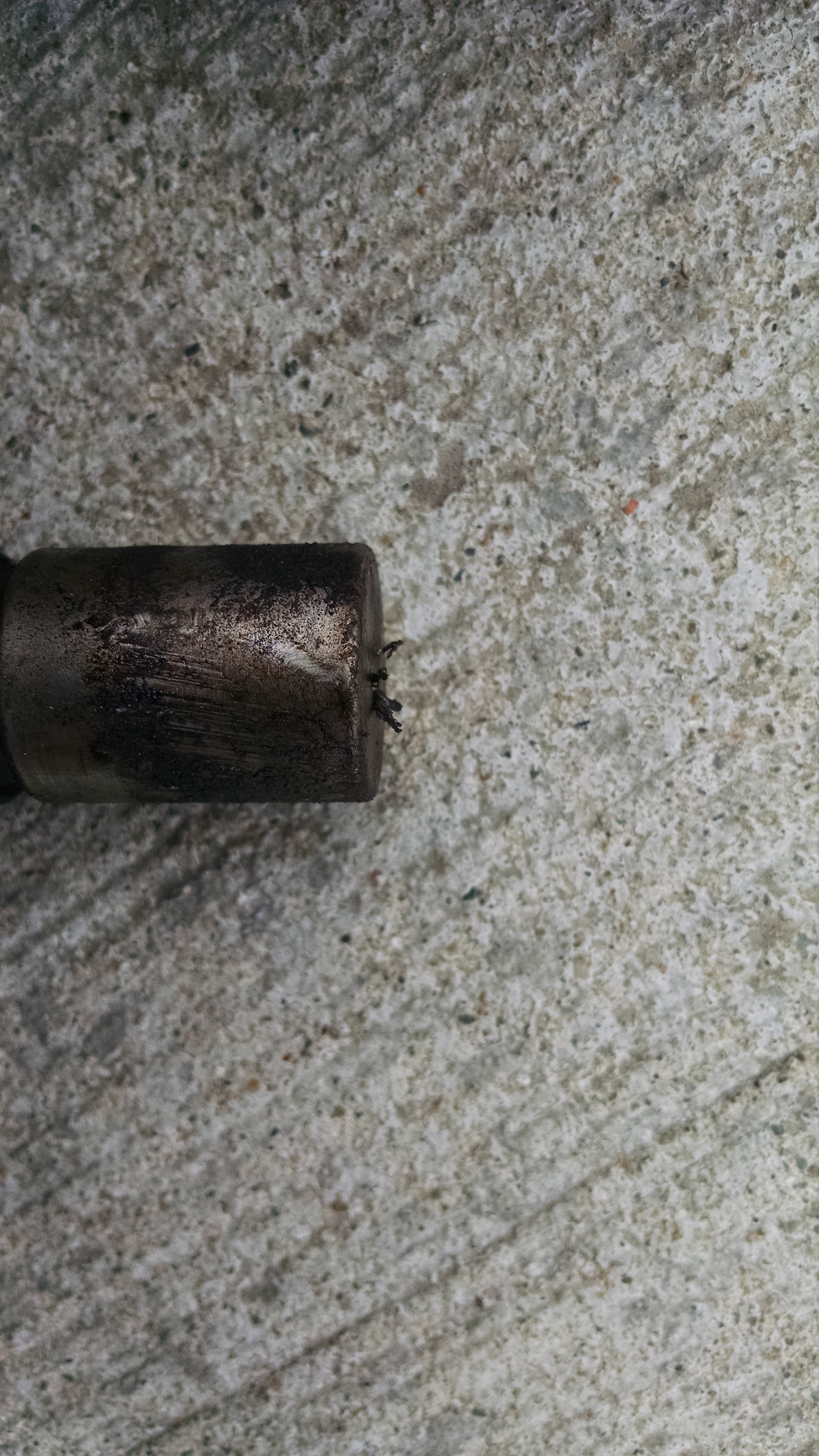

I wasn't sure what was going on, but I still had the cam and crank sensors to replace. So I started that. Both looked ok, but I did notice several small pieces of metal stuck to the crank sensor. Im hoping this is the original problem of the random misfire, but time will tell.

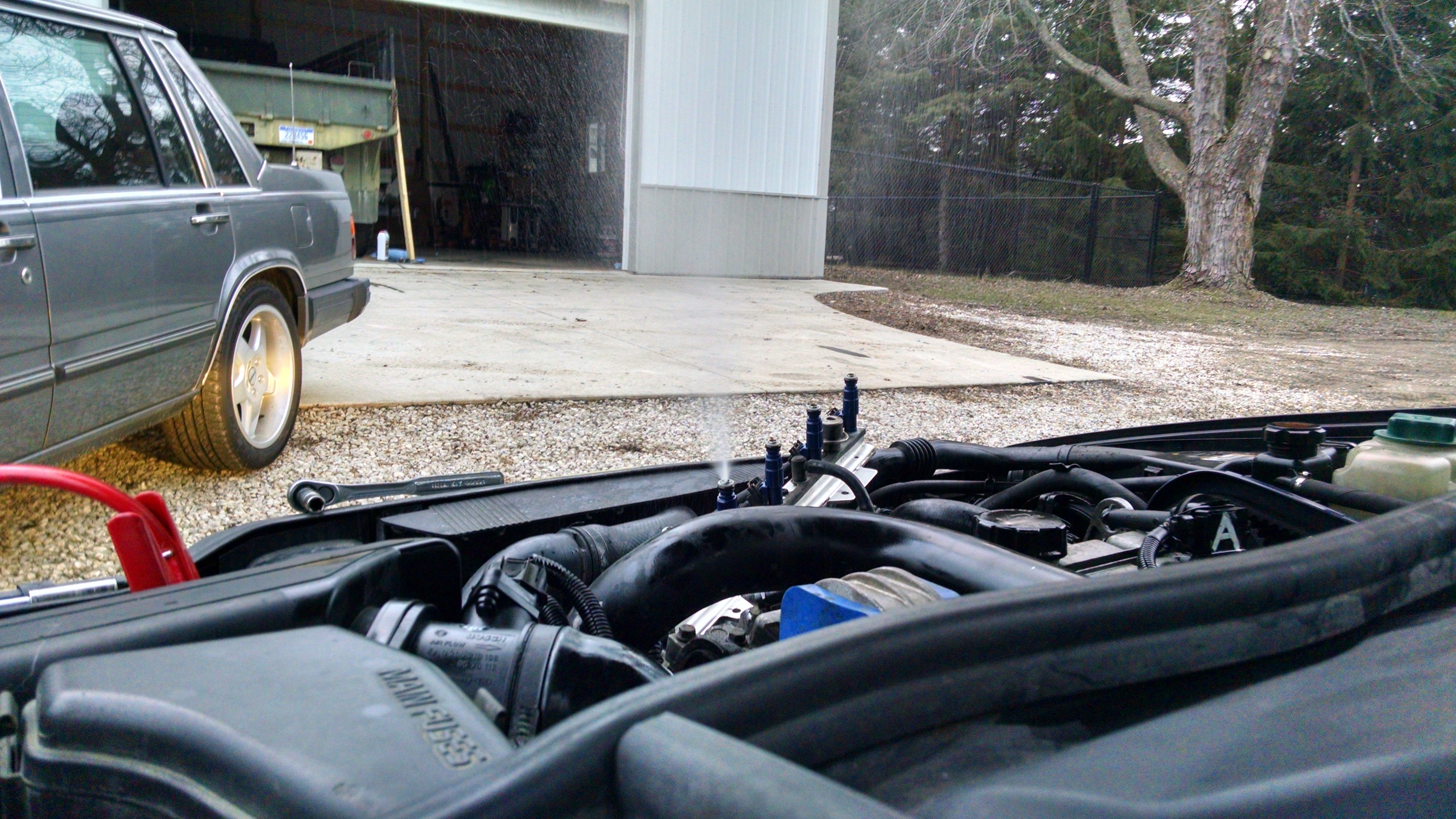

Back to the problem at hand, I buttoned everything back up and tried to start it. It acted hydrolocked. I pulled all the plugs and turned it over. #4 cylinder wouldn't stop gushing fuel. I next pulled the fuel rail. #4 fuel injector wouldn't stop spraying fuel, even unplugged.

I think I can say the root cause all along was metal from the starter gear/ring gear getting stuck on the magnetic crank sensor.

Yeah, it's not hard to check. One bolt holds the crank sensor in. It's just a matter of knowing it's an issue lol.Wow, that is a weird issue if that is indeed the root cause. I'll keep this in mind when I have to tackle the misfire on my 'R'.
But it's still working perfectly, so I'm 99% sure that was the issue.
