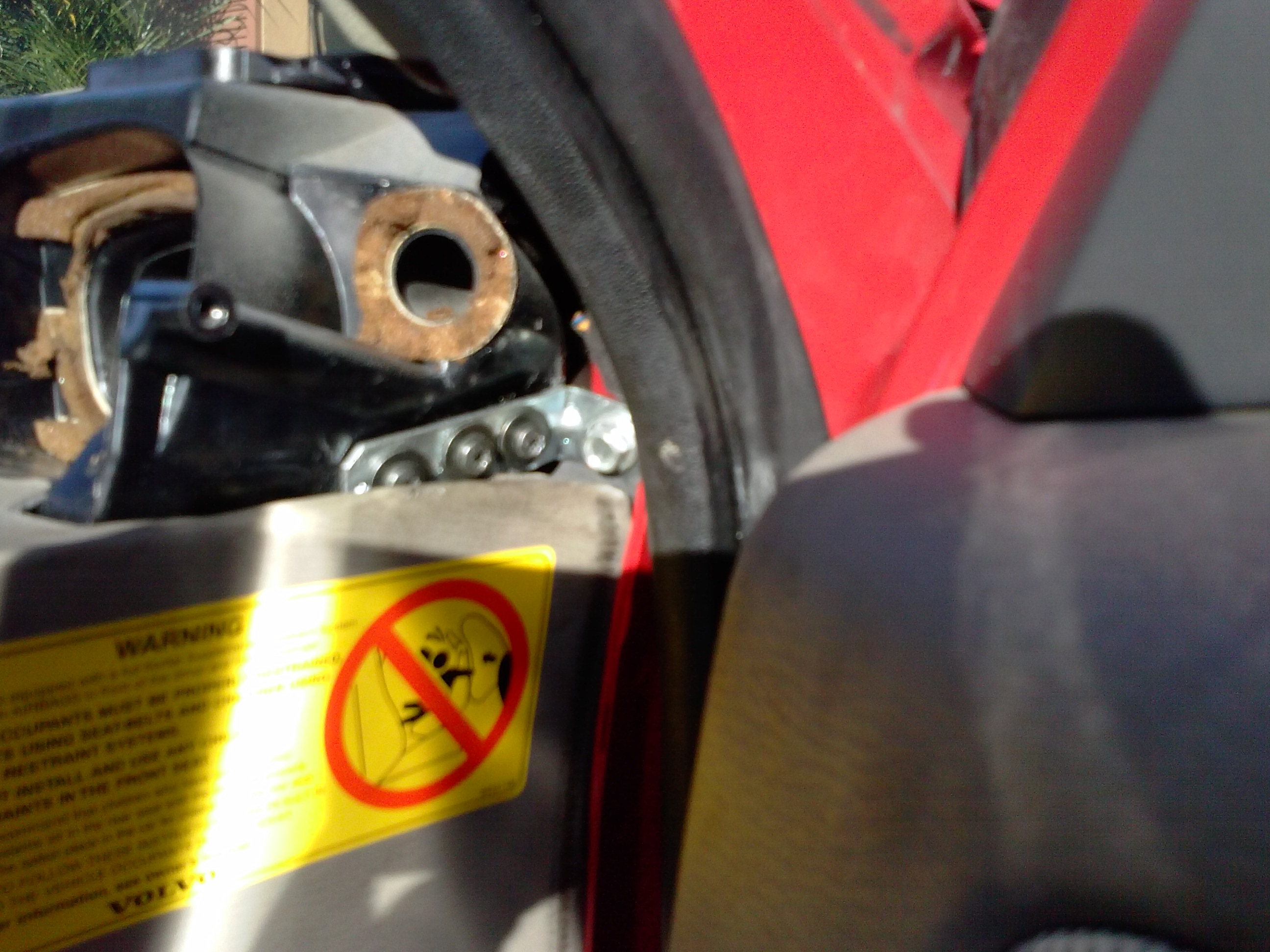

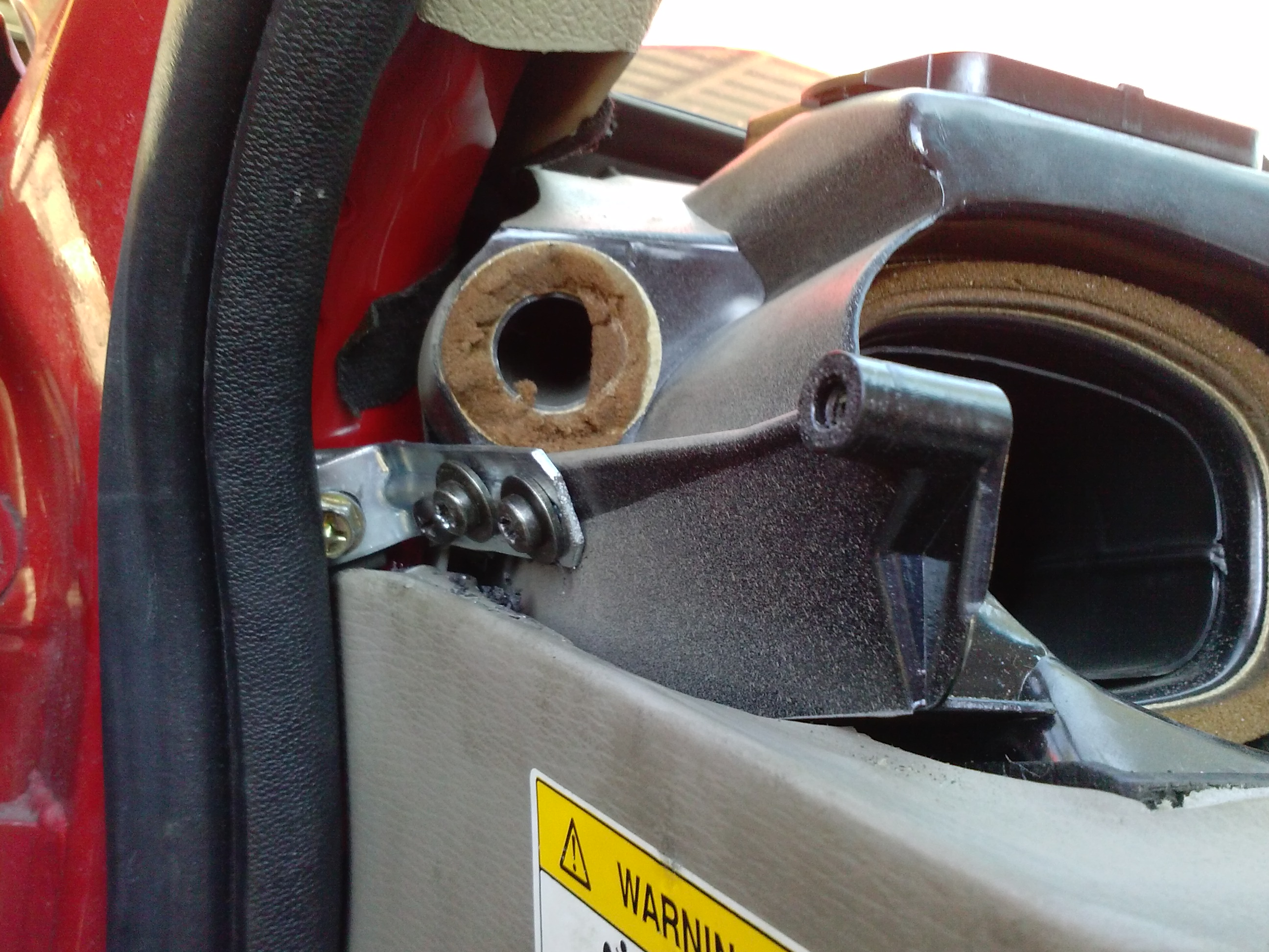

Today I made some side brackets for the T5 and despite the sides being secured, the center mounts were rattling again. So back to square one I decided to foam the perimeter of the windshield with the dash with that Home Depot stuff. Well, sprayed the foam in different spots and 80% of the noises are gone except a light tickig here and there and a vibration noise when stopped at a light unless you shift to neutral. Anyway back at it with the foam this time filling around those two areas and I'm hoping this time I won't need it anymore. I will update tomorrow on how it went but for now, here are my two side brackets:
