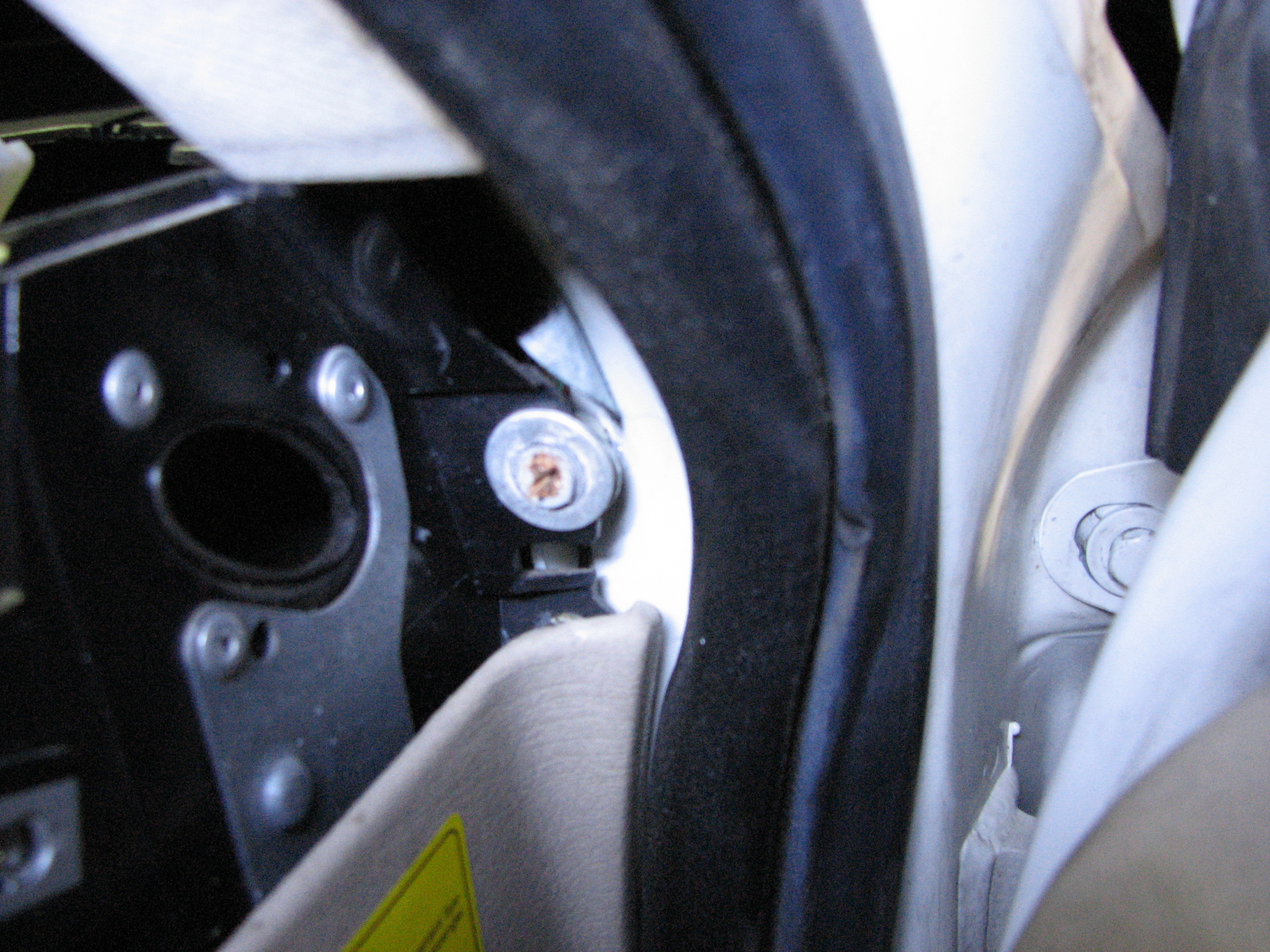

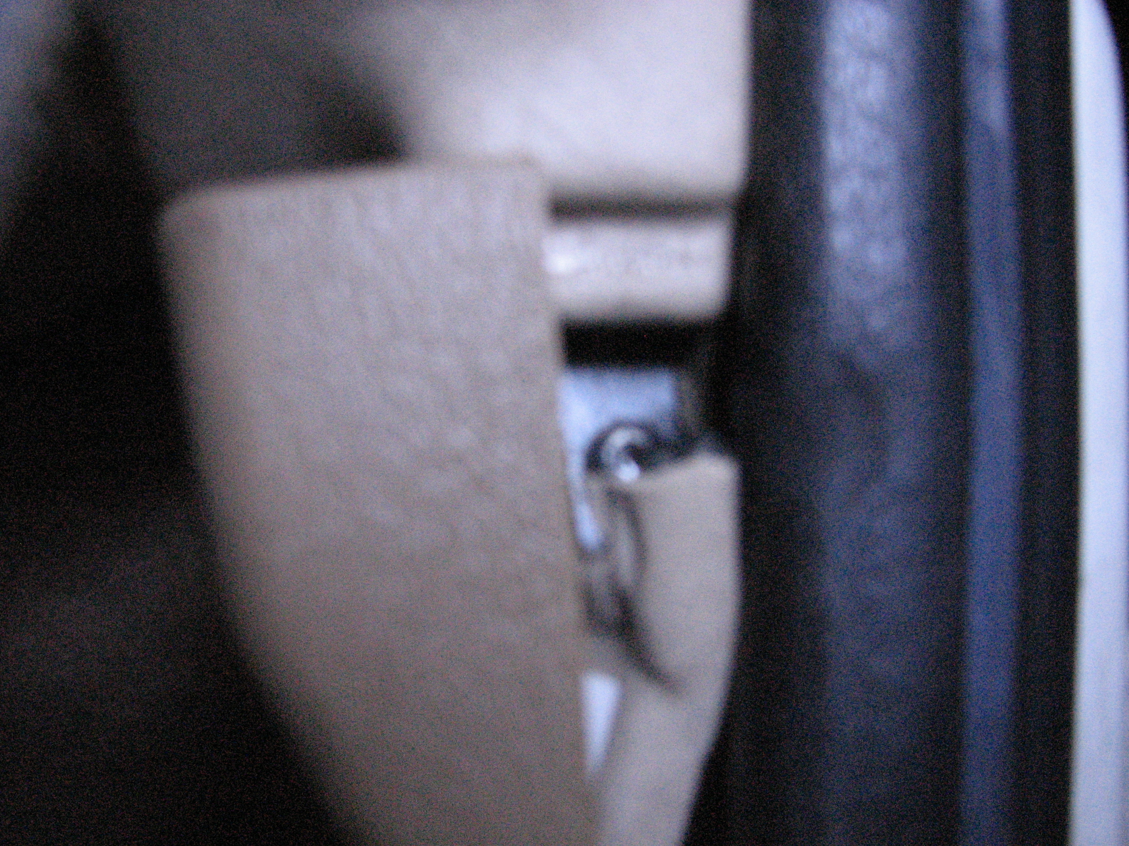

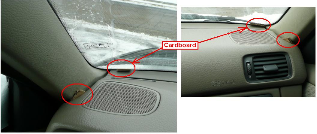

1. To test the theory, I installed some cardboard as shown and sure enough, the noise is gone:
2. All you need is "Butyl Rope", the stuff auto glass shops use to attach windshield glass to older Chevy Ford models many years ago. You can buy them at local glass shop for about $10 for a roll of 10 feet or so. This is in fact used on other parts of the car (vapor barrier etc.), so you can use it for other jobs too.
3. On both sides of the dash, at your shin level, there is a Torx screw. Tighten it.
Then apply a small bead of Butyl Rope as shown:
Easy peasy, noise is gone...

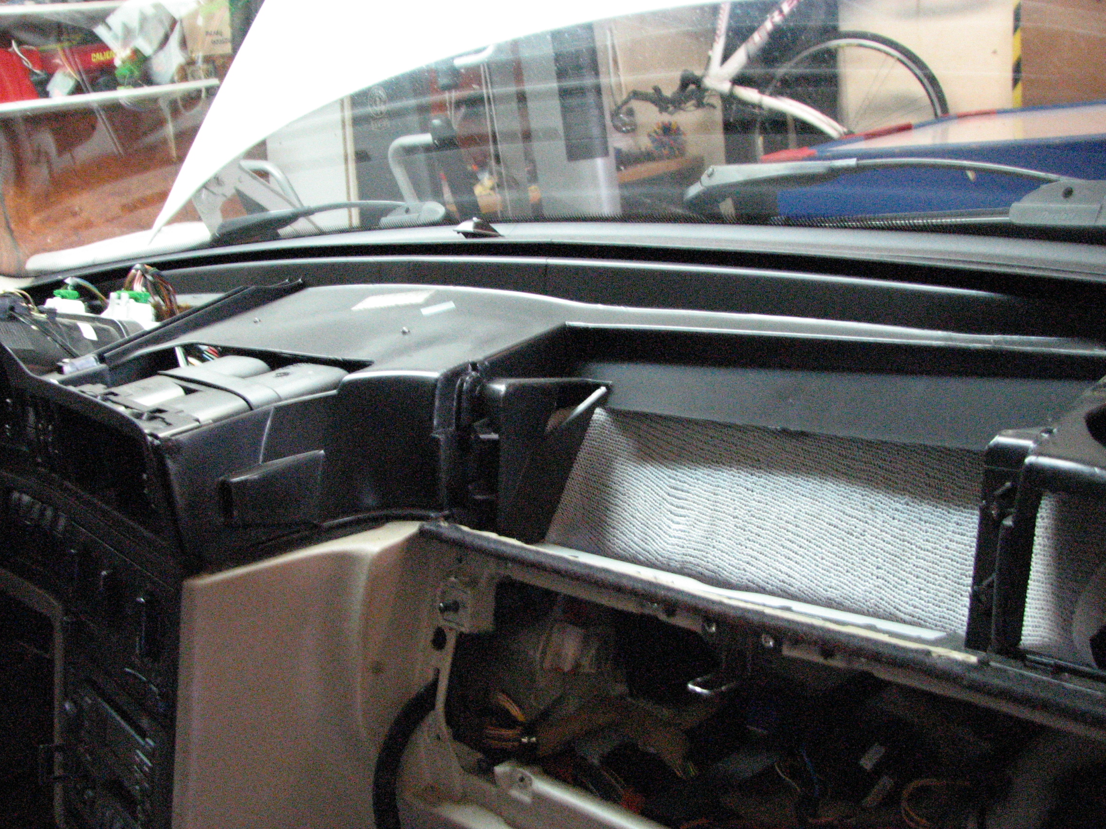

I had the dash pad out of the wagon to pull the instrument cluster and replace the odometer gear, so I took advantage of the opportunity to help out my sagging, bouncy dash.
Passengers side Where cn90 pointed out the torx screw, I removed that screw and lifted the whole dash almost an inch. I then drilled a new hole at that point and screwed it back in.
Then at the topside of that same metal bracket that holds up the dash I drilled a completely new hole in the bracket and straight into the door jamb area at the A pillar. I used washers to space it correctly as to not pull the dash too tightly and contorted out of its original position.
I repeated on the other side and the dash is now quiet and motionless.
I still plan on doing something at the firewall when I am in that area again.
