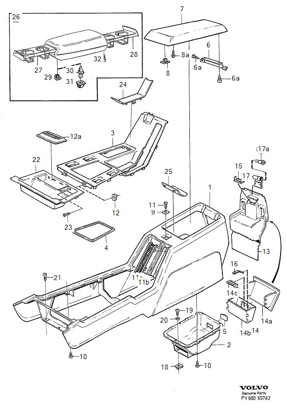

Between you guys helping me in this thread and emailing Lucky I've got most of hard stuff figured out. A few hardware questions remain, however. First up is a question about the leather shifter cover and the center console trim.
In this diagram parts 3 and 4 seem to hold the leather cover down. If I get part # 4 can I use my existing center console (part # 3)?

The console plate (#3) is different. That plate will swap between the earlier consoles (pre '96) and the later consoles (96 and on) with a minor modification to top portion below the armrest. The plate is tough to find if you have woodgrain trim.
