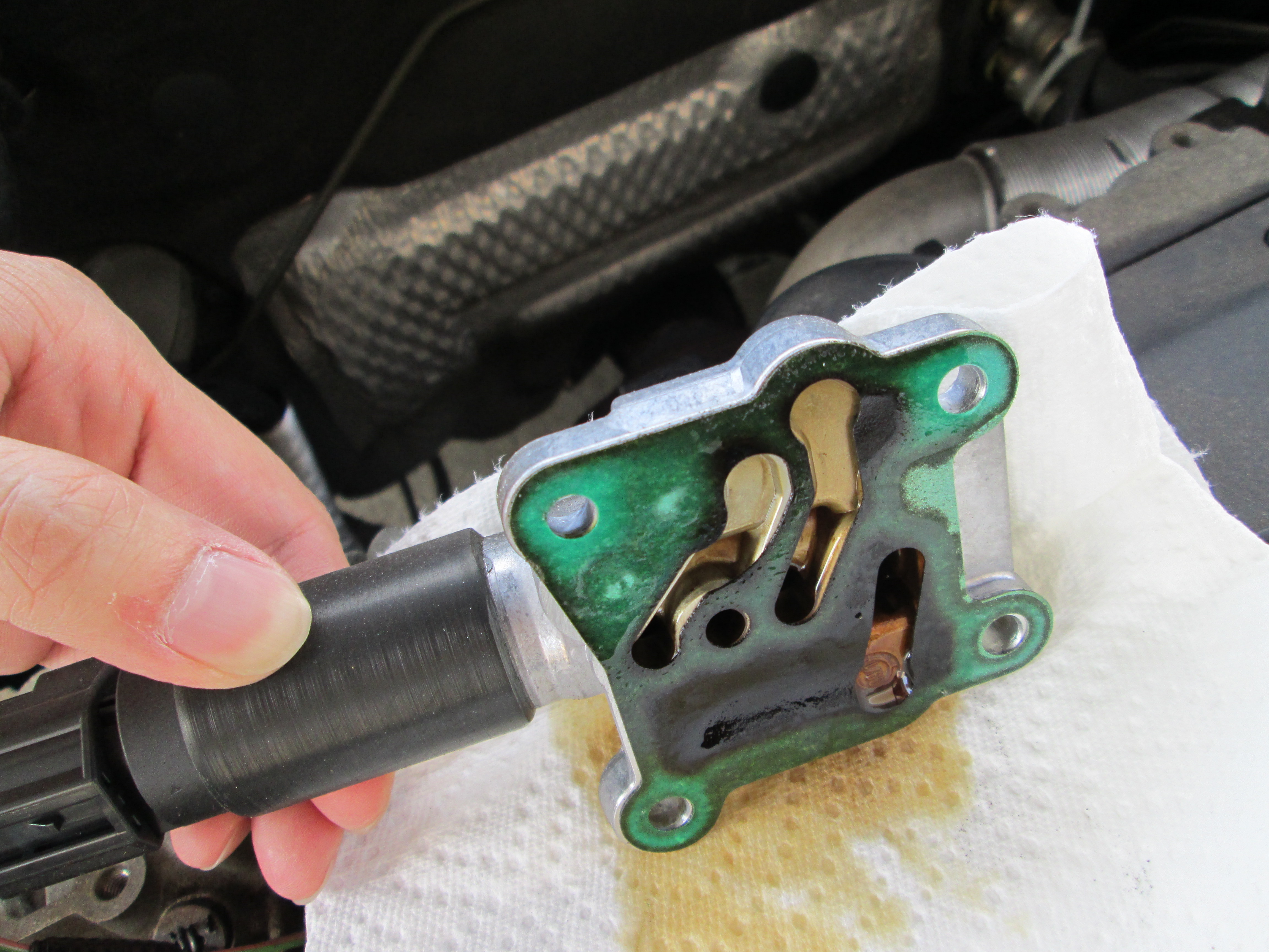

For P1671: Cleaned the cvvt solenoid with engine degreaser. Didn't really see sludge except for a little bit in the outer channels (the center hole where the new wire mesh hole is, was clean). Degreaser didn't really take of the oil, I did let it soak for 15 mins per the instructions first before rinsing it off. Will try checking the ohm next. Never really used a multimeter; do I test the ohm by just placing a needle on each pin?

Resolved. Replaced the cvvt solenoid with a used one, took away the pending code. Cleared code with reader and now free of codes. Thanks for your help guys. Now all I need is to get a smog check.
