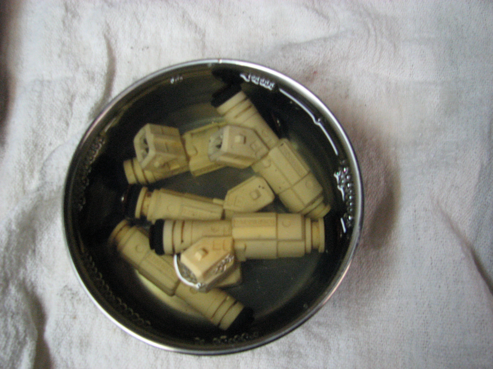

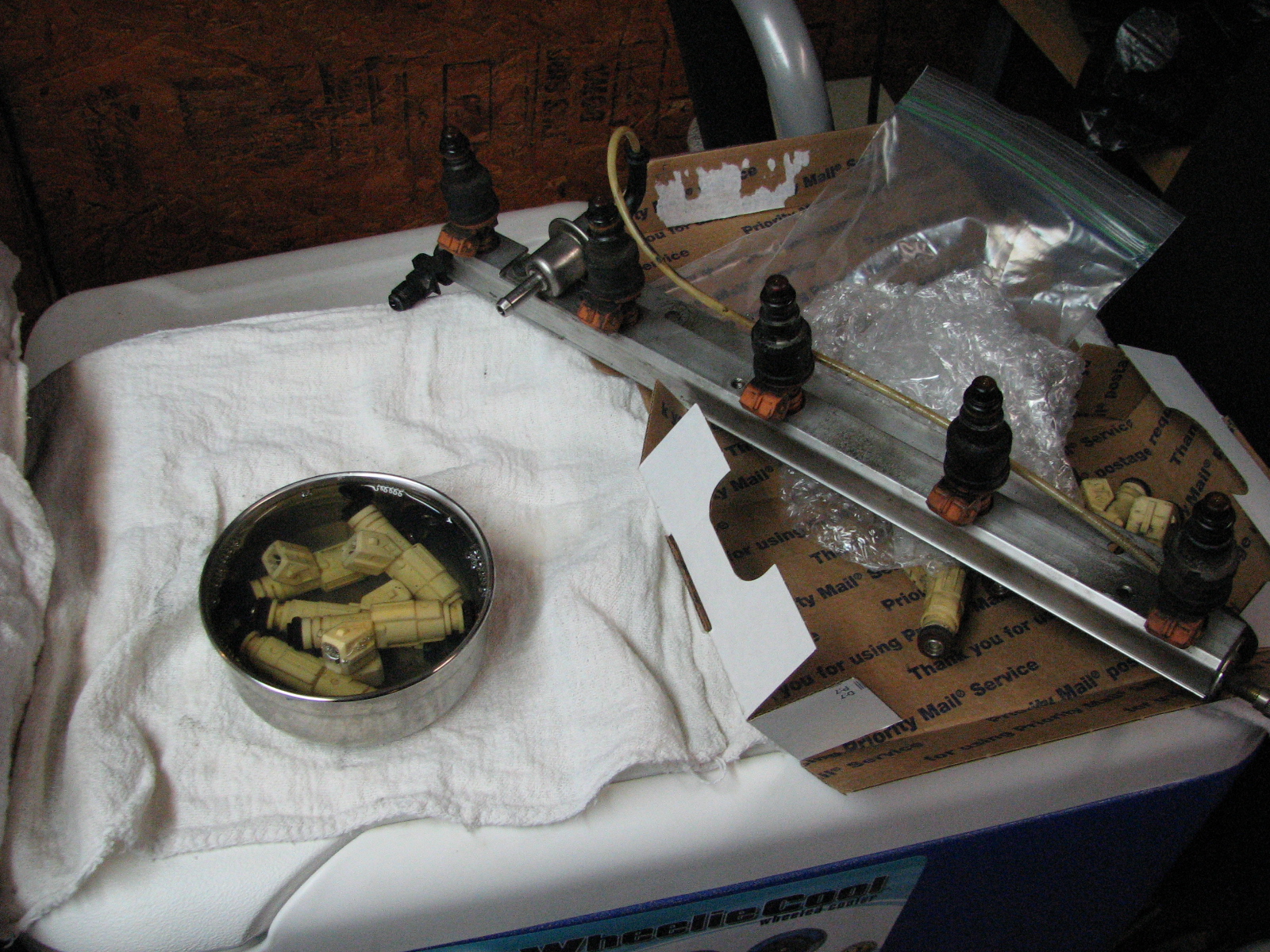

Do not be afraid of different injectors. The ECU learns quickly and adjusts. Of course it will not be an illogically different sized injector.
I had changed my '96 turbo oranges as pictured above, with whites. The ECU will adapt to the flow rate without a problem.
The other Rail on the "Bench" This was the guys weight bench in the garage I was using.
Whites taking a bath.
My point being, as long as your MAF is good I have seen things fall into place with no problems.
I had changed the injectors in my '93 n/a to y/oranges,(Yellow orange from a '96 n/a.) and they also took all of five seconds to figure each other out.

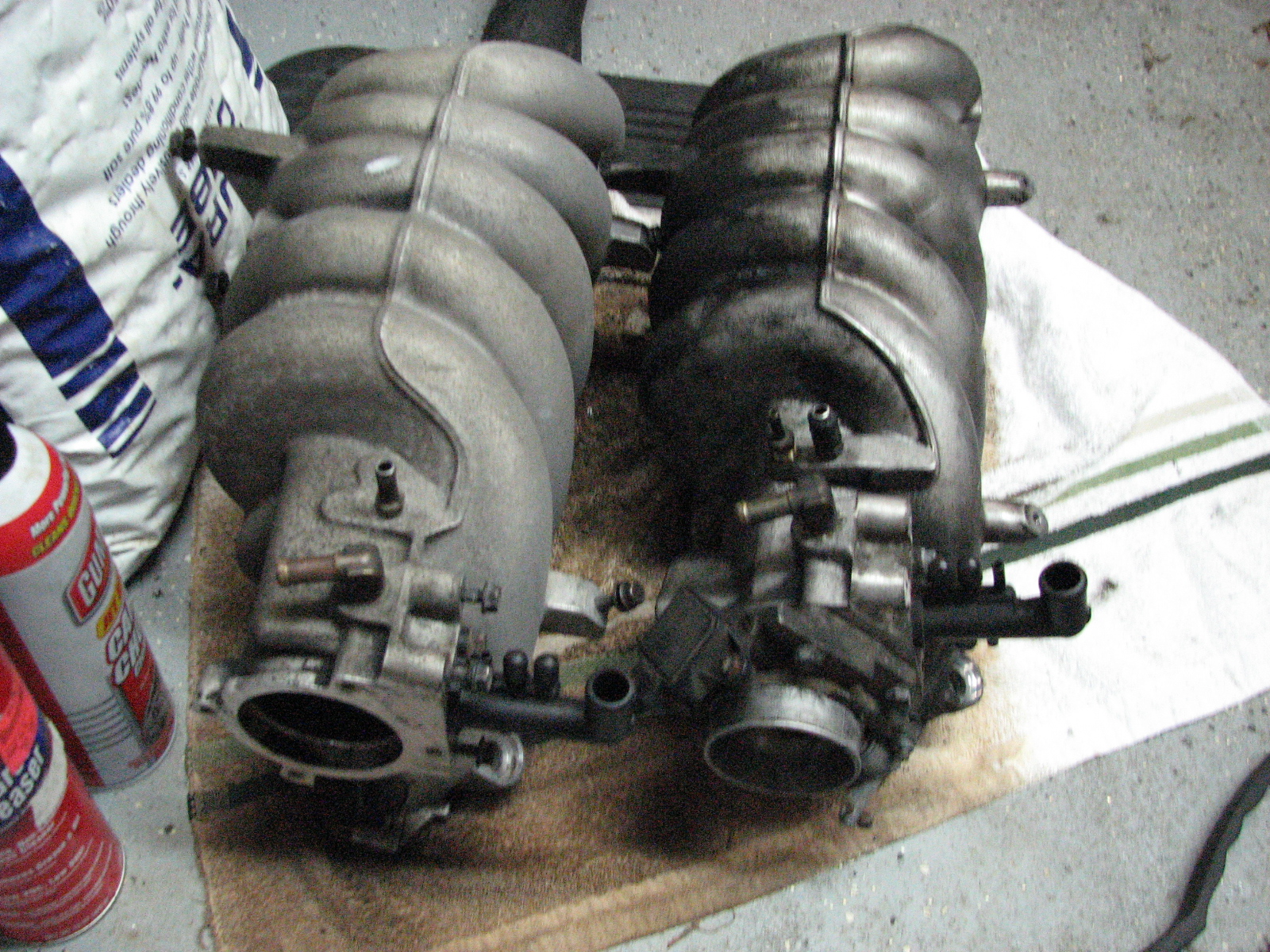

I had also changed the intake manifold to a 3" n/a throttle body. Also a 3" Snabb air tube between the MAF and turbo.
N/A manifold on left. Substantially larger, even without the throttle body.
I know it learned quickly because it started on the first turn of the key, went to a slightly rough idle for no more than about 3 seconds, and then flattened to a perfectly smooth idle and threw no CEL.
