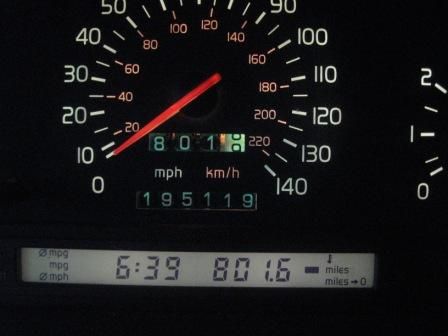

hi esl, let me answer:
my mechanical trip meter: 073.3 (3 digits/kilometers with 1 decimal/100 meter white background)
my digital trip computer: 80.1
my current mechanical trip meter: 73.3
my current digital trip computer: 80.1
so the trip computer runs 9.3% faster
Thanks!
hosting image
esl_97_850_T5 wrote:1. I'm inclined to think you have the same problem that dairyqueen814 has -- digital Trip Computer trip odometer is reading ~10% higher than mechanical trip odometer -- regardless whether it is 9-10% or 10-11%.
esl_97_850_T5 wrote:2. My car has:
- a mechanical trip meter that has 4 digits representing 0.0 - 999.9, where the last digit has a different foreground/background,
- a mechanical total mileage odometer that has 6 digits representing 0 - 999999, and
- a digital Trip Computer which has 4 digits (and decimal point < 1000), representing 000.0 to 999.9 then 1000 to 9999.
my mechanical odometer: 096455 (6 digits kilometers)esl_97_850_T5 wrote:3. What does your mechanical total mileage odometer say? Is it also down in the 50 - 100 range or is it up in the much more normal 50000 - 400000 range?
i don't know, i got this car used from previous owneresl_97_850_T5 wrote:4. Do you have a brand new instrument cluster in the car?
esl_97_850_T5 wrote:5. If you have a new cluster, have you considering having a Volvo dealer to program it ****BEFORE**** you reach the 100 km mark on the mechanical total mileage odometer?
i'm reading it nowesl_97_850_T5 wrote:See the Blockpartie comment in this volvospeed post where he identifies 2 situations in which a VST or VST-lookalike device can program the instrument cluster. Also, you might check my 2 posts, before and after Blockpartie's post.
yes i have the bluetooth elm327, and i'm reading the url now, will get back to you as soon after i try it.esl_97_850_T5 wrote:6. Do you have an ELM327 device? Can you read ECU 51 B901 through B90E a) preferably by using volvo850diag downloadable via volvo850diag.zip, or b) manually, interactively via the list of commands/requests at ELM327 commands to read Volvo 850/S70/V70 ECU 51 DTCs and B9nn data? I would especially be interested in knowing how your B901 - B90E values differ from previously encountered values to see if there's something in the ECU 51 B901 - B90E differences that could explain your and dairyqueen814's ~10% higher readings from the Trip Computer odometer vs. the mechanical trip odometer.
Thanks!
hosting image
