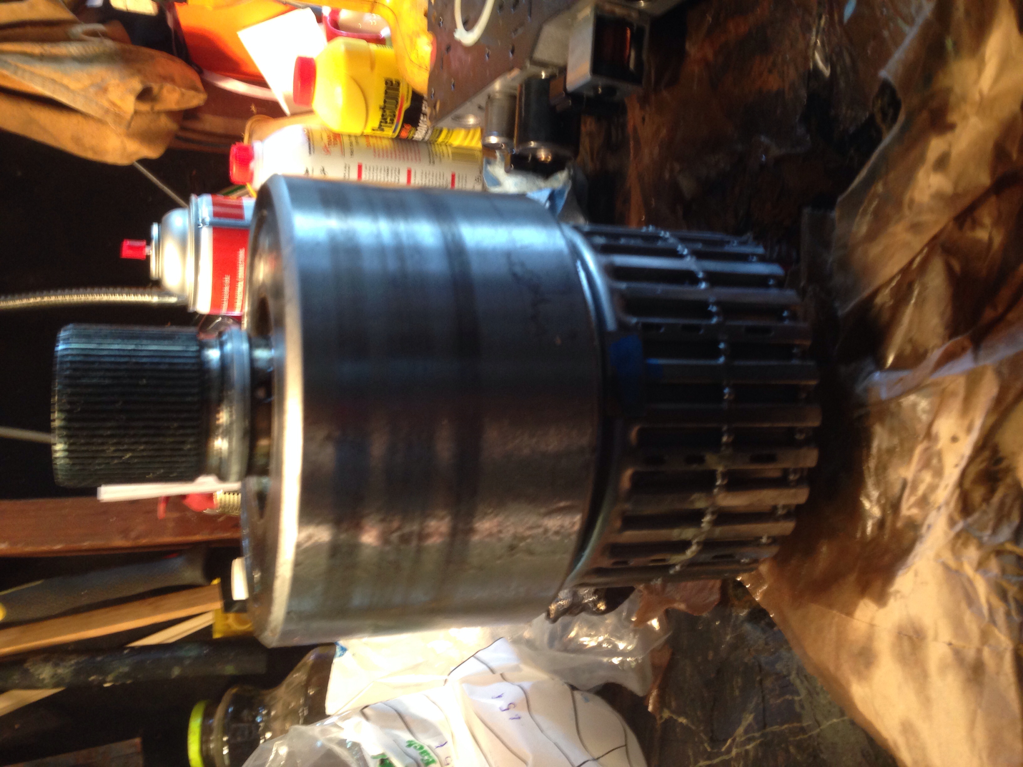

A couple more pictures left out of my original post - Oly
- Input clutch, 3rd gear clutch, 2nd gear clutch and apply drum all standing on top of the sprag and short splined shaft to engage the planetary all assembled as one stack for installation past the installed reverse band. Remember that all of the rebuild manuals / videos assume you have the transmission out, in a fixture and facing down for this procedure, which I did not. Lining things up otherwise is very difficult so I used this method.

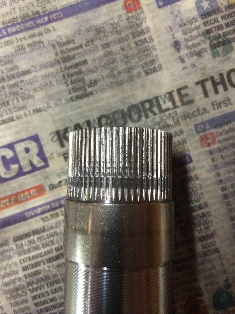

I joined the transmission rebuild party - but have removed the subframe and gearbox from the car.
People comment on how hard the turbo oil drain pipe seals are to replace - it's a lot easier without the gearbox/subframe in the car
Disassembly of the transmission was pretty straightforward, my 3rd gear clutches aren't as bad as Oly_850's but not far off. The 4th gear splines are worn as expected and the forward drive band broken. Virtually no wear on any of the remaining unbroken bands/clutches but I'll replace them all anyway...
The reluctor plate has a loose pin which is not good so will replace it.
2 of the 3 M8 valve body bolts were extremely tight as expected and the torx 30 bolt down the bottom resulted in my torx bit shearing off. The M8 bolts have shallow heads and like to round off despite using a 6 point socket and care.
I was blown away by the various levels of tightness (or not) for all the transmission case/valve body bolts - no signs of previous activity in there but I think whoever put it together didn't give a damn. Surprised it didn't leak like a sieve and not surprised it failed.

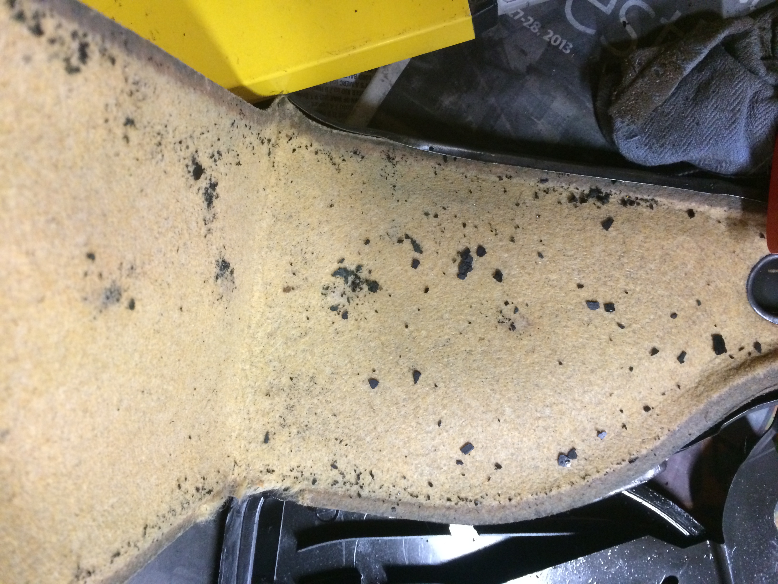

When I first got the car I flushed the transmission and replaced the filter but despite this, there was a fair amount of black clutch material in the torque converter (still trying to flush it out), in the valve body channels, the trans cooler in the radiator and as a post mortem of the filter showed, in the new filter. Any of this clutch material could jam a valve causing an issue resulting in the trans needing to be dismantled again... Torque converter (FMVV for T6) - has 6 bolts for attachment rather than 3 bolts for GM motors.

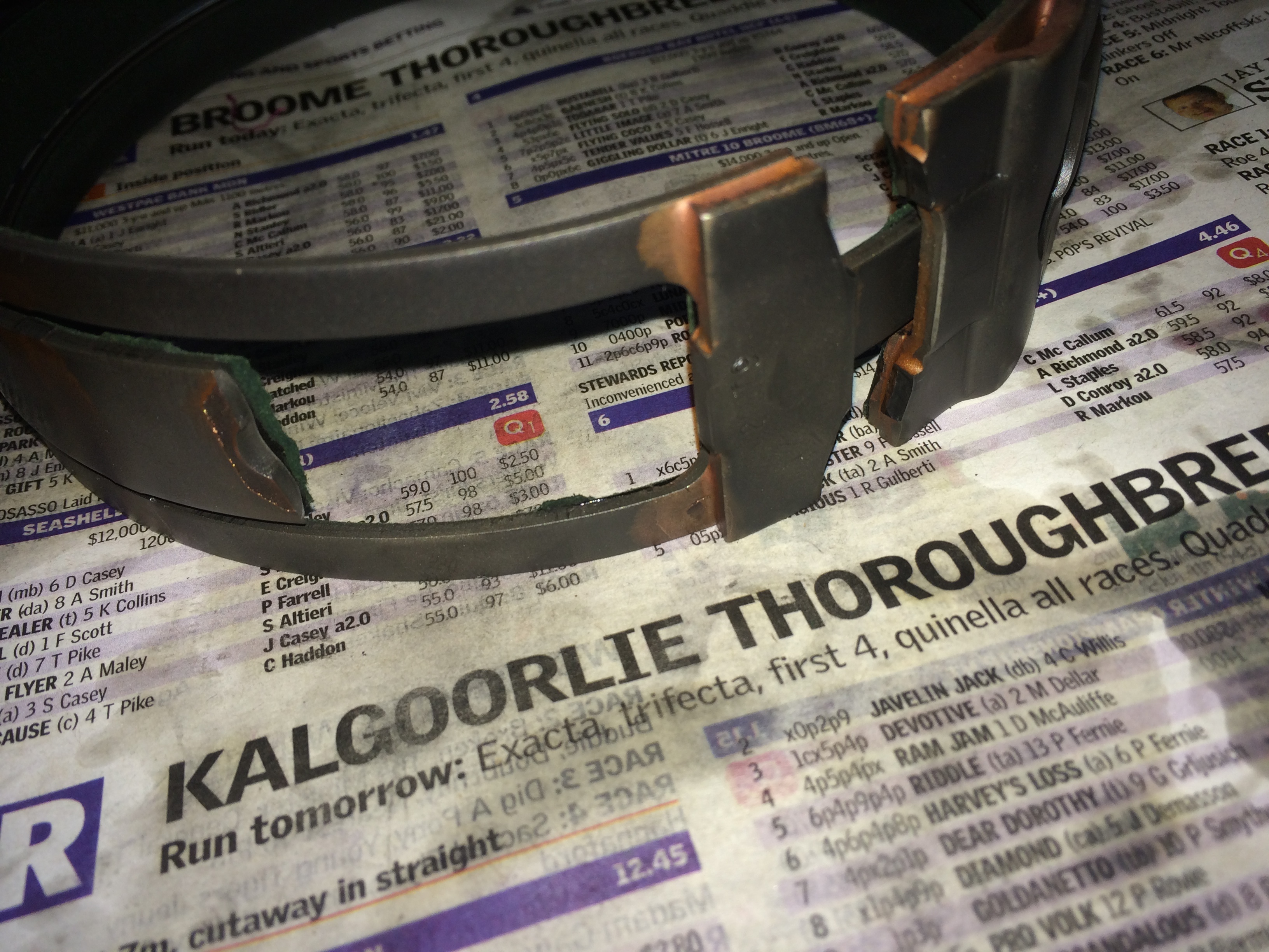

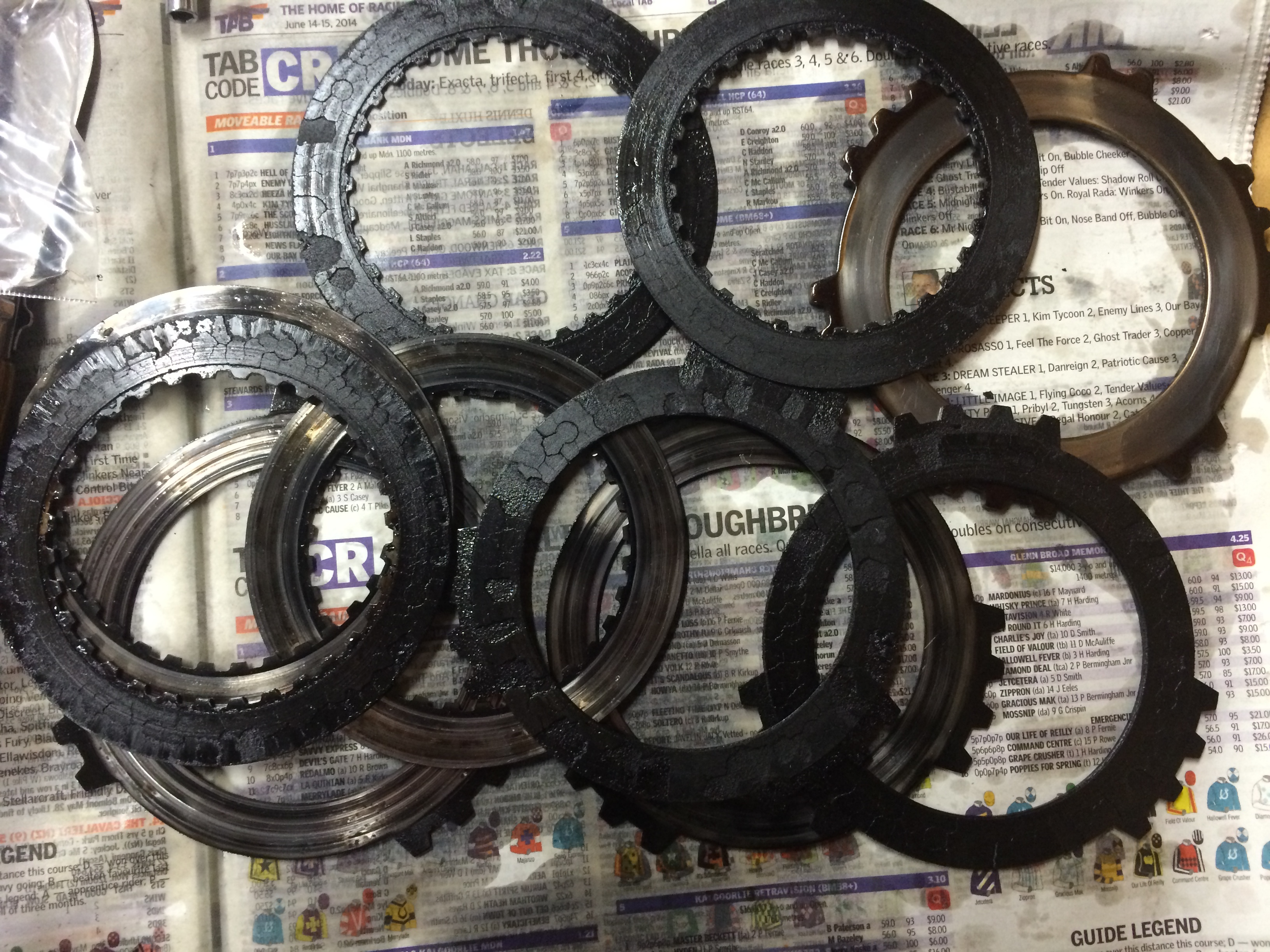

A few pics of some of the dodgy bits from my transmission:
The 3rd gear clutches (they're toast): The 4th gear hub (partly worn - you can see the band of wear): Finally, the forward band which failed (sorry, can't find the missing bit):
