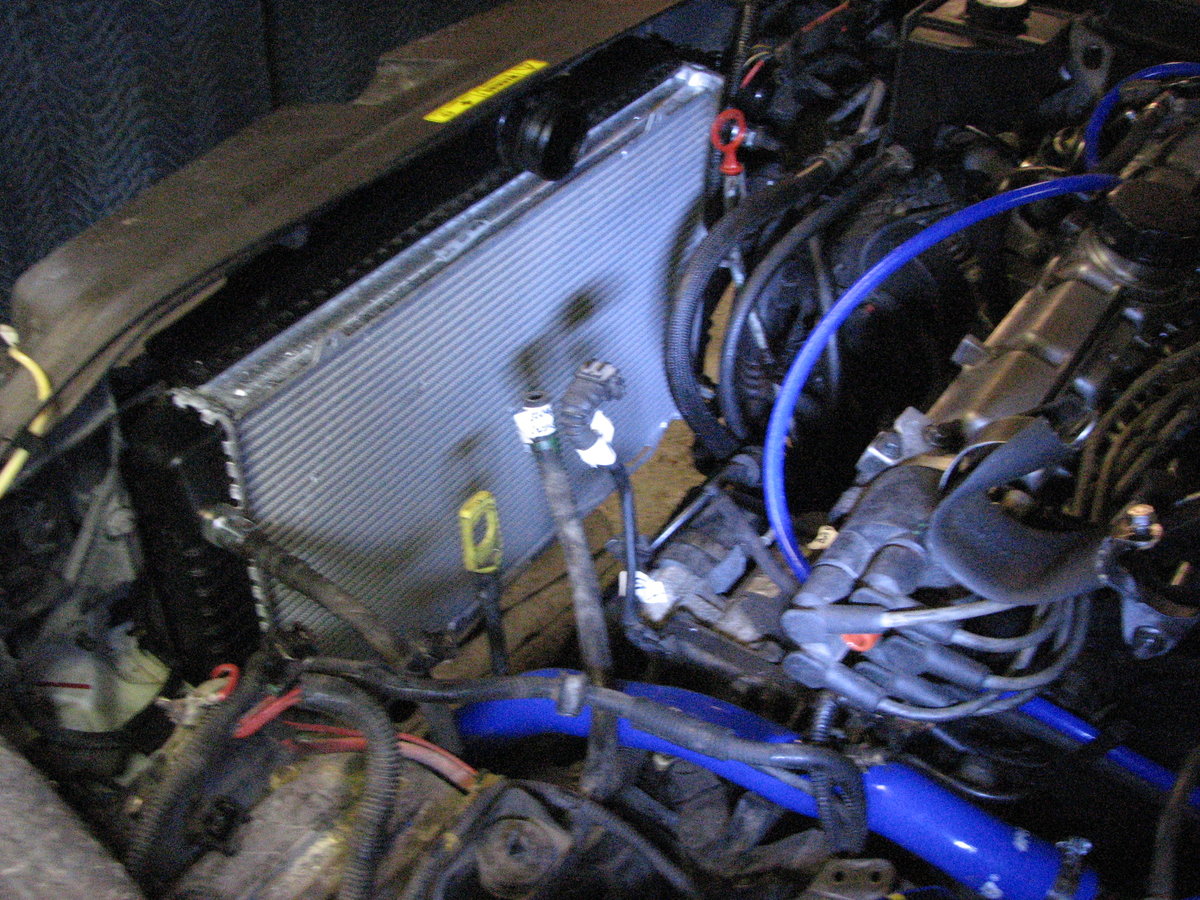

I went with the Nissens in my Turbo wagon while I had most of the engine compartment apart.
It was 17 degrees below zero out side and I had limited time to use a friends garage. I had seen some drips at the tank seems.
It was a little expensive, but I needed immediately and they were able to do it for me.
FCP was able to over night the Nissens and I was/am impressed with the fitment. The fittings were perfect for the turbo, and the trans lines. The a/c condenser and intercooler bolted up to it with no problems
I also notice it seemed to have wider cores in the center which can't be bad. I also replace the thermostat and temp. sensor.
Everything heats up and stays right at 3 o'clock.
6 Months later and it seems great.

Ben, thanks for the pics...nice.

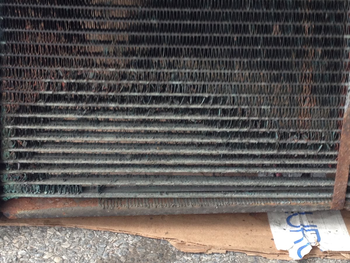

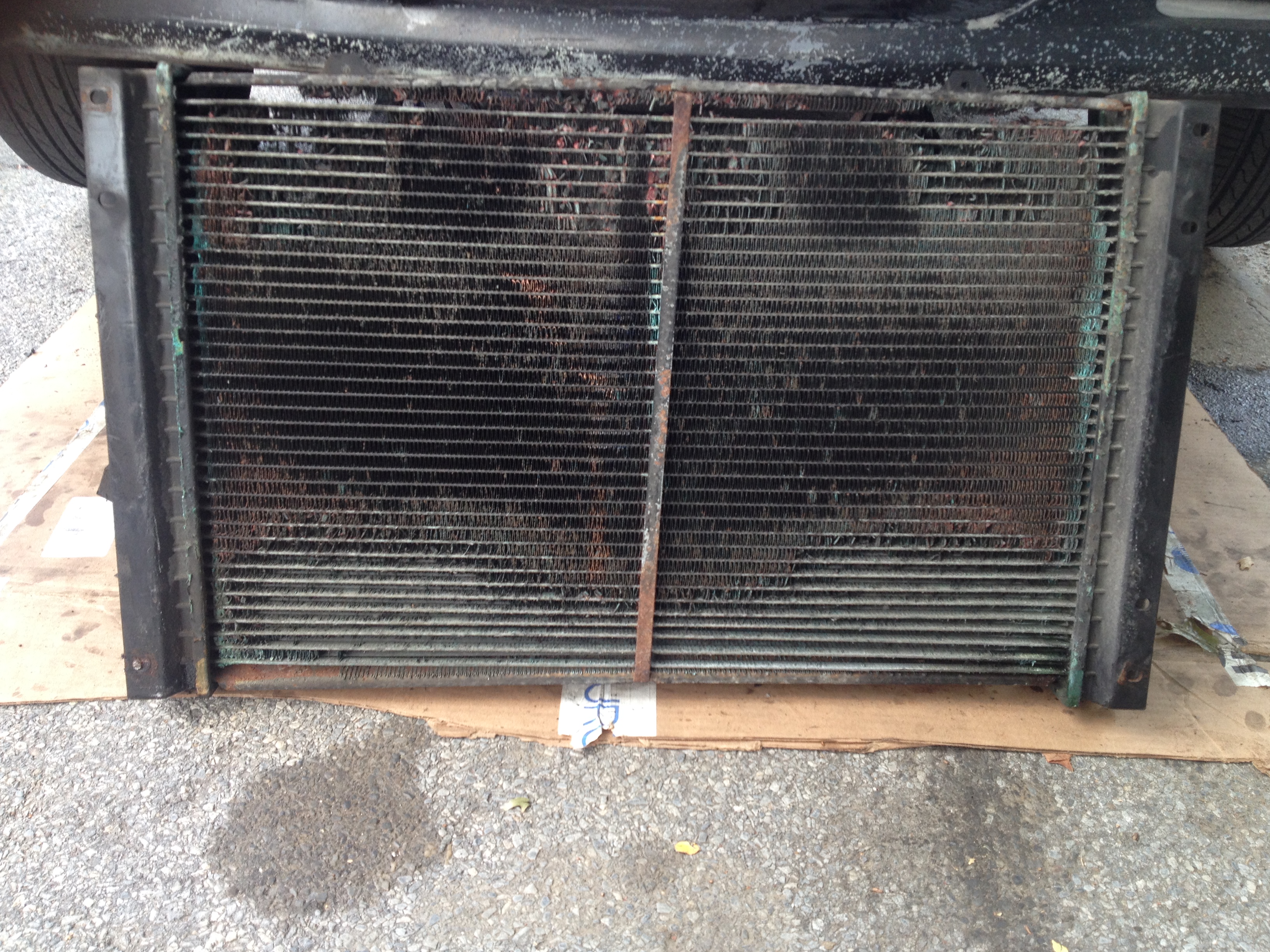

here is a pic of the green apple martini seeping ....because we all like pics..right?
Jazzop> PM sent

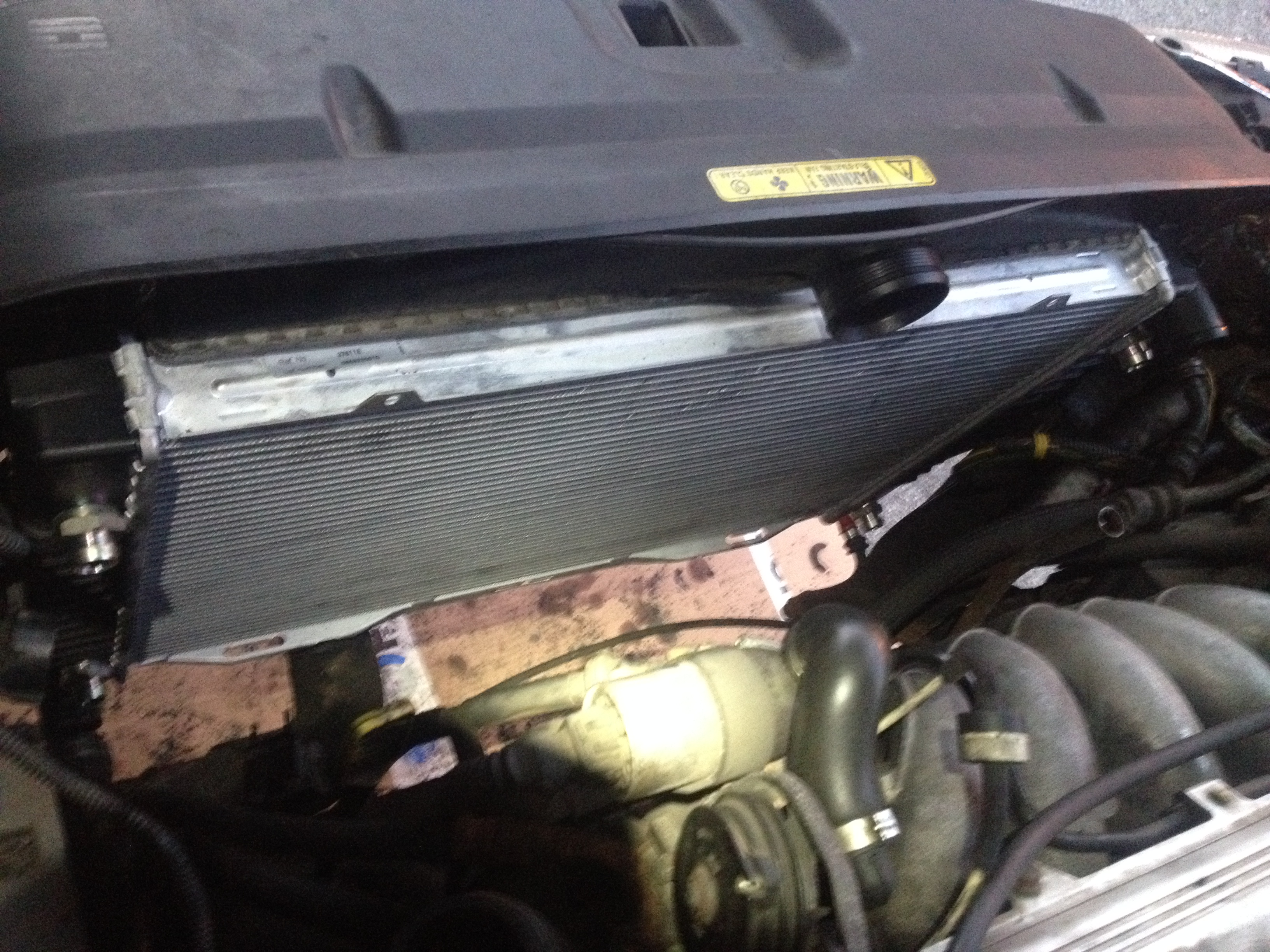

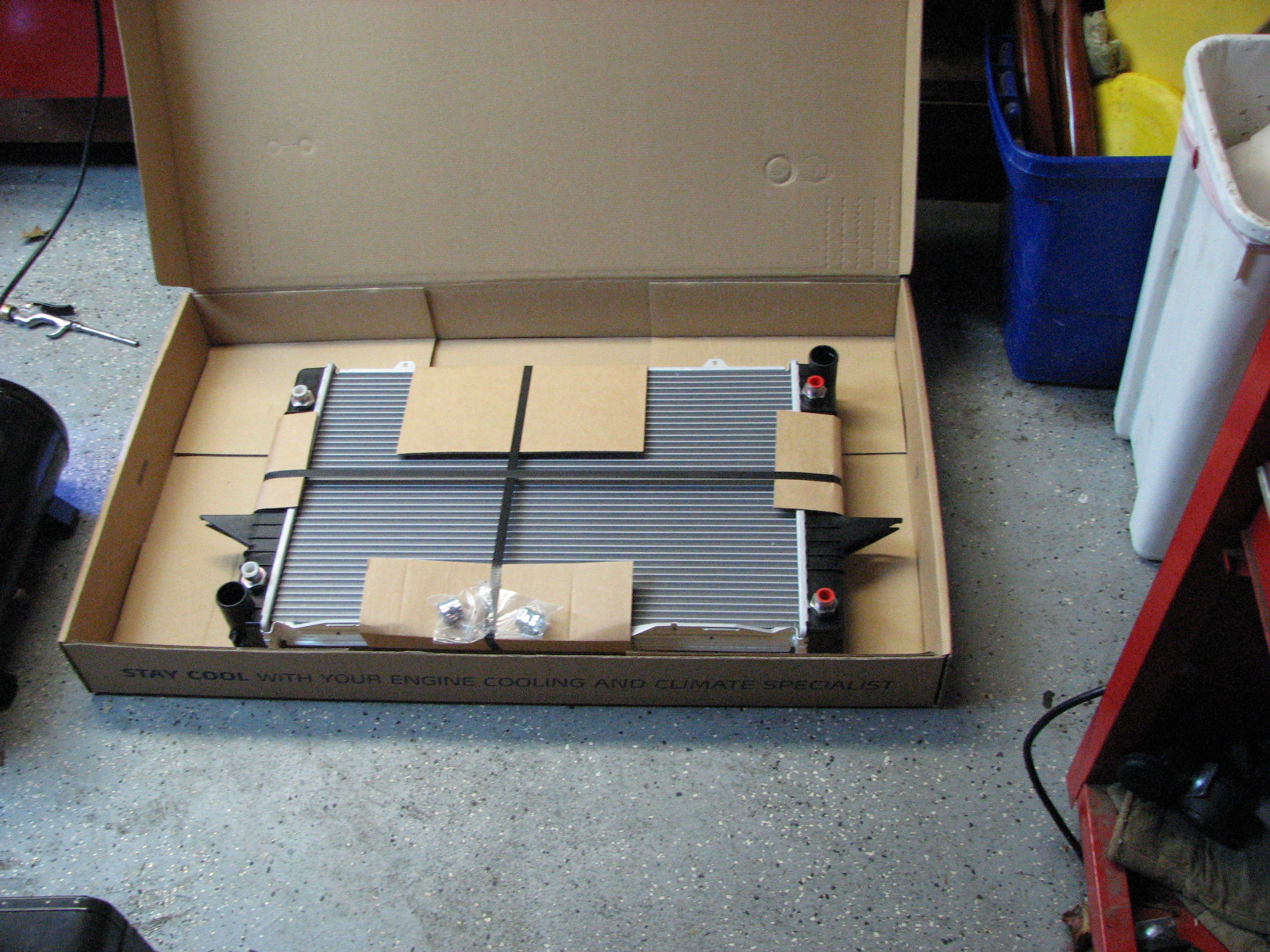

So I installed the NIssens today. FCP is lightening fast Here. Ordered saturday got it wednesday with standard shipping. Sweet!
Thought I would post a few pics and thoughts.
Everything went fine except that ALL the bolts holding radiator were so rusted I had to replace them.
Proabably tripled the time spent.
The clips on radiator shattered when I tried to remove the screws.
Lowe's has some 1/4" clips that worked very well in the "Auto" nuts and bolts. But be sure you get the right thread on the 1/4" bolt !.....or you will have to go BACK to Lowe's
ALSO: the Main bolts that attach radiator to car frame were so rusted they broke off the nut which was attached to car frame. This was even after much PB blasting. I would PB. let it sit. turn a few times. Then repeat for 40 minutes or so ...and they still broke off. I had to break the plastic flang/mount on the old radiator, and hack saw the nut to get it out. Then put new nuts and bolts in. Just a head's up to anyone who may be doing this on an old car like mine.
This is probably all addressed somewhere on the forum here, but I didn't see it.
