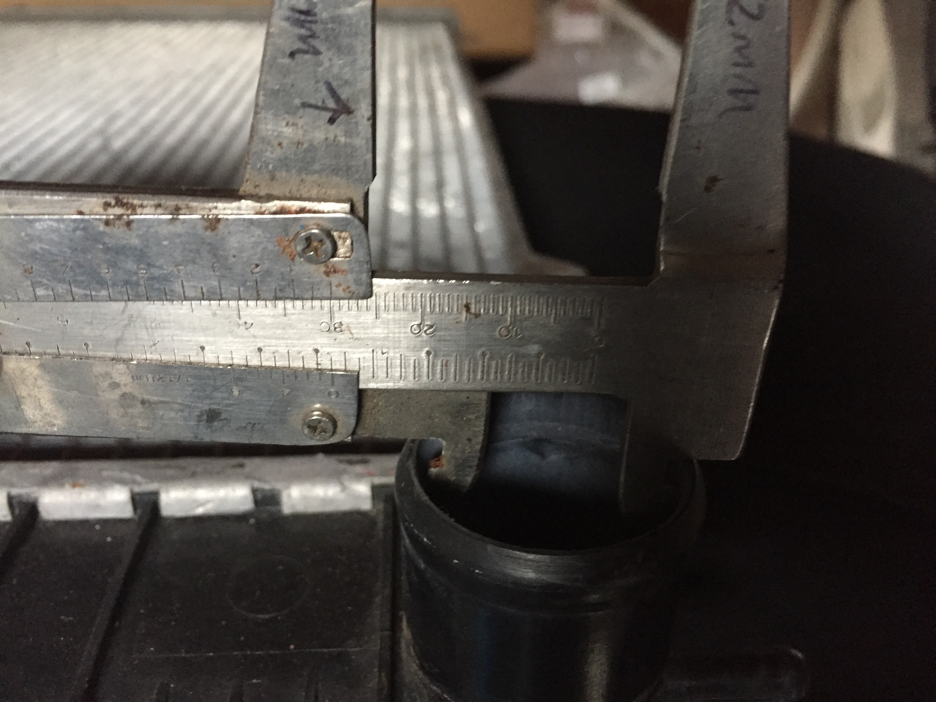

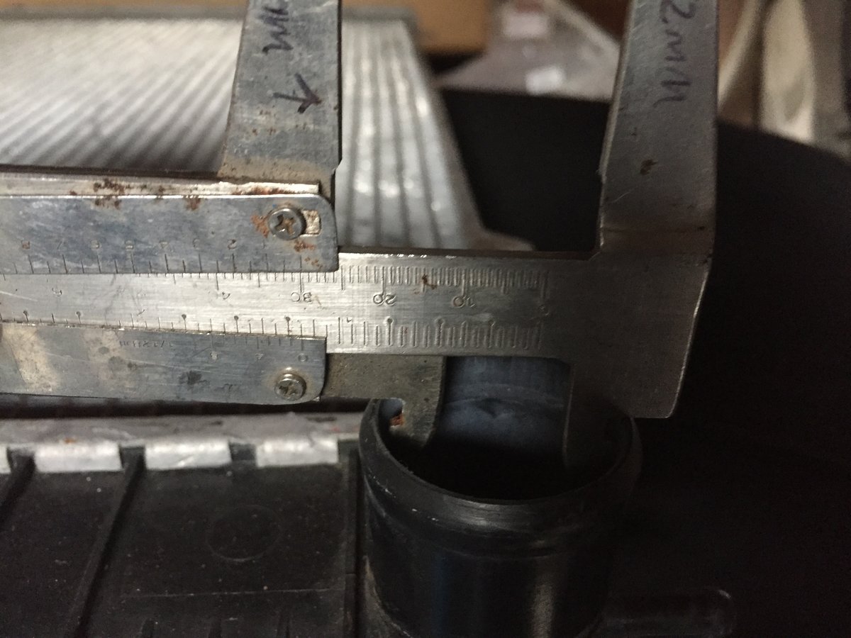

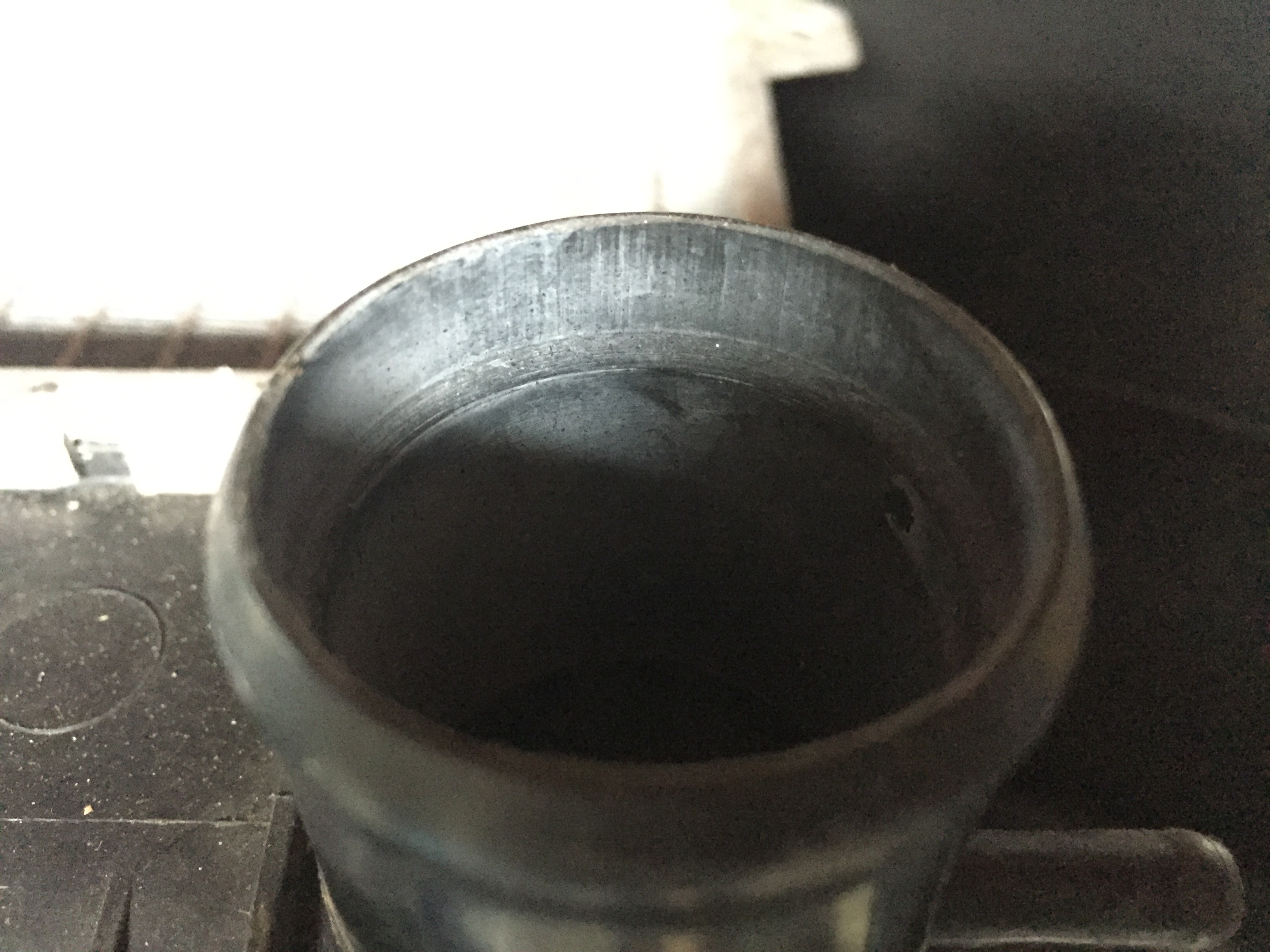

I measured the inside snout on the Nissens to see if I can find a metal reinforcement sleeve for the cheaper aftermarket
It measures30 mm or 1 3/16 inch ID. Be careful not to measure the slightly wider piece to the rear.
Behr $100
Nissens. $125
Valeo $300...this is OEM Volvo and has the sleeves included.

tardcart wrote: 31 Mar 2019, 15:19 thats the size of a I" copper pipe. but maby reducing the flow to one inch is too little. are you trying to keep if from cracking?
We have had mostly side tank failures but a few radiator hose snout Snap offs
