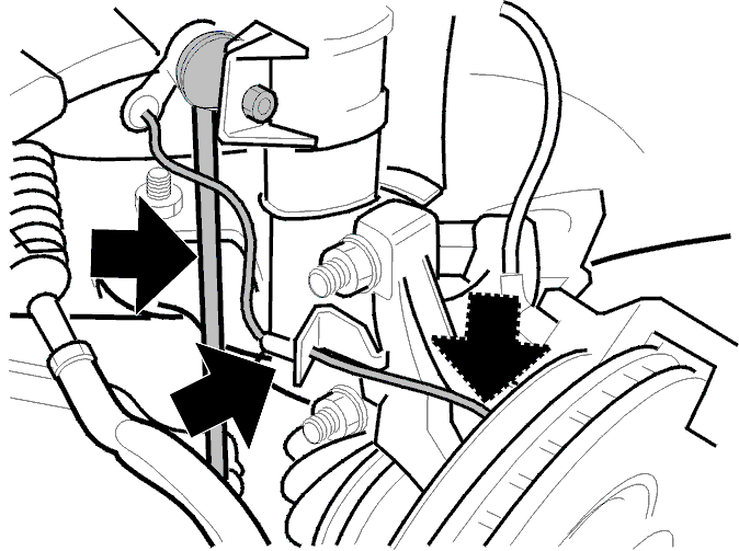

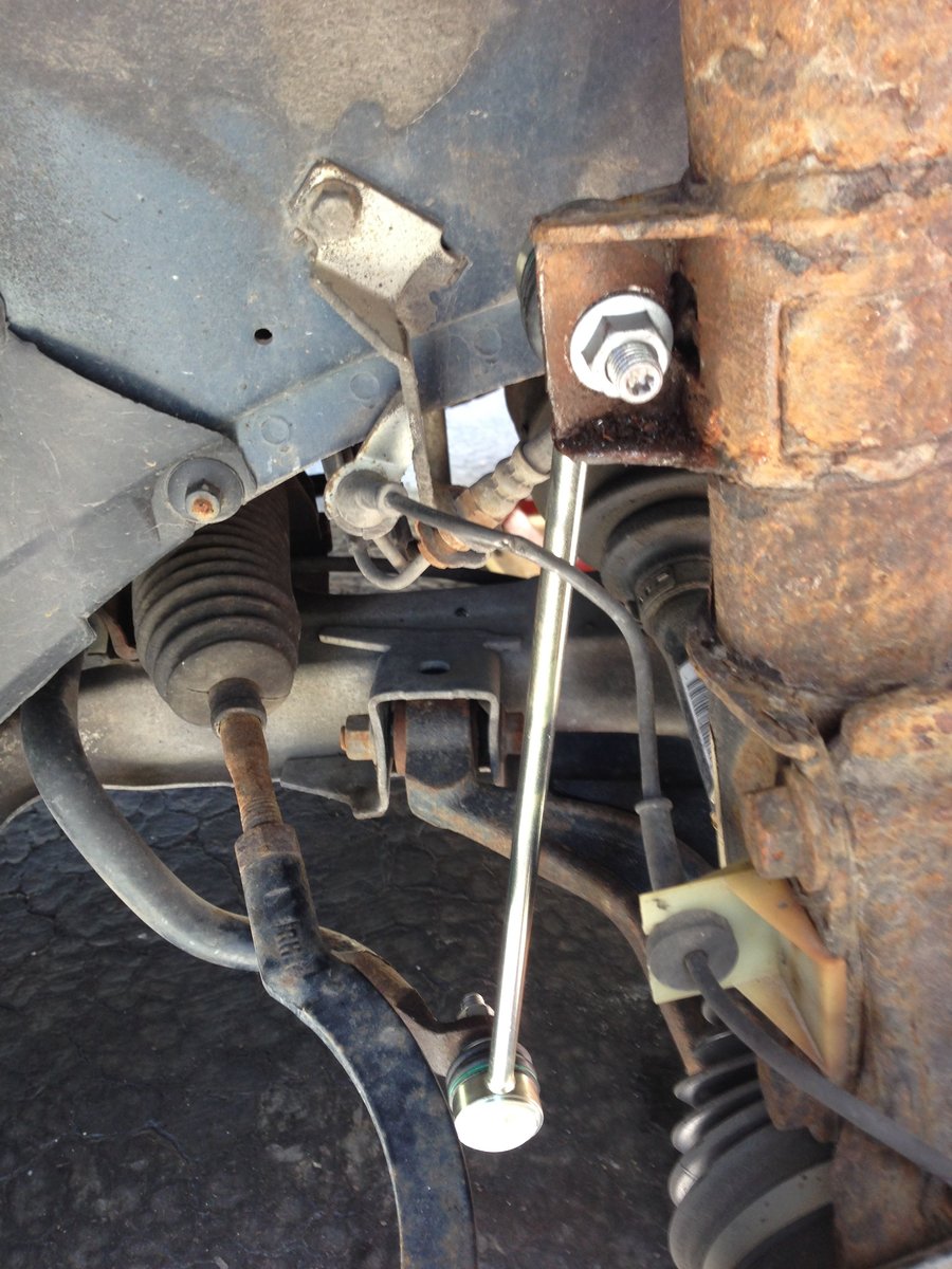

I was looking at the image of the RH side rusty strut assy that you posted; what's up with those strut-to-knuckle bolts - aren't they supposed to be inserted from the front?
AFIK, heads should be facing forward.

Strut to knuckle or control arm-to-subframe?
I did control arms about 5 years ago, I could have got that wrong.
I don't think the knuckles have ever been off this car, TTBOMK

I am referring to the two horizontal bolts that connect the steering knuckle to the strut assembly; is it possible the car came like that?

It is...I can't think of any repair I've done or had done that would entail removing them.

Strut to Knuckle
Strut to Knuckle
This is what VIDA shows and I am positive someone here had pointed it out in a procedure. Other than the picture attached I did not see any specific instructions in VIDA. It may as well not be worth the sweat...
...But could still shift your car's center of gravity! :lol:
Those bolts are so seriously torqued (TTY) so I don't think they will ever try to go anywhere.
