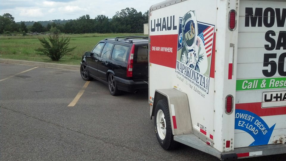

Yes I made it home yesterday. The trip from Oklahoma to New Mexico was about 600 miles. The car ran pretty warm the entire time. It was running at about 216 degrees and when up to about 224 while climbing hills. Once or twice it got as warm as 242. I think I peaked at about 7,000 feet. My guess is that I am at about 25% coolant 75% water mix. The temperature was about 97 degrees and I was boosting a lot pulling the 5x8 enclosed U-Haul trailer.

Yes, I had to swap that pump out in the parking lot with a trailer hooked up to the car. You can't drop those trailers until they are empty.
