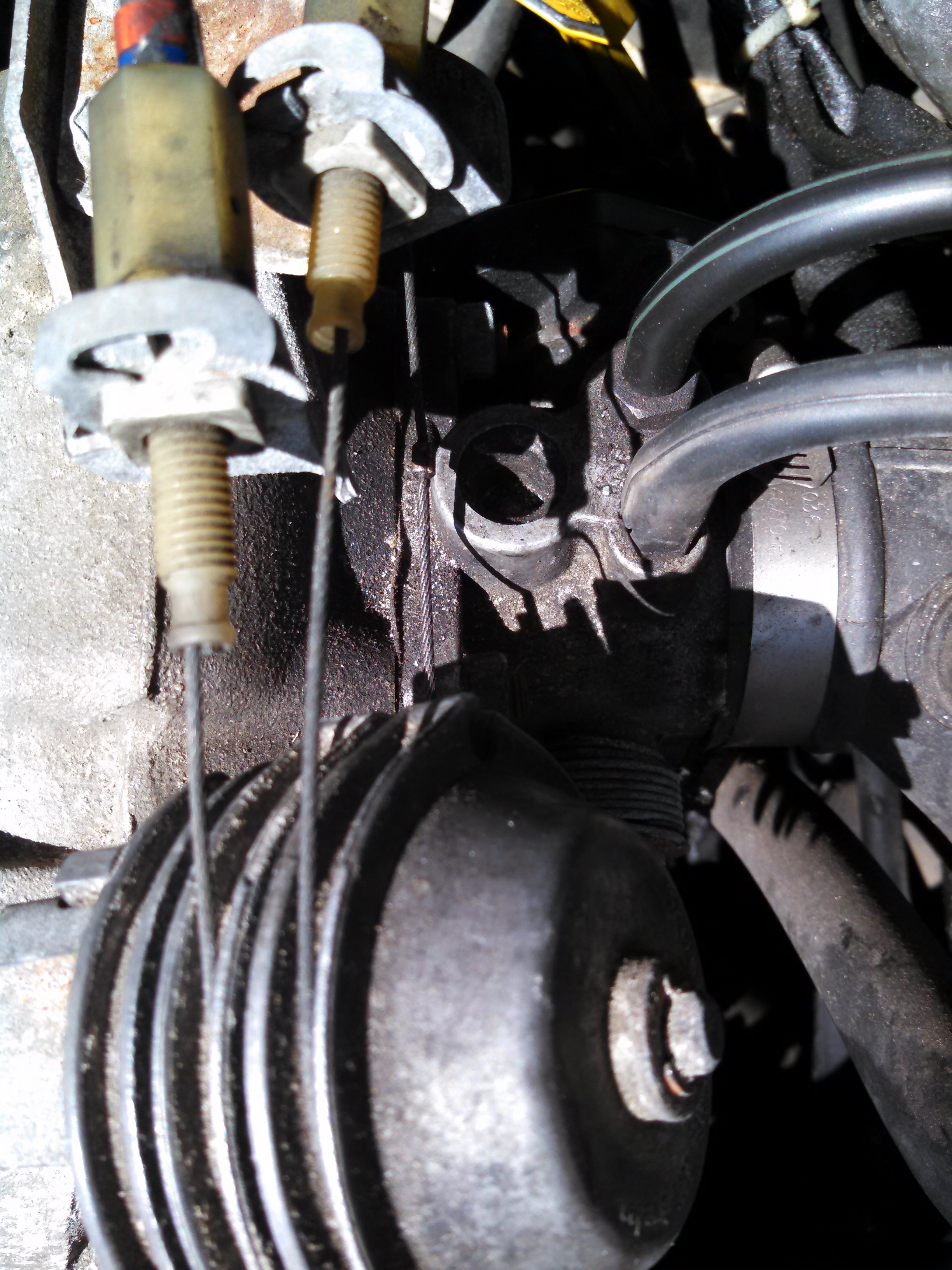

I'm going to replace the motor mounts and trans mount first and see if the issue persists. Then I will have to wire a switch in temporarily until I can figure out a more permanent fix. On a side note I tried adjusting my kickdown cable and really don't have much slack before I here the click and it stops moving here is a picture. Any tips?
*Edit* OK I detached the kickdown cable and it seems shift fine now so I'm guessing either its messed up inside (got a new cable otw from ipd) or I just suck at adjusting it. I'll keep tinkering with it.
