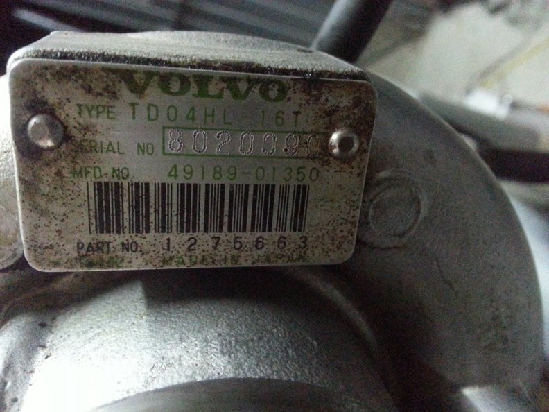

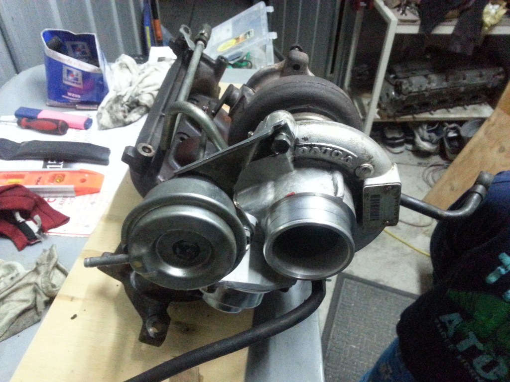

They gave me a nice tight turbo with no axial play
Car has all new genuine water hoses including turbo lines. Also leads are dated 2009 and cap is new. I'm going to replace the banjo bolt copper washers as well. Brakes including all discs are new!!
Ordered a genuine PCV set (PCV box and main lines but left out clamps), timing gear and head gasket set. There are 14 valves that are straight lying in a foam box; the bent ones were turfed. Reason for belt breakage is a near-seized idler pulley and tensioner pulley.
This is going forward on a very tight budget. So far am $350 into this. Have 20 stem seals and all cam seals still in packaging from a previous job. Also found a near new GMB water pump I found on eBay afew years ago.

Does anyone know what the order of re assembly is on a turbo engine?
Do I fit the head with the exhaust manifold bolted on then try and fit the turbo or can I squeeze head, manifold and turbo in one go??

You can do it either way. I usually install the head alone, it is much lighter that way and you can do it alone.
