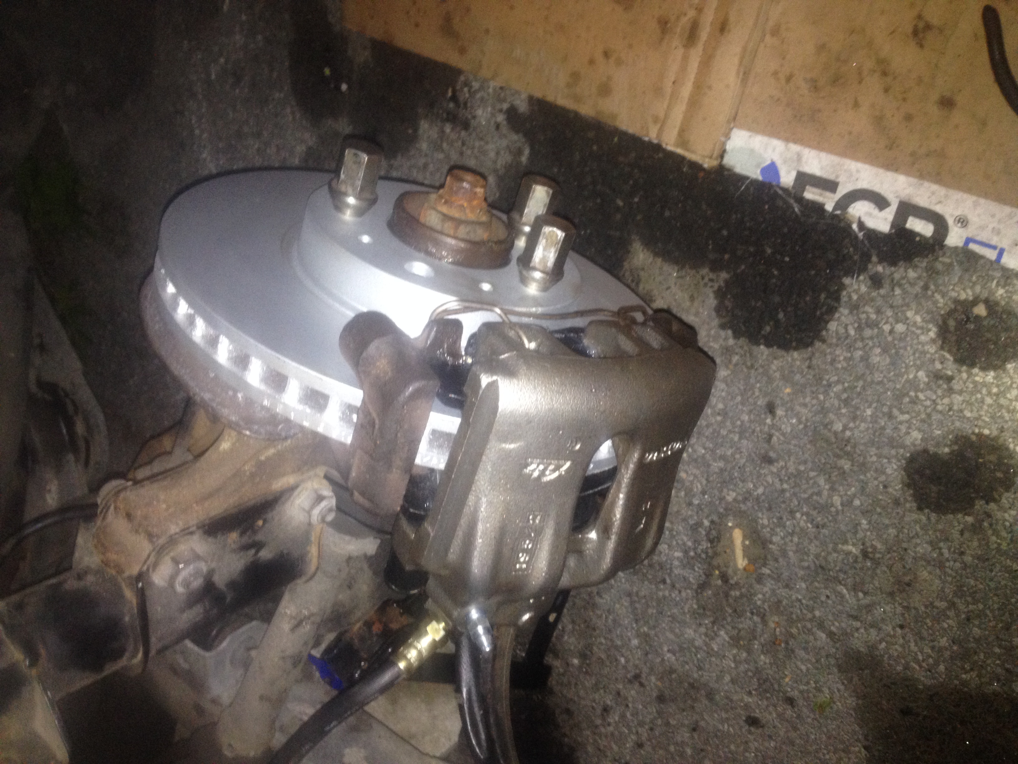

thanks lee....love that video. may run to harbor freight again for pump...though everything I get from them seems to break even before the ONE job I bought it for is done.
I was able to get the right side back together last night. for the hose..heated it waited about 20 minutes while I went to get a better pair of vice grips. Heated again. ... with vice grips as tight as I could around copper. Box end wrench on hose=end after I slipped it up the cut end of hose. finally it broke free.
was able to get right side back together with new rotors and pads.....looks so much healthier. While this was an unexpected $$ and ruined my holiday outing. I will have much more peace of mind knowing this stuff is all new.
today...the left.
fyi got my calipers from pep boys...luckily they had 1 right & one left. I decided to just do both sides since they are so old. They are indeed volvo.
DML nice tip...thanks will use it. I also got new bleeders to install.
Any tips on getting the broken bleeder out? I am going to heat it then gently try an extractor. If it looks like it is going to make trouble I'll stop . At the moment I don't have time to take caliper off.
Thanks guys for responding so quickly ....especially it being a BBQ kind of weekend and all.

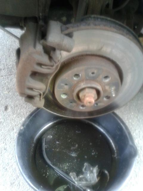

98 v70GLT Front Caliper toast? Leak when depressing...

Yeah, I read the reviews on HF flare nut wrenches and avoided. I got the set from Lowe's and they are thick with good contact on the nut. Before starting, I also bought the Vise-Grip tool from Amazon as a back up in case it was needed. Did not have to use it, but could see how it would be the last ditch answer to keep from destroying the fitting. We don't have the corrosion issues down here like the Northeast, but the fittings were still very tight. Good luck--Hope the wrenches do it for you.TRuck wrote:@ maggow: i am now in same boat as you. got hoses and calipers....but to get the hose off the brass cuppling..ugh..got some flare wrenches from harbor freight...they suck. going now to get better ones from lowe's....pblasted the bi-jeezus out of it....heated it....no luck. just trying not to completely round off the pieces.
what a drag.
page two of this great write up has a tool. going to see if lowe's or the depot has something like it.
https://www.matthewsvolvosite.com/forums ... 1&start=42
On edit: Sounds like you were writing just ahead of me. Nice going--good luck on the other side.

I had a front caliper soft line snap on me during this past winter and a hell of a time removing to replace. The brass flare nuts wouldn't turn using my Mac Tools flare wrench, I basically rounded the edges trying to use something else. Anyway I just cut the hard line a little bit before it meets the soft line and I just made a new hard line.rmmagow wrote:I feel for you, I'm jammed up brake-wise this weekend too. The caliper is toast. The seal kits are more work than they are worth. A rebuilt caliper from AZ or NAPA or Advanced auto parts would work fine. I've used duralast before, they're OK. Rebuilt is rebuilt and probably all from just a couple of main line rebuilders. Price is good, warranty is good. Make sure you have good flare wrenches for removing the line. Buy a set at AZ if needed. The rebuild kits really need to have a clean piston and in my limited experience, just plain not worth the effort. Speaking from experience, check your brake hoses. I stuck trying to get them off my car as I type here. Good luck.

left line was no problem. heated/cooled, heated again...it came right apart. so, put it all back together and tried to flush/bleed entire system (with exception of left rear. bleeder valve is broken) with my BRAND NEW harbor freight bleeder.
went through a quart of brake fluid and then some. drove it around the block and I basically got no brakes. pedal to the floor.
HOWEVER, the metal grinding sound, shutter is gone. Not sure what I am doing wrong with bleeding the bleedin' brakes. I know this is not complicated...i've done much more complicated things on the car...timing belt...etc...but for some reason can't get this step right. I understand how it is supposed to work, but...
I think I will take it to a garage near by that has a good rep just to be safe and be sure it is done right. I hate to admit defeat on such a simple problem, and wouldn't...but this ````is kinda important.
got it all back together.

You have to bleed the entire system, that snapped off bleeder is doing you in. The air in that caliper is just being compressed instead of pushing fluid out your other calipers. You need to get that bleeder or caliper replaced and then it will bleed fine
