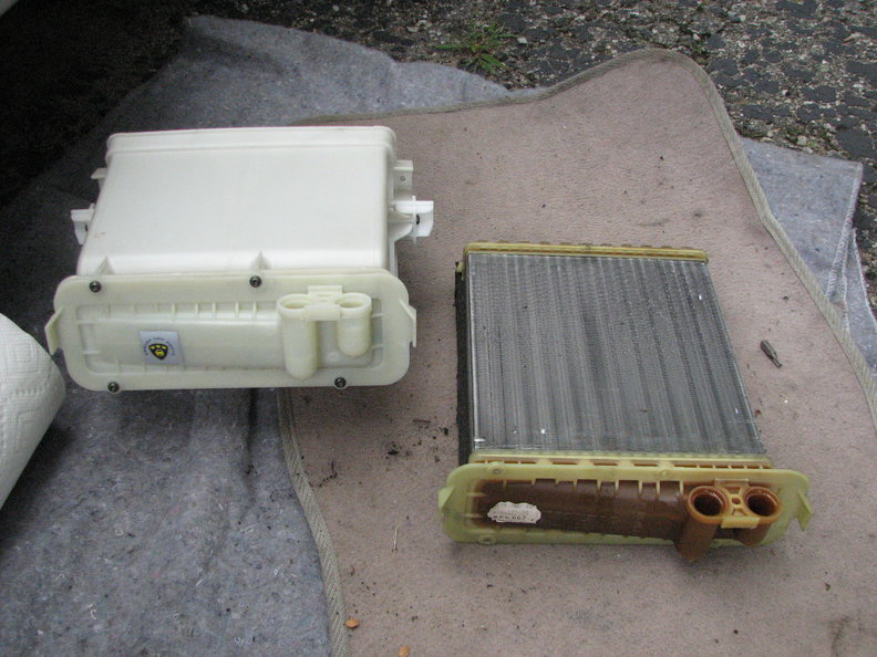

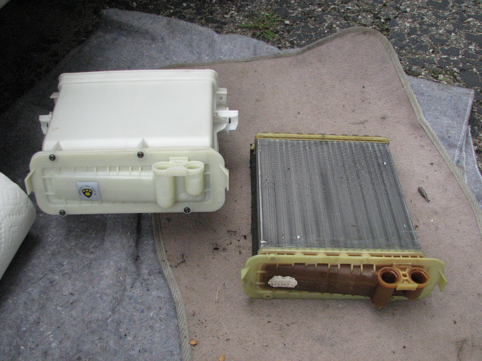

Ben, looking at your pic of the new core helps determine the circulation. Don't know which is inlet or which is outlet, but by their position and the appearance of an internal divider (horizontal light streak), one would conclude the coolant flows up one face of the core and back down the other. Thanks.
