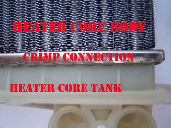

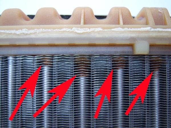

Just installed my ebay heater core on my volvo 850. Now i know some of you are like why would i purchase an ebay heater core. Well let me tell you why, first it's only $38.95, second lifetime warranty, third corrected design to eliminate leak. Thank you IPD for the diy video. DIY caution, use hose cut off clamps to stop the flow of coolant into the heater core. Have a lot of rags under the heater core when you disconnect the hard pipes from the core. Simple install
- Volvo behr design flaw
- image.jpg (110.25 KiB) Viewed 595 times
- New leak free design
- image.jpg (102 KiB) Viewed 595 times
