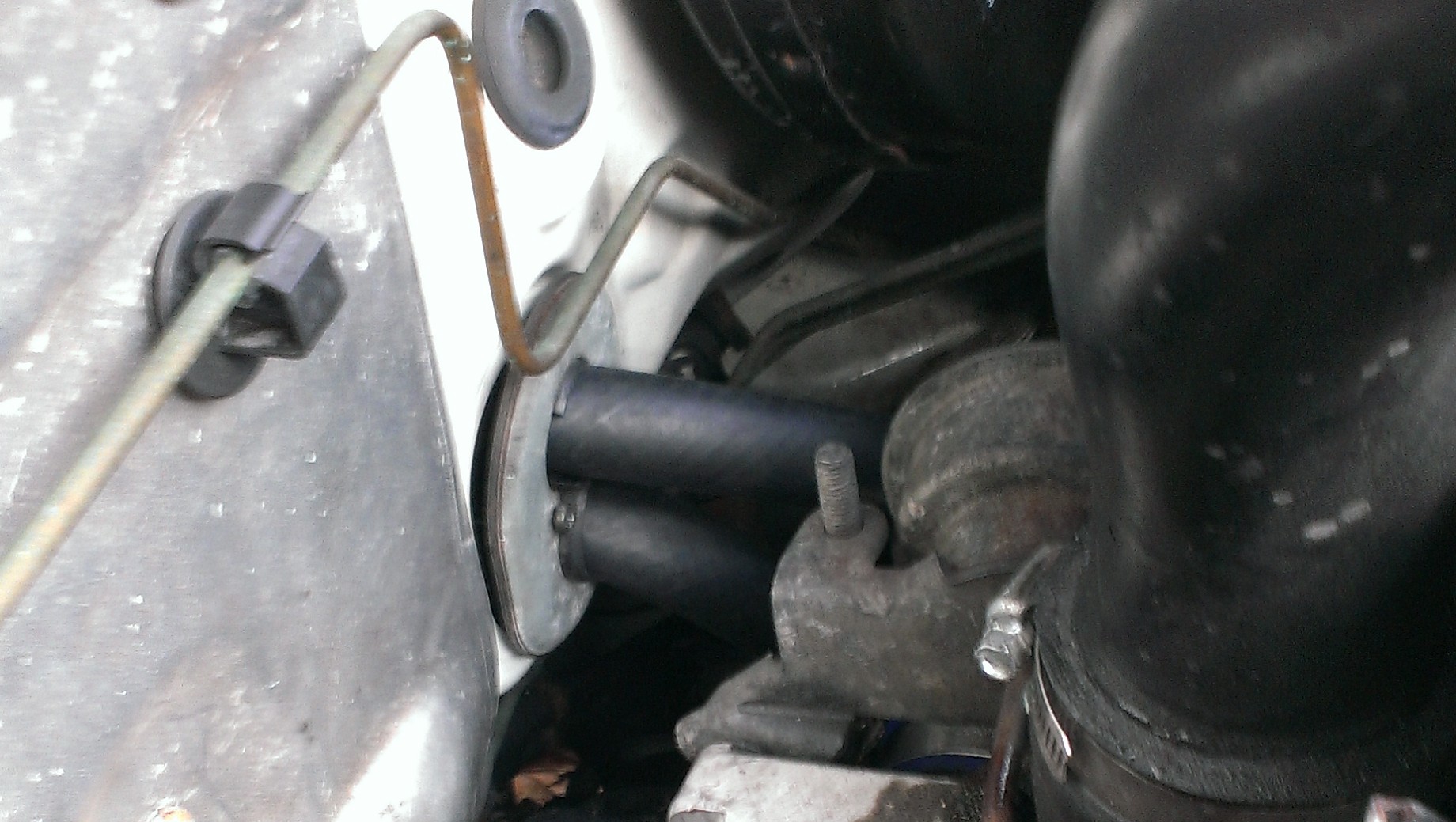

I should clarify: attached is the corner I'm talking about. Sharp corner, rubbing against gutted coupler. A similar thing, less severe, occurs at the other end. A rigid line could be bent to prevent contact with other things in the engine bay.j-dawg wrote:Interesting that this subject comes up now! I've bypassed the heater hose junction box at the firewall, and the hoses from the block to that junction need replacement.
The simplest solution, and what I'll probably go with for now, is to use a barbed 90-degree hose elbow at the firewall. This will relieve contact in the location that most troubles me, and it should be quite reliable. But when life throws me opportunities to buy fun tools, I can't resist.

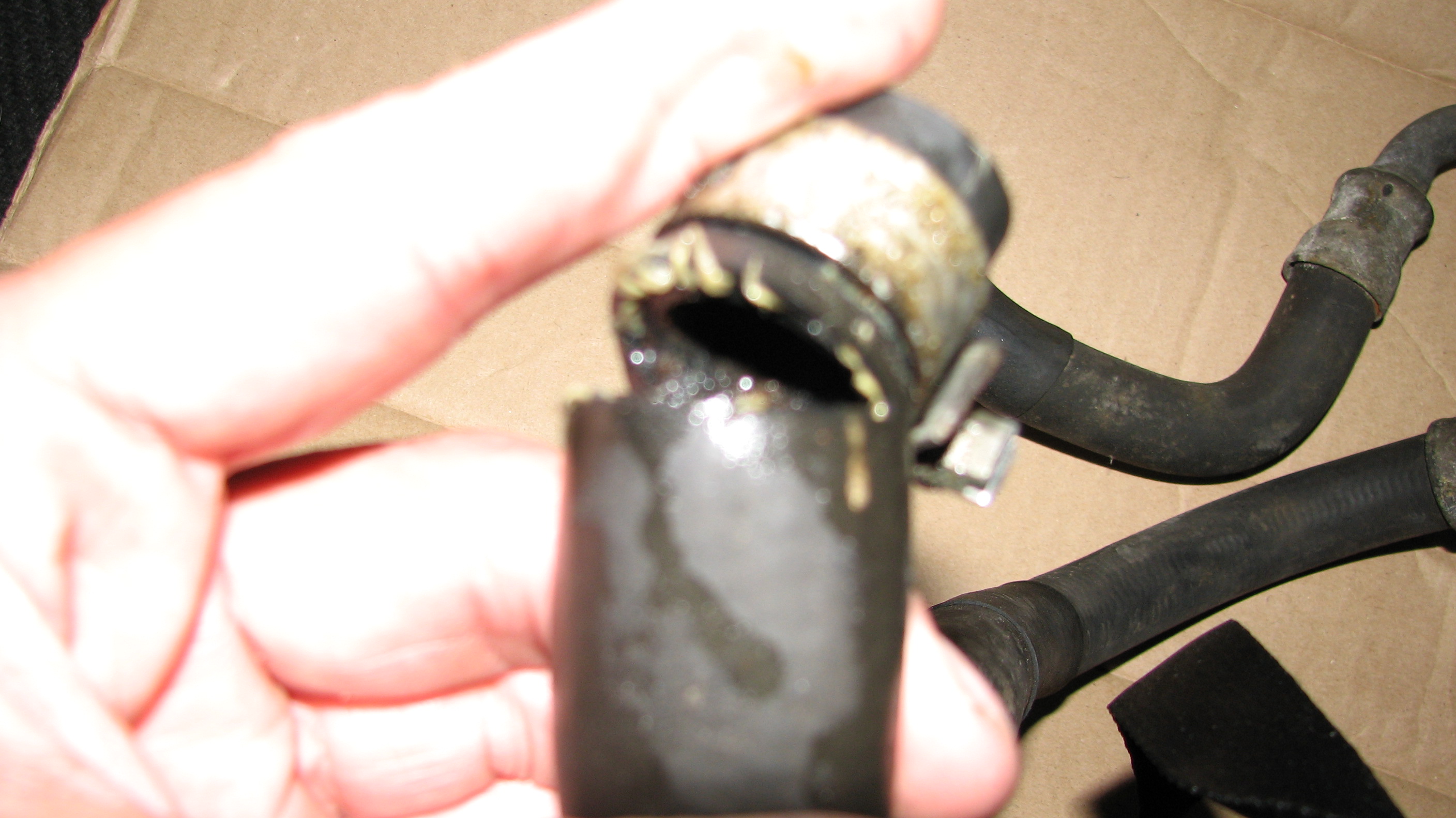

My heater hose broke at the same place, luckily a half mile from home. I had just returned from a 950 mile trip.
I had never noticed that bulge when I was doing all the silicone originally, or I would have taken care of it then.
Mine didn't fail like yours. It Blew.
See the end of this page on this thread.
https://www.matthewsvolvosite.com/forums ... 0&start=42
