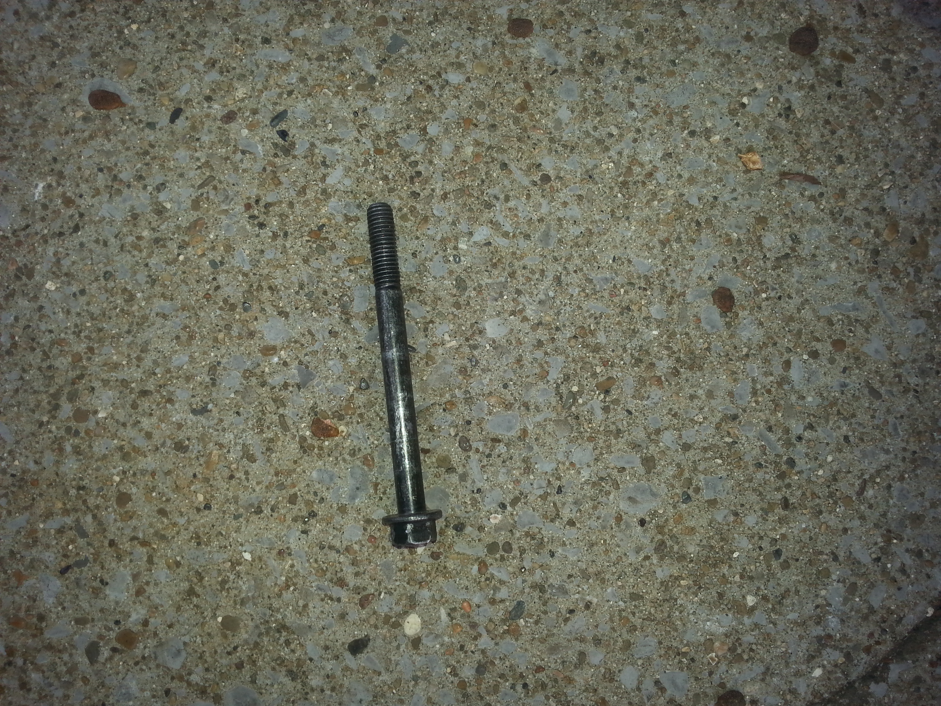

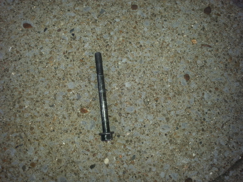

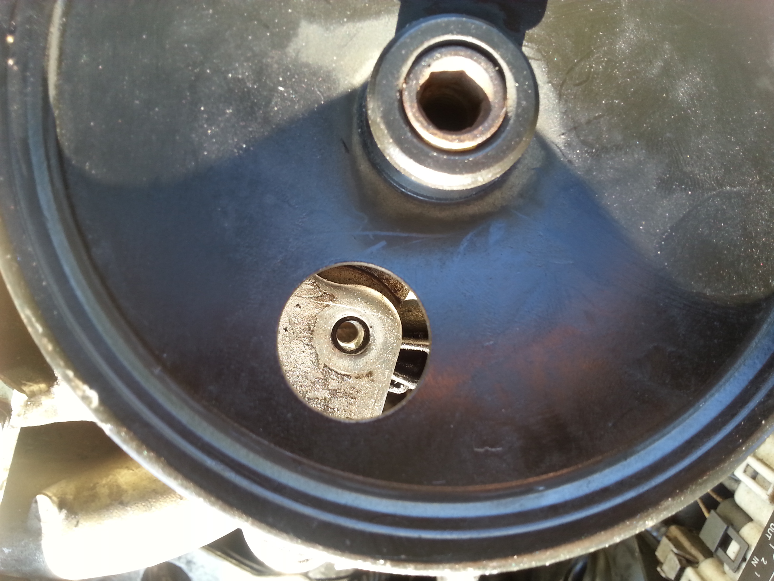

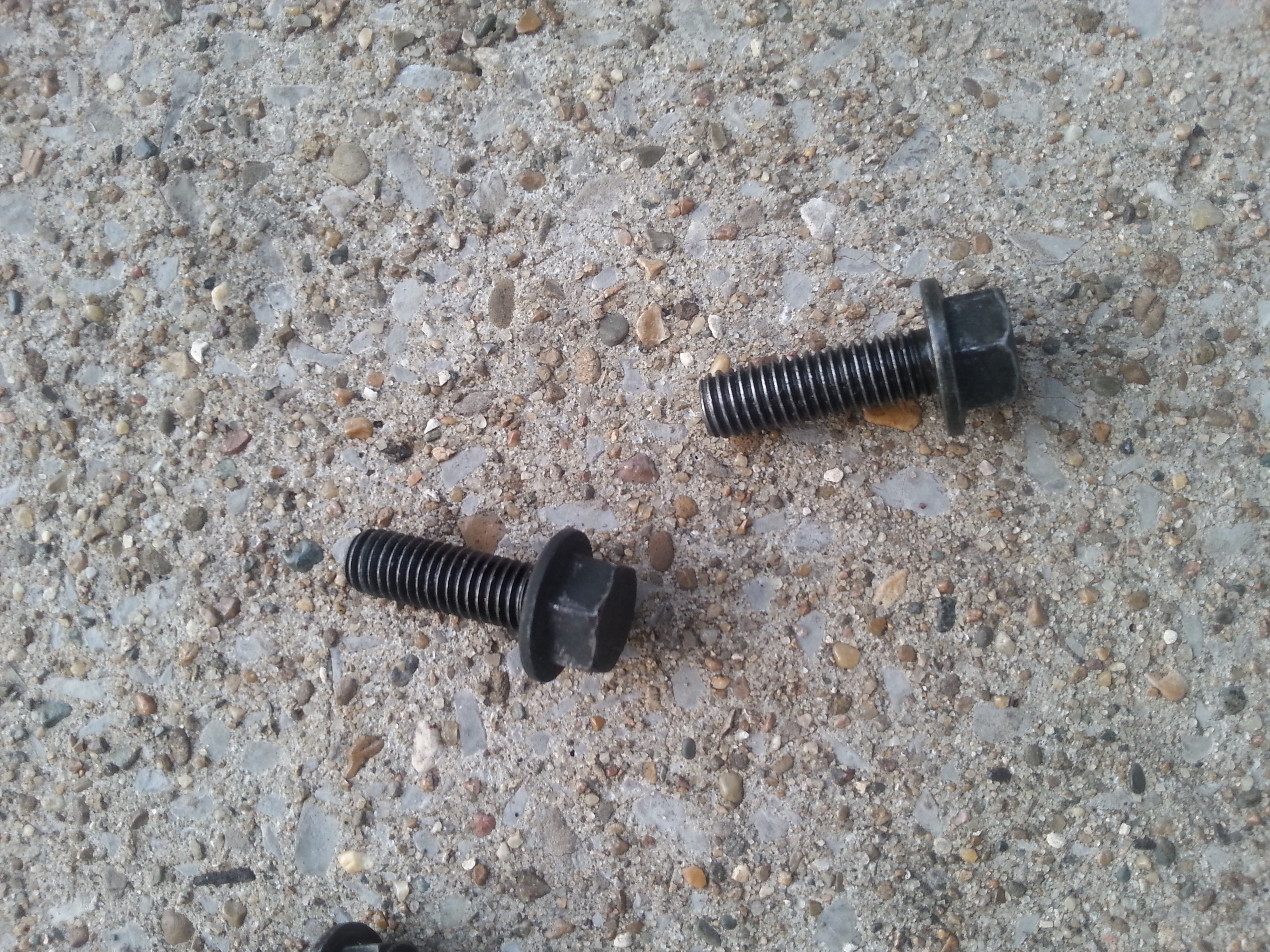

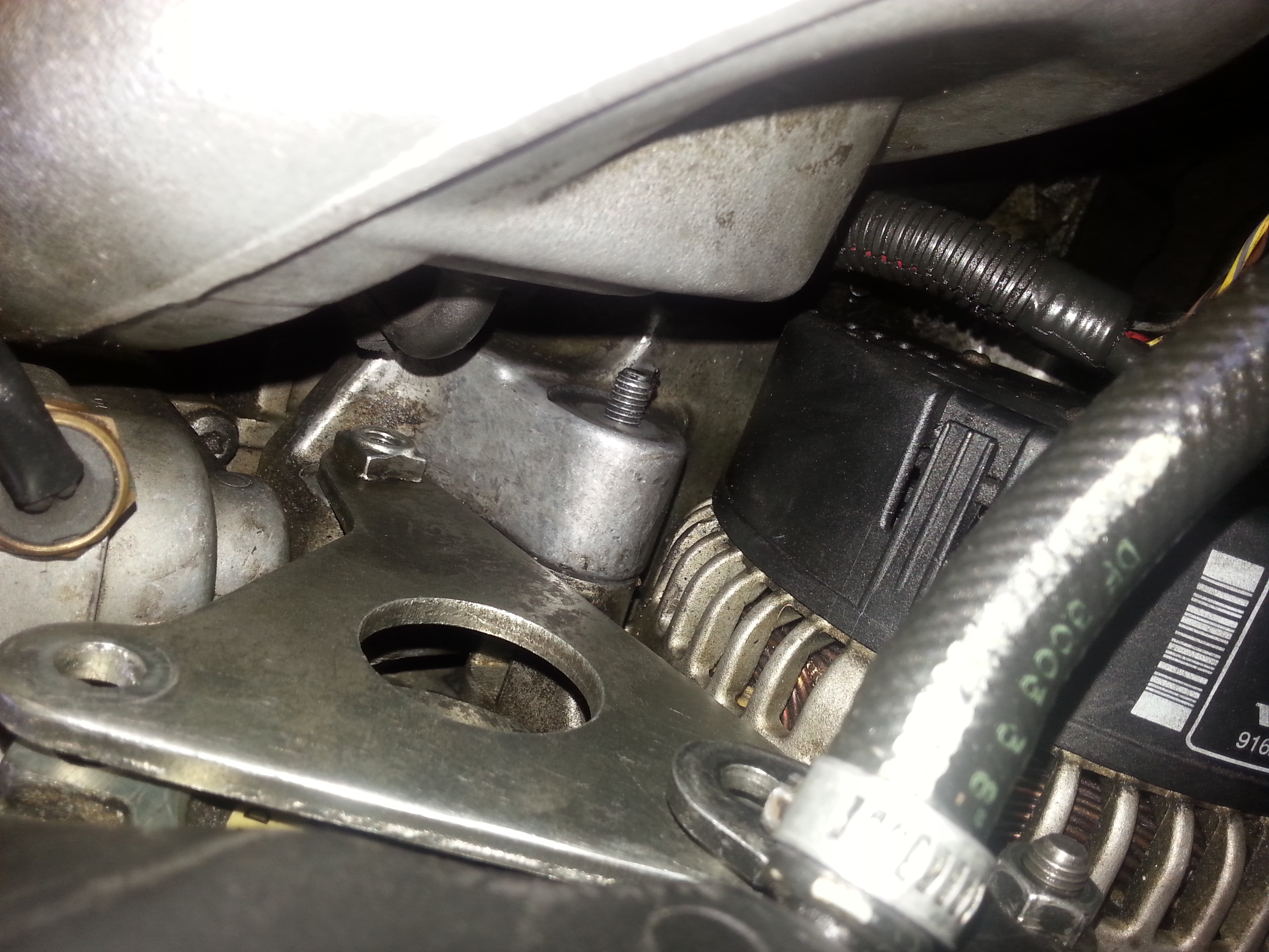

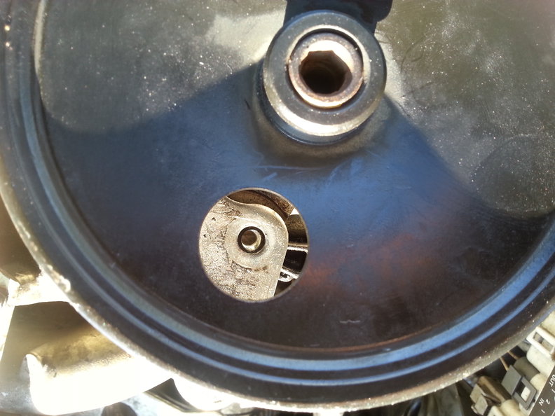

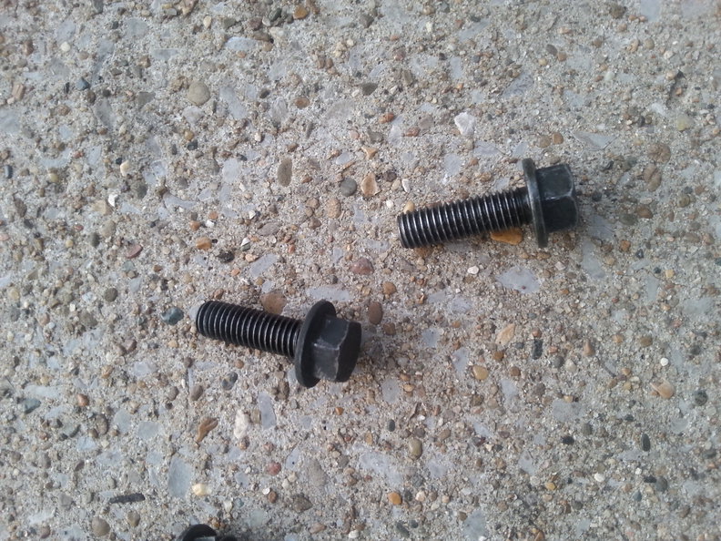

I have a 1998 S70, not the turbo. Long story short, someone else took my alternator, power steering pump, etc. out of my car. They did not keep up with what went were and could not put it back together. I am now trying to put my car back together and have tried every bolt that has come out and none of them fit back in the two places that run through the center of the power steering pump and through silver bracket that goes in the back. I am aware of the size difference of the bolts but being that they were just tossed around I've had to try them all. I'm hoping someone can help me with the bolt placemen.
Thank you
Thank you

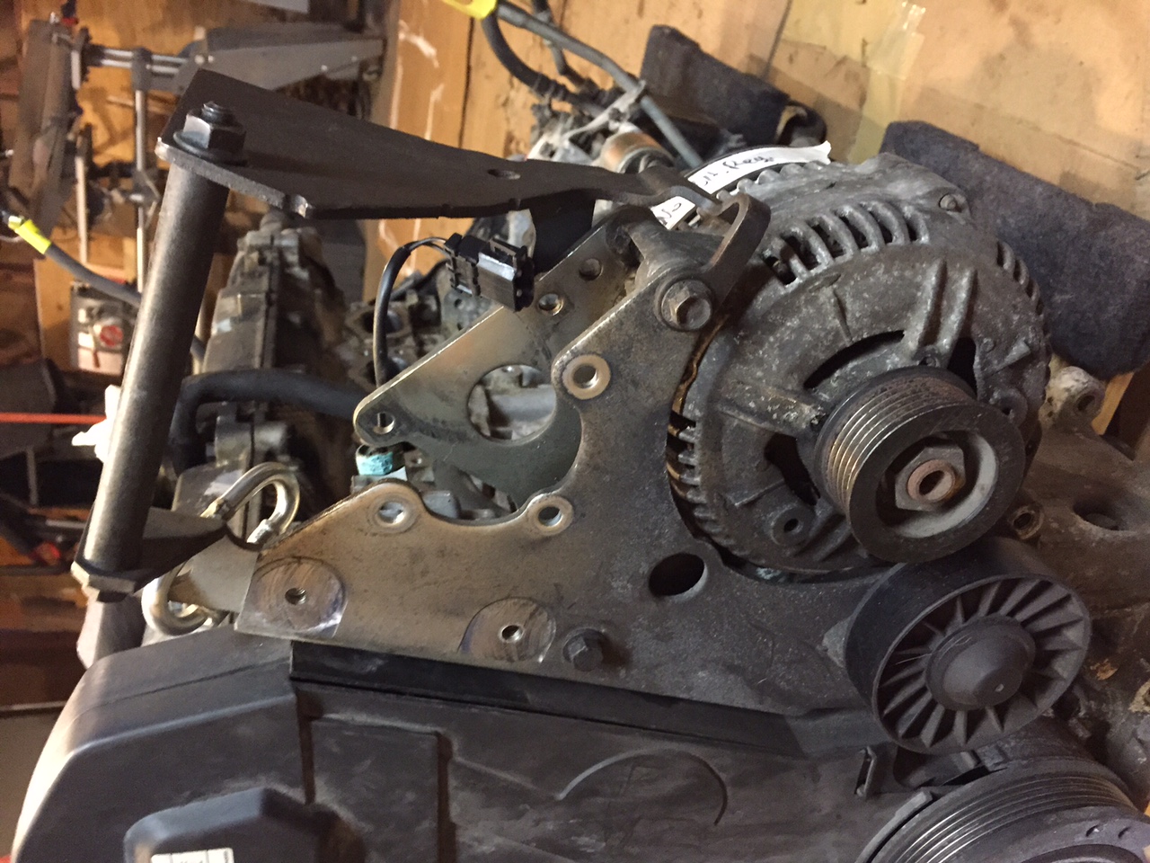

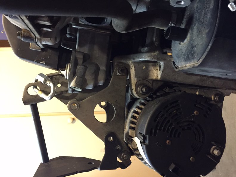

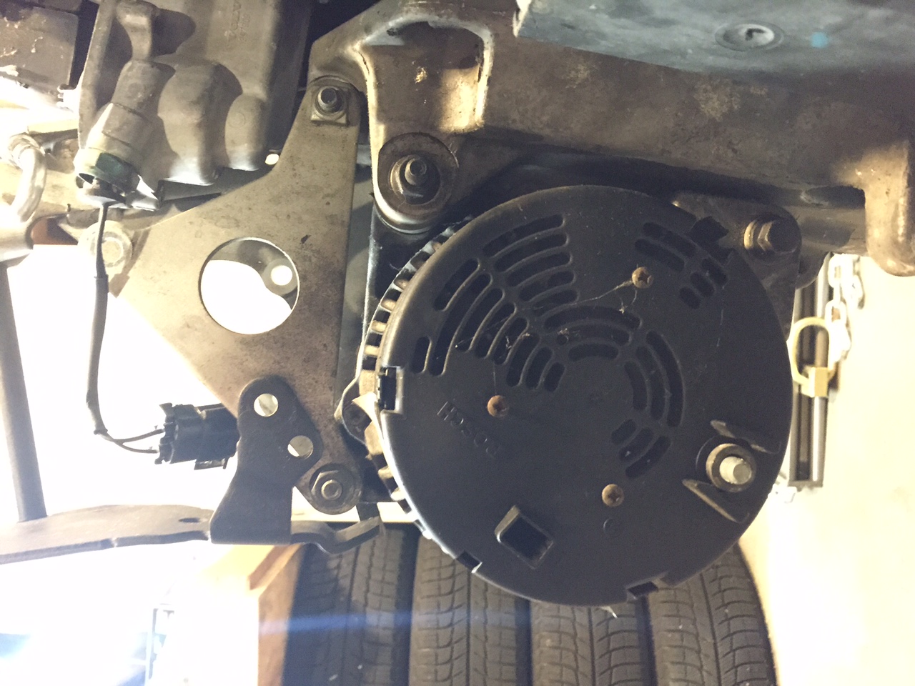

tonie, Here are some pics that should explain it. Let me know if you have questions.
In these pics the PS pump was previously removed, by taking out the 5 small bolts that screw into it. To put yours back in, first get the brackets and the alternator installed and set up to look like this, then you should only have 5 small bolts left, all the same size. Those 5 bolts mount the PS pump.
To install the PS pump you now remove the long bolt with sleeve, re-install it through the PS pump, then put in the 5 short bolts. The 3 bolts from the front you have to get a socket through the holes in the PS pulley, one at a time. The 2 bolts in the back are easier, make sure you also attach the ECT sensor clip to the bolt at 9 o'clock.
Firs put in all of them semi-loose, then tighten them up when you get the pump in place and get all bolts lined up.
MOD REQUEST: please rotate all photos 90 degrees clockwise, they are supposed to be portrait not landscape orientation, somehow the upload rotated them.

I know my other post is long but luckily the pictures contain direct answers to your questions!tonie wrote:@erikv11 thank you for your help!! It looks like I'm almost done if I can get these last two bolts figured out.
First, about the pic where you say "This is the back. right now I have just enough in to hold it in place while I figure out which bolts to use on this part." In your pic I can see the alternator bolt that I talk about in my picture 3, I call it the 2 o'clock bolt, you should look at it. It looks like you used the wrong one you need a slightly longer bolt so that you can put a nut on it. You will also need the nut. Your pic also shows two empty holes in the back of the PS pump, I talk about those in my picture number 2, I call them 9 o'clock and 12 o'clock. Read that pic caption, those holes accept short bolts that screw into the PS pump, bolts that are like like your top picture where you say "and I have this size. Yes I have extra bolts (again long story)"
There are no long bolts through the PS pump from the front to the bracket in the back. The PS pump only accepts short bolts, three from the front and two from the back, my post talks about those five short bolts. So, where you say "Now I'm stuck on this. This is the front, do you know which bolt runs through here to the bracket in the back? There are two of these holes I know they run through to the aligned holes in the bracket" is incorrect. You are referring to two of the three holes I talk about and show in my pic number 1, these holes accept short bolts that go through the front bracket only and screw into the threads on the PS pump.
Good luck, it is a puzzler but you will get it!
